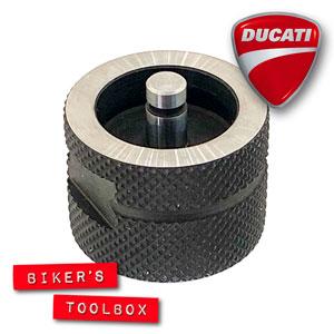

  9. Of no use to you as 7mm valves but here’s a copy of the Ducati tool. Not cheap but cheaper than Ducati oem. Around £50.
  10. Worth every penny if it’s reliable

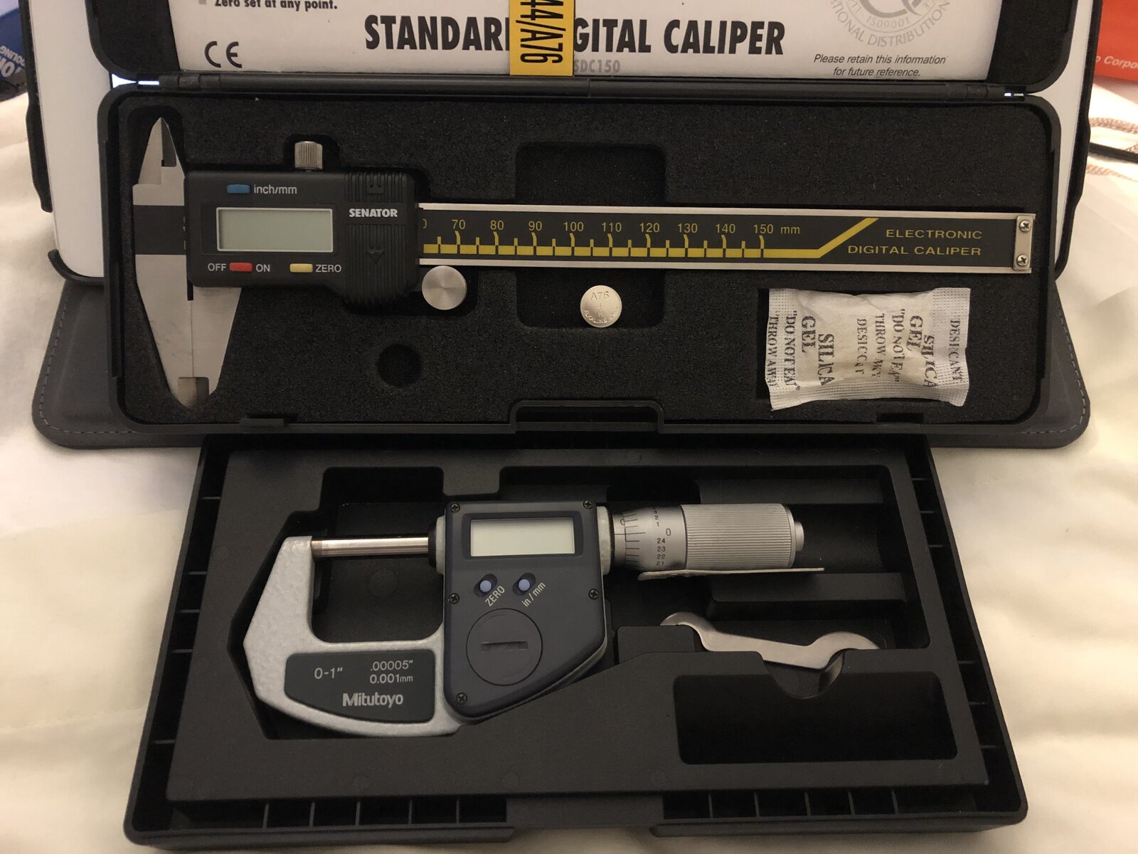

  11. I use this
  12. I agree but need to remember that the tolerance on most verniers even quality 150mm versions for example is +/- 0.02mm hence why I prefer a micrometer which is more precise. So comparison with stamped figure on shim may show a difference. I always calibrate my verniers or micrometer against a precision slip one digit at least better than my measuring device. Personally it’s all relative as long as you’re consistent as the error introduced will be a constant but may differ with what you get from Ducati and the stamp on the side.
  13. I agree. The problem I was having was I tried 3 different tools available on t'internet and they all give different measurements, none of which I would describe as being close to the measurements that were taken with the proper ducati tool and they were also inconsistent. I don't think the cheap tools take into account the radius where the half ring collets sit. I'm tempted to buy an EMS kit with the tool as I know I'll more than likely be tinkering about with these things in the future and it would save a lot of faffing about.

  17. if you think about it you are not interested in accuracy. The two measurements you are after are relative not absolute eg you have measured your clearances and decided a shim needs to be x thou (apologies for the old money) thicker than the one that is already in the machine. Now imagine that you have accidentally zeroed your micrometer when it is actually open say 1.5mm. You measure your original shim and then measure the replacement shim and as long as the replacement measures x thou thicker than the original you are good to go but the quantitive reading on the micrometer will be rubbish.
    Finally, all you need to measure your shims is a micrometer used with care so you can forget all of these special tools and if you insist on a placebo then a roller out of a roller bearing will serve you just as well.
