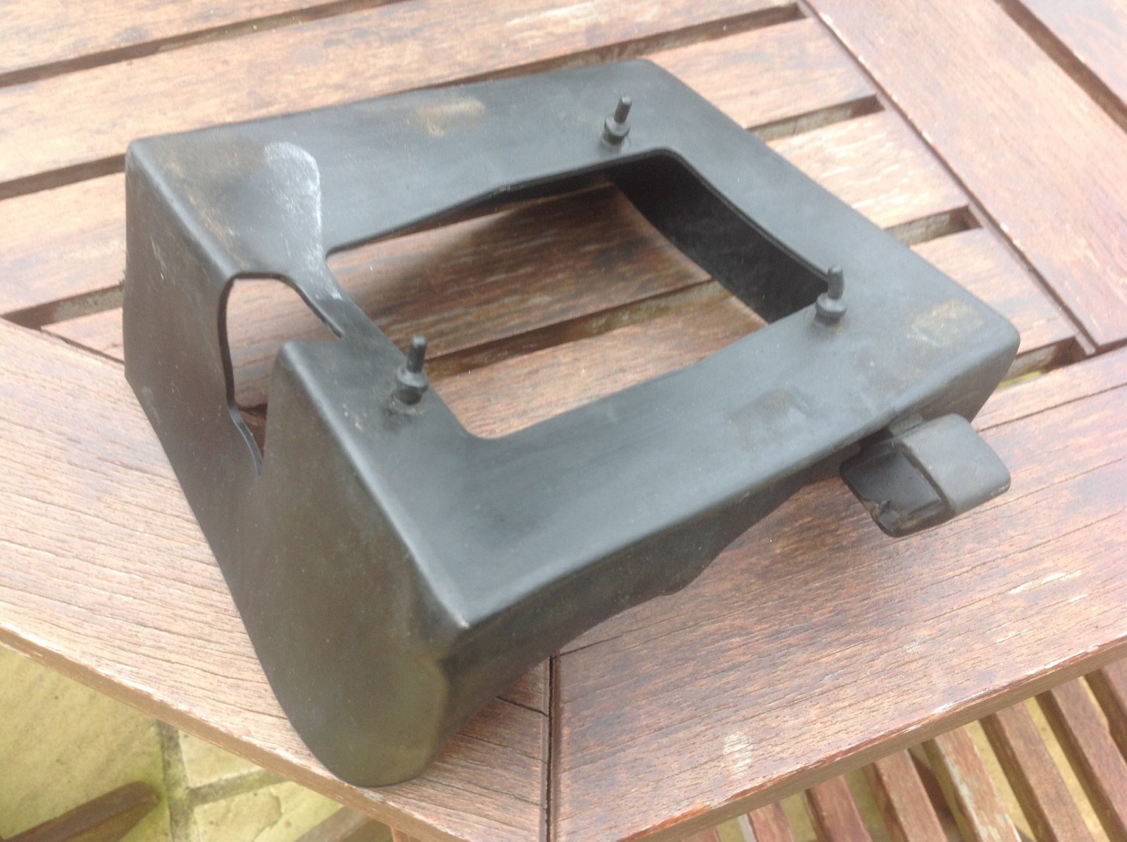

  2. Zombie thread but just to answer that problem, bowl of hot water, loads of washing up liquid, soak rubber insert and put it back on battery.
    More soapy water around battery box.....push ( difficult because it's slippery ) - job done! Dry off residue and connect battery.
  3. I knew there had to be a way...
    I ended up leaving it out because it was getting increasingly distorted and just would not accept the battery without folding.
    One thing though. The insert would appear designed to locate in the battery box first because it has lugs on it that correspond with holes in the battery box and I don't think they would just slip into place. Those lugs are quite lumpy and would stop the battery from sitting properly in the box if they are not first located in their corresponding holes. Will the same method work if you locate the insert properly in the box first and then lube the inside of it and the outside of the battery before trying to shove it into place??
    The lugs are not enormous but enough to stop it fitting really nicely in place.
    I wonder if the answer is to glue the insert into the box so it doesn't just catch, distort and fold when you try to slide the battery in and then lube the inside of the insert and the battery as you describe, so it slides in nicely

  7. Nope I had no such lugs on my rubbery cover.
    I guess a previous owner had nipped them off ( it locates well enough without them ) if fact the cover is a snug fit around the battery - the battery is held firmly by the single "clasp" that you screw in - so I don't see a problem with cutting them off..
    Just to confirm - I put the cover over the battery before inserting the whole thing in , in one go... the soapy water lubed it to perfection to form a snug but easily placeable fit
  8. Yeah, looks like snipping off the lugs is the simple way to do it...
