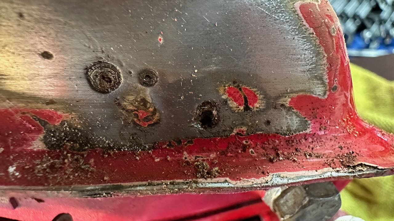

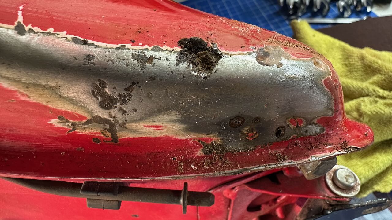

That looks pretty bad to me, poke those scabs in the metal with a screwdriver and I bet they go through especially that dark looking one on the bottom right.
Added petrol and tipped the tank up so the fuel pooled in that corner. After an hour, I dabbed a coloured tissue against the various rust spots, and the tissue came away with marks - subtle. I went at one of the worst culprits with a screwdriver and picked the rust. I eventually got all the way through, it took some time, but not without picking at the POR 15 paint and what looked to be fibre (glass, perhaps?). I think this tank is a write-off
i think its a replacement tank, how long before it leaks elsewhere? can it be repaired or welded with that por|?

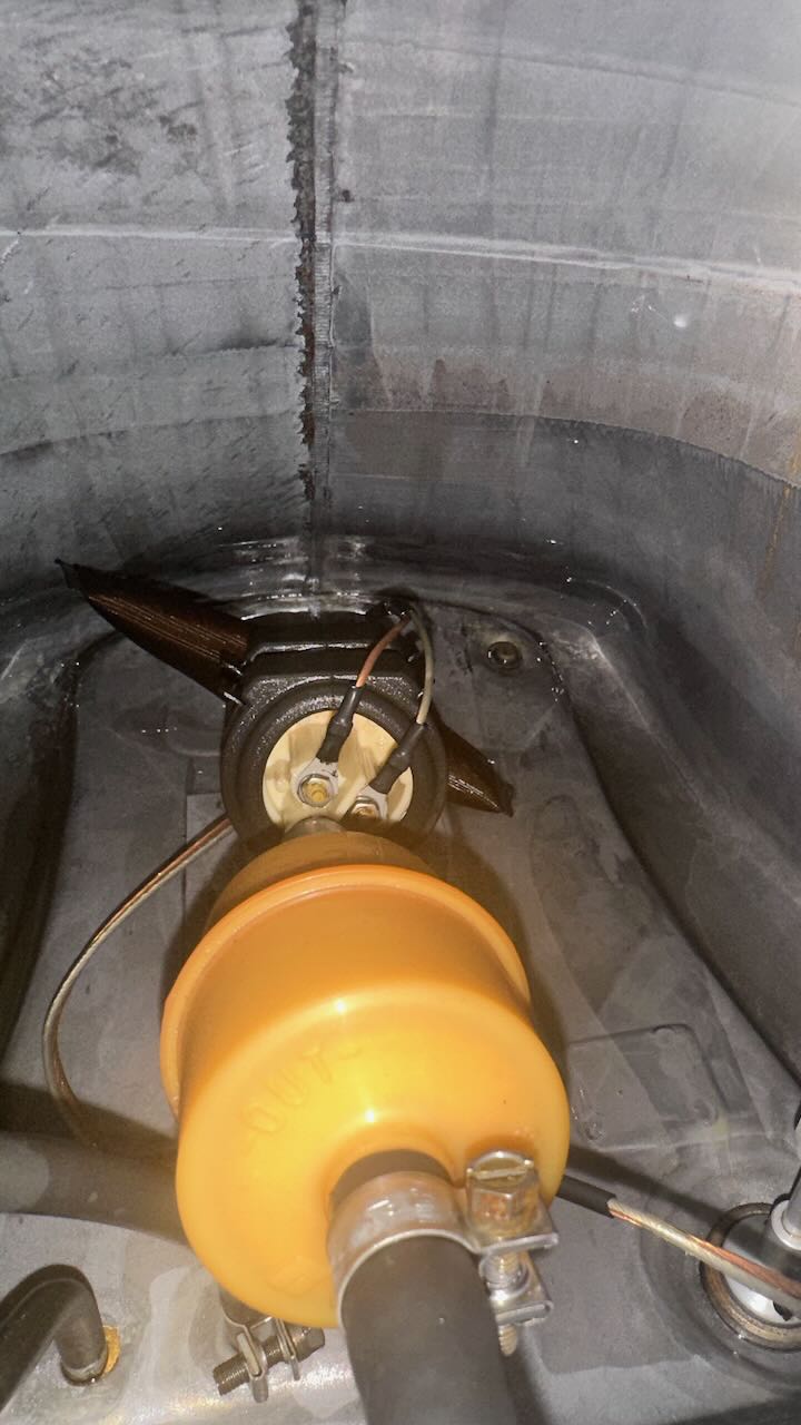

When I bought the bike, the fuel cap rubber seal was a spare part. The previous owner must have struggled to fit it, so they left it off. I fitted it, but I wonder if that allowed water to enter the tank over time. Photo of inside of tank - POR 15 everywhere. It looks like it pooled across the back, which is where my rust is.
I'd be looking at a replacement tank if that was mine. I reckon your observations regarding fiberglass are correct. This is my guess:- The tank has had some serious internal corrosion due to having water sat in it. This has resulted in numerous holes and thinning in the affected area. Some bright spark has then built up the affected area internally with a fiberglass filler. (Isopon do one for body panel repair). They have then used POR15, allowing an extra thick coating to set over the fiberglass (just to be sure .) As the rust holes you are now revealing are on the visible curved part of the tank, a good cosmetic and structural repair by welding in new steel is economically not feasible, and you still have to remove the failed POR15.
I really think this tank is really beyond repair to a decent standard at reasonable cost by others. My guess is £100 to remove the Por, £200 for the welding, maybe £400 for the repaint? In the same circumstances, I think I would look out for a barn find 600 or 750ss with a good tank, which normally means it will have been garaged since before alcohol was in petrol, as I think the smaller engines variants are silly cheap at the moment, swap the tanks over, sell the project on honestly declaring the rusty tank, and it is likely to only actually cost a couple of hundred difference.

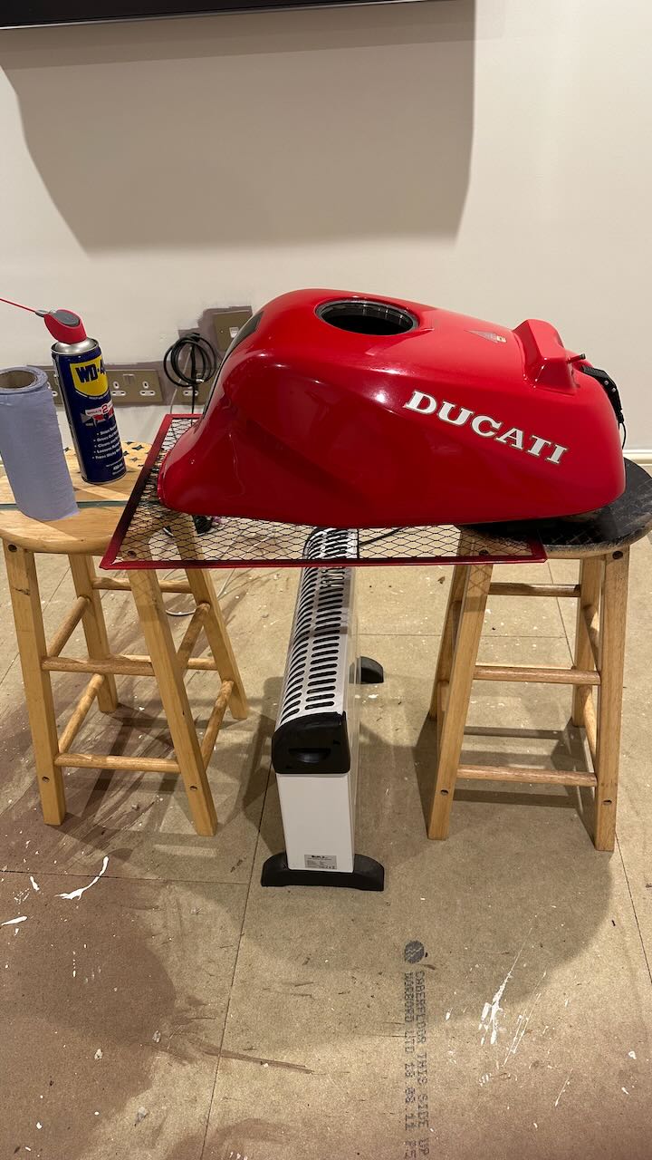

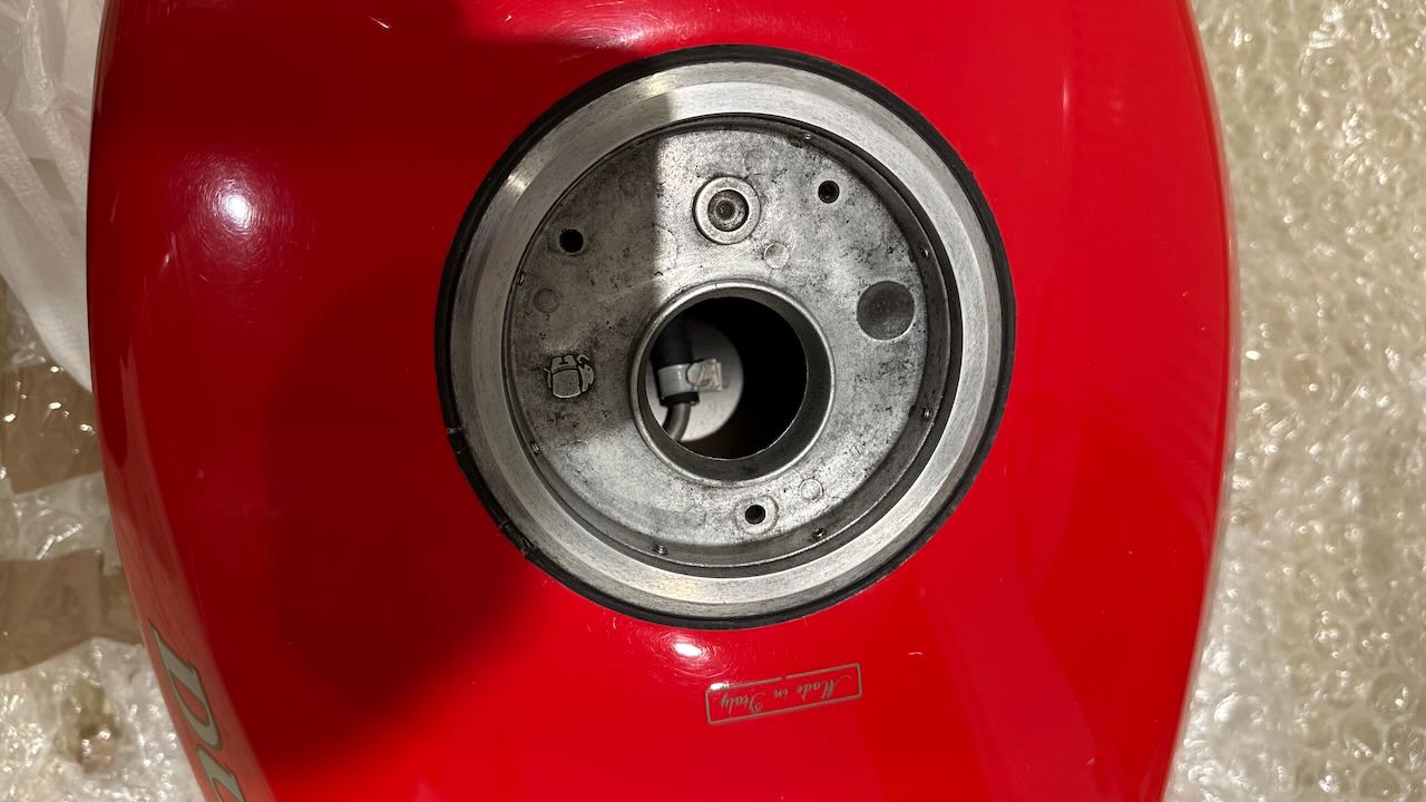

Replacement has arrived. I'm hopeful. It even came with a fuel sensor, which might fix the always-on fuel sensor. I bought a new sensor/float a while ago (at great expense), and it did not change the light on my dash.
Glad you are sorted, but please don't scrap the old one. There are precious few of these left and they can be repaired with work. Stick it on eBay with a genuine description and you'll get more back to cover your new tank than you think. I'd have a go at welding it up myself and might bid on it.
I have a light smattering of rust on the inside of my replacement tank. What would be the best way to treat the rust, fill with deox-c and rinse? I don't fancy trying the POR15 after the mess I saw in my old tank. Other than that, I am happy.
The mess in the old tank was down to POR15 being used to fix the leak. Once you have cleaned the inside seal it and you’ll. have a longer lasting job.
Left to soak overnight. Rinsed today, now drying. What would be the best way to seal it or should I get some fuel in?
