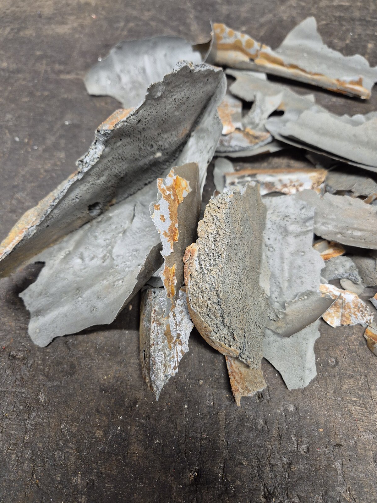

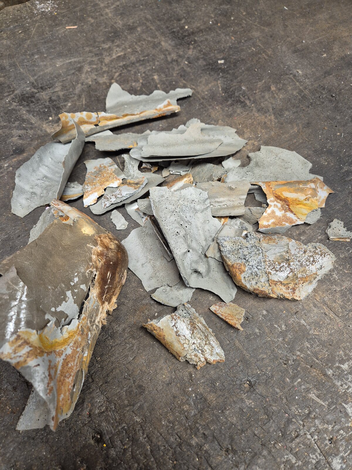

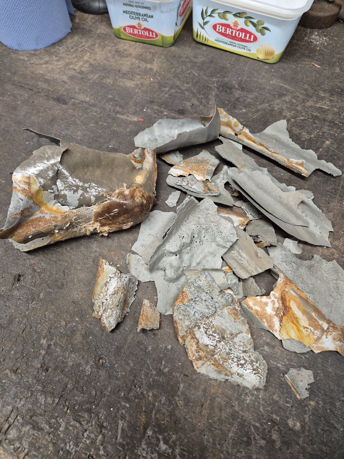

  1. Looks good, if you don’t want to Por15 this tank then just get some super unleaded in it
  2. I always see negative comments about POR 15. I'll add my thoughts. I've done 4 tanks with POR15, and my current one on my SS was done about 5 or 6 years ago. I've had no problems with rust. It was properly cleaned out and dried, which is key, as any moisture trapped will cause rust. The same company does a sealant which can be used to seal holes, although maybe not as big as yours.
    I personally like the tank sealer, gives a longevity to these tanks, as they are indeed getting rare and expensive. But that's just my opinion. Clearly not everyone has had positive experience with sealers
    #42 Desmoquattro, Mar 28, 2025
  3. I have also used it on several tanks and had no problems with it at all, the key is in the prep. It’s a great product.
    I think the reason the op has had a problem with their tank is the fact that someone repaired the hole with fibreglass before putting Por15 over it. It’s the fibreglass that has failed.
  4. Yeah, unfortunately tank sealer is often used to cover up bodgery
  5. each to their own, I totally understand people choosing this course, particularly if they don't weld.
  6. Weld/repair the area, clean throughly then seal.
    Jobs a good un.
    Glad you got it sorted.
