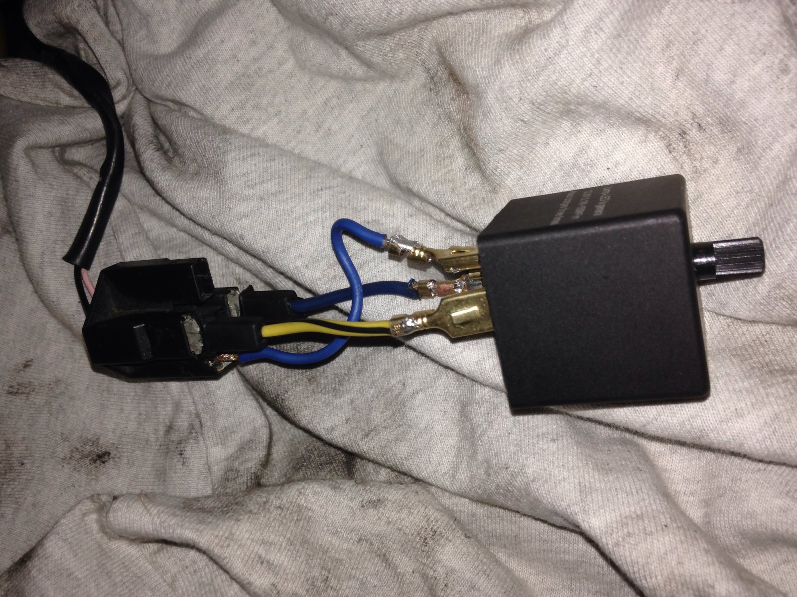

  2. Update. Compared adj. relay with original and the opposite blades are reversed polarity.
    I modded the wiring and it works well. From flash every couple of secs to 4 per sec.

  4. image.jpg image.jpg This is temporary for test. I will get a headlamp bulb plug and solder three male spades to the wires. The middle stays same while the 2 either side swap over.

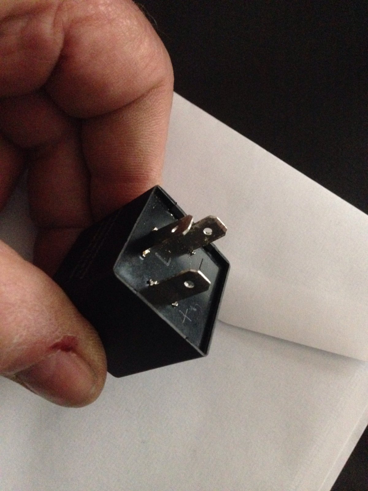

  6. Mine is a plug, 3 x female socket thats wired into the loom. I put cloth under it so you can see what Ive done. When I plugged the relay in it didnt work so I compared it to the old one. The relay spades are marked....
    L
    The + and - were other way round to original so I made extention lead to swap the outer 2 wires over.
    If you find your relay(switch indicator on you'll hear it clicking), if its 3 pin,you can fit one of these, but will prob have to mod wiring like I have.
