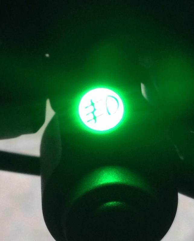

  5. Guys the switch part number is 65110151B called left switch plus a pic of where it sits.

  8. Found out like many others that the switch light is annoyingly bright at night so hole punched a bit of black elec tape out n it cuts the blinding light out nicely to a dull glow
