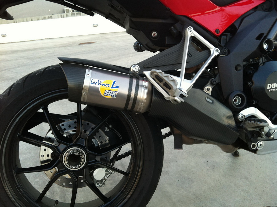

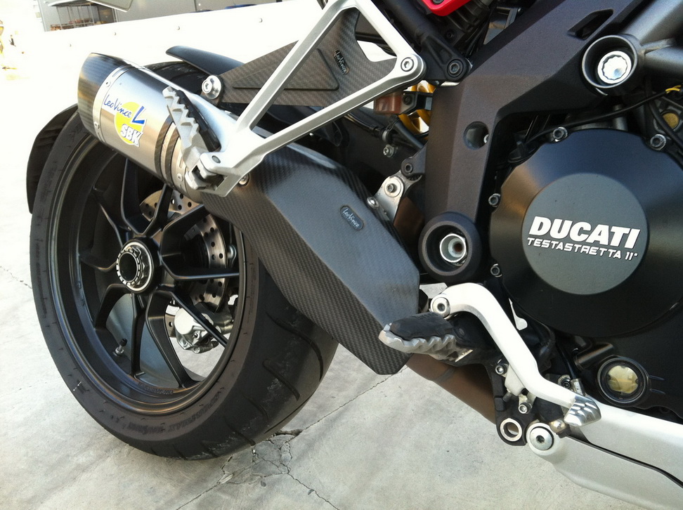

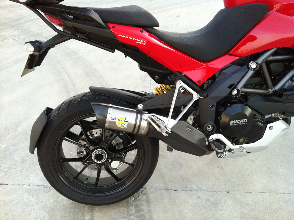

  3. To the guys with the same set up did you manage to get the bracket from the exhaust can to reach the passenger foot rest?
    Mine is a good 2-3" out? Double checked everything then got an engineer to check. He came to the same conclusion.
    You cannot get the supplied bracket to support the end can?
  4. Yes, to insalll the end can only took 30-45', pretty straight forward. For the bracket I had to push a bit to reach the foot rest's screws, about 1-2mm. Did you put the small mid-pipe, between the end-can and the main tubes?
  5. Yes I did fit the mid pipe and twisted it, but something is still out.
    It only took 10 minutes to fit, but there is no way I can get the bracket to fit.
    Please can you send a photo of the right hand side of the bike from about 5' away...I would like to see the angle.
    I think something is wrong or missing. Note the standard exhaust end can does not have any additional support and that weighs 3 times as much!
  6. here are the photos...
