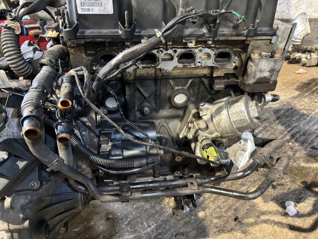

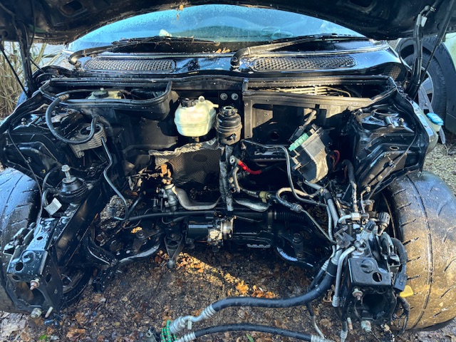

  1. Totally agree with all of this mate, I’m going to run mine with stock supercharger for now until I have a stable running platform to go from, that includes prioritising spend on getting the engine perfect. I’m toying with a new set of silicone hoses, and as you say the bleed point on the left cooling pipes to the right of the rocker cover is also a key bleeding point, not just the front one. Another thing is that they break the coolant tanks and leak out, so I have a new one to fit also.
    they are a solid engine, but I think they really suffer from neglect when it comes to coolant, and the non ‘headline’ bits around the supercharger such as boost control valves etc.
    I’m knackered after yesterday! For my mate it’s all the same crap he deals with every day. For me the shear number of connectors and pipes running all over the place was just a bit daunting!

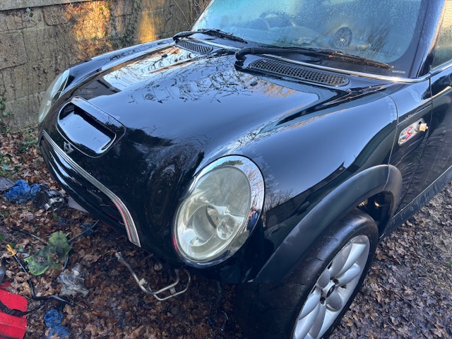

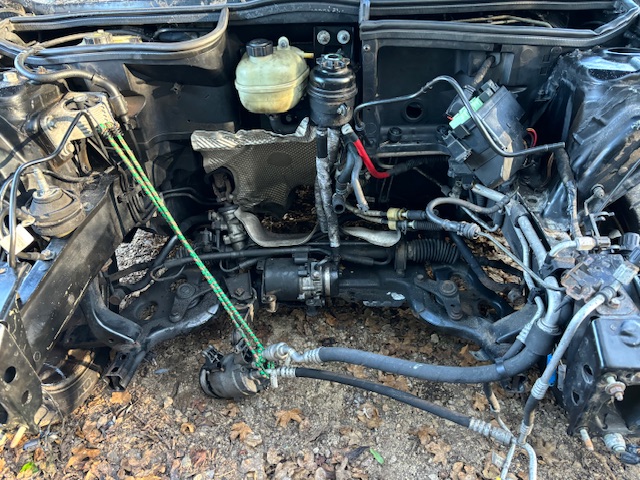

  2. Today’s progress….

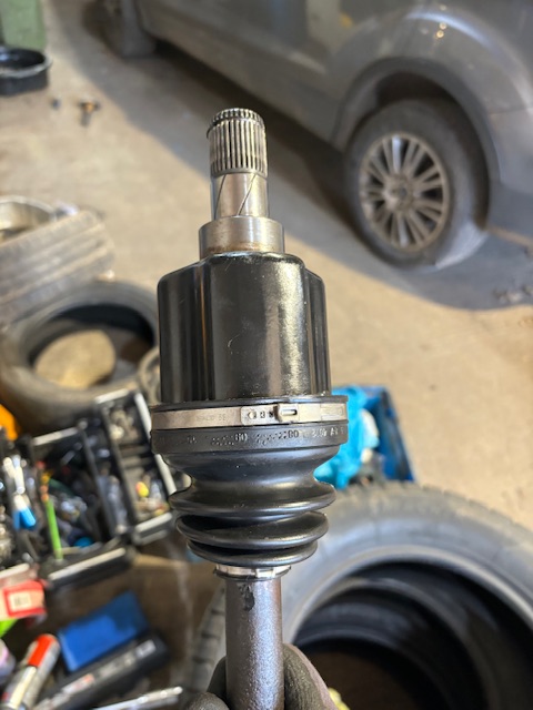

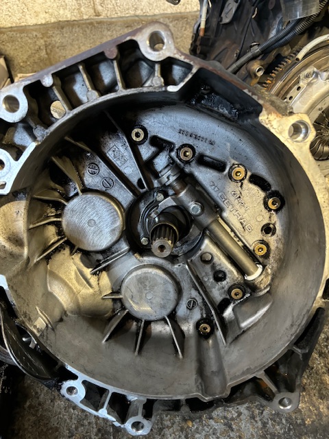

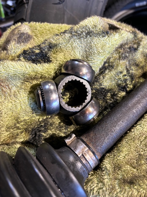

    I’ve been prepping the engine ready for fitting tomorrow, so gearbox clean and new bushes on the clutch arm, stripped and rebuilt a drive shaft to replace a broken boot and yeah, a ton of other little jobs.
    And yep! Replaced the coolant reservoir while I was in there! Not taking the risk
    I even gave the engine bay a quick de-grease and wash so that it’s a bit nicer once the engine is back in.
    feeling quite positive as I’ve done lots of little jobs I’ve never done before which is always a nice feeling.
    I even washed the bonnet to see what the paint is like! Can’t believe it, it’s black haha

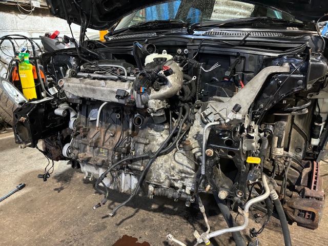

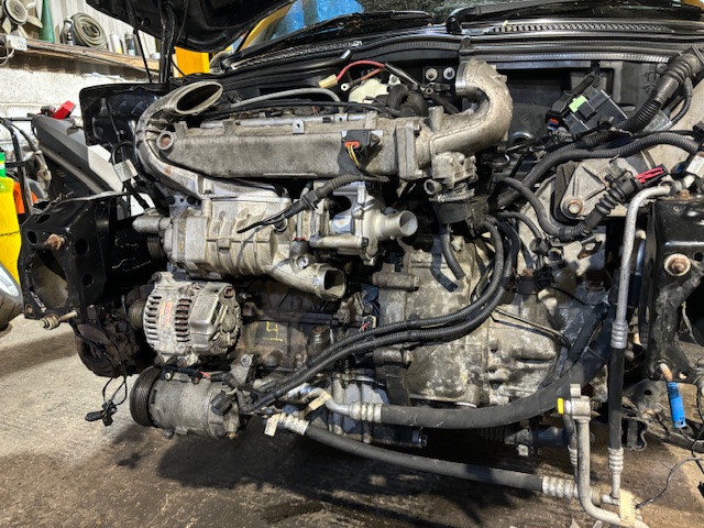

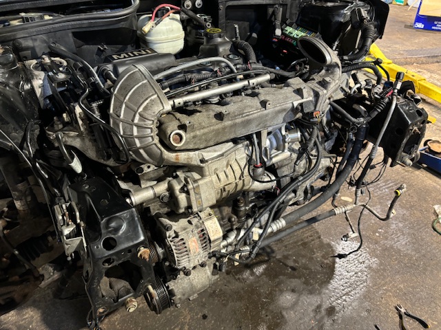

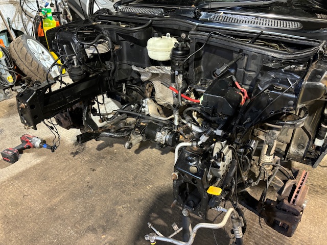

  17. Todays progress! So so nearly there…
    I made a few rookie mistakes along the way, like forgetting to put the clutch thrust bearing in! Luckily sorted it before putting the engine in the car.
    today I’ve managed to get the engine and gearbox in, most of the wiring around the bottom and the exhaust etc, axles etc all in. I’ve managed to change the gearbox oil and drop the engine oil and refit the supercharger and alternator and air con pump.
    so left to do is….
    - fit the aux belt and dipstick
    -fill with oil
    -put the intake and throttle body on
    - finish connecting the wiring under the ecu
    - fit radiator and fill with coolant
    -fit the intercooler
    - fit the Airbag ecu back in and put some seats in it (so all the airbags are connected)
    Then try to start it…..
    I’ve got issues with my key which has fallen apart, but will see what I can do with that, that’s my biggest worry at the moment is the state of the key. Body wise, for a car that’s done 116k miles, the car is in really great shape.
