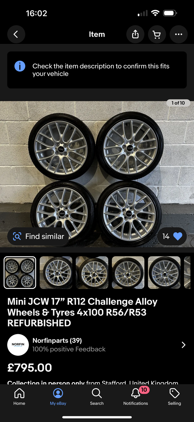

    I’m either going to stick with the classic Mini S spokes (as they are the OG) or go with some R112’s from the R56 JCW cars. Pics below of the ones I mean.
    I appreciate its not original and I wanted to create a sleeper original spec, but we will see. I’ve got one slightly bent wheel which I could replace then get the 4 on it tarted up, that’s the cheapest option probably.

  2. Those R112's are super nice and as they're not splits, the refurb is approx £25 a wheel compared to R98s at £120 each! I wanted a set of either and the 4 x R98's turned up at a good price first. Used prices of these wheels vary massively. Keep a good eye on eBay and FB marketplace if you want a good deal. Unless the tyres were special or brand new I'd be wanting to pay max £500 for a set with good rubber and ideally closer to £400, -they are around.
    I agree with you re 18's, the ride is too rough especially in pothole Britain.

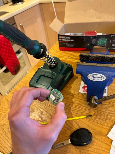

  16. Today was ‘solder new button on’ day! A little job but so much easier than having to touch a bit of wire on the circuit to unlock it!
    for now I’ve got a key body with the circuit board in, and then the original Valeo key with the immobiliser in it separate. When it’s running I’ll get a brand new key from BMW and keep this as spare.
    facelift keys were a bit more complicated as they charge in the ignition etc.

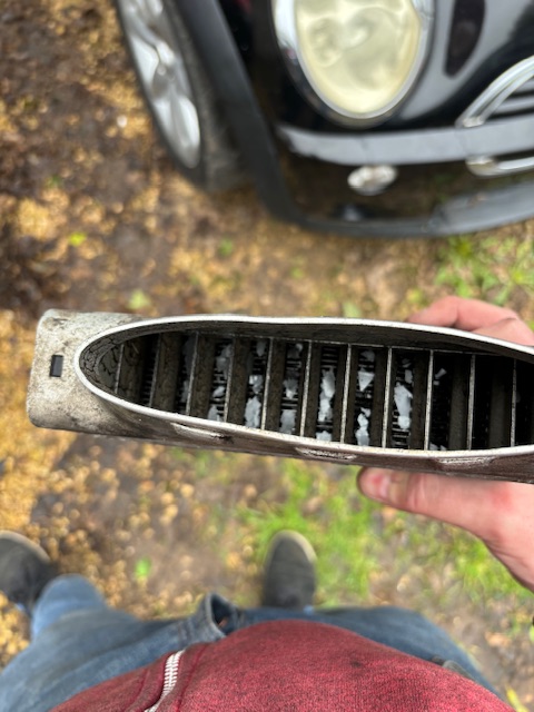

  18. Not sure where to begin…..
    Here’s a pic…
    I changed the Alternator, and went to start the car and had the same thing as last week, weird issues and wouldn’t start, looking around the engine bay I noticed an earth lead not fully tightened, immediately the car fire up no problems…..
    so… was my alternator faulty or was it the loose earth, anyway… car started and charged fine.
    as you can see though, what’s in the intercooler shouldn’t be there.
    when I serviced the supercharger I checked all the screws for delaminating as the early chargers did that, they were perfect. So in 3 starts, they have started breaking up and pushing through into the intercooler.
    so now supercharger has to come off, and I have to find another…. Not to mention the expense.
    I did drive the car briefly to check gears, clutch and steering and all was good, but I actually don’t car now, feeling so fed up.
    I get that it’s a project but the thing that’s annoying me is it’s all the good parts that I didn’t think I needed to spend time on or checked over that are causing me issues
