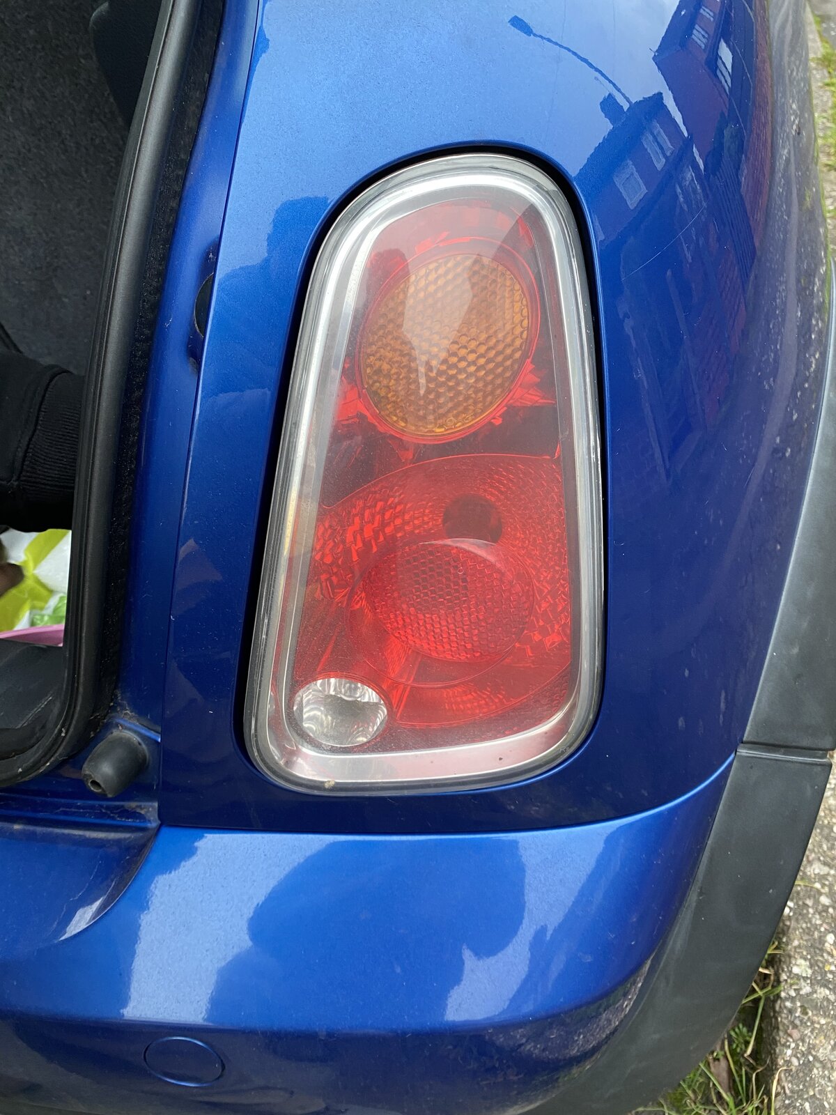

  3. The Union Jack tail lights are mega-cringe, almost to the point of parody because the modern Mini is about as British as Queen Victoria

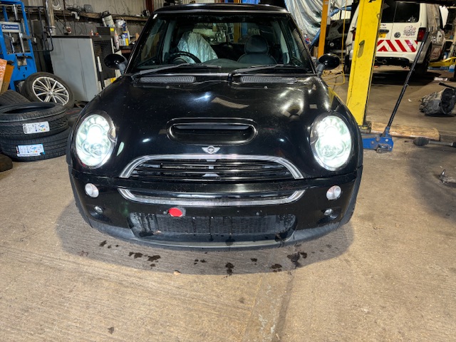

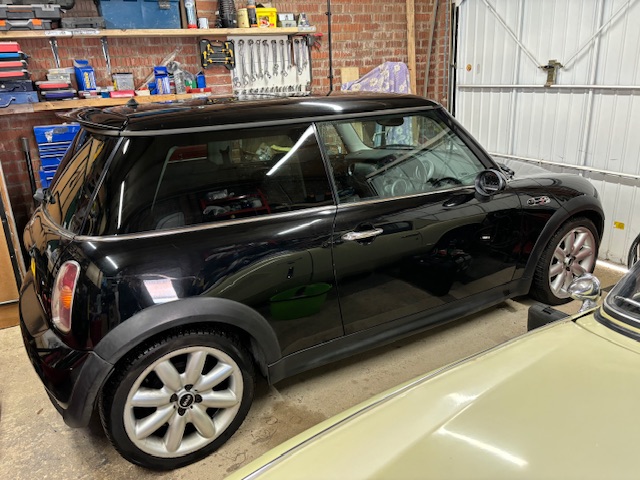

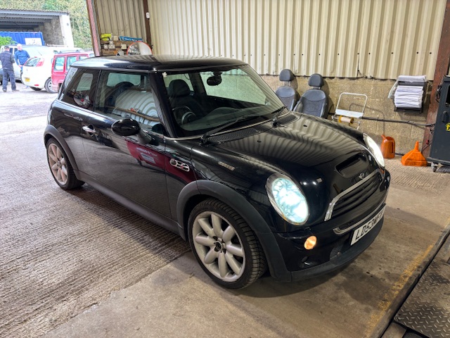

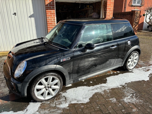

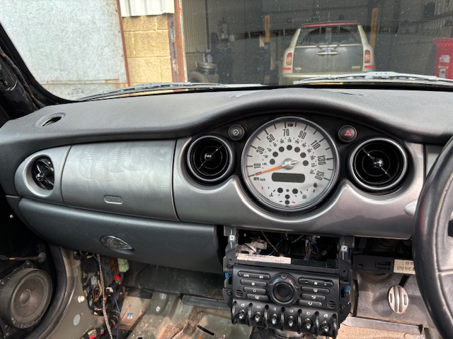

  5. Progress today! Got Some facelift headlights fitted, and the newer style ‘metal look dash’ which is nicer, and finally got the two rear tyres fitted so have a good set of new winter tyres on there now (and will get some other wheels for the summer tyres when I can afford it)
  6. Looking good :)

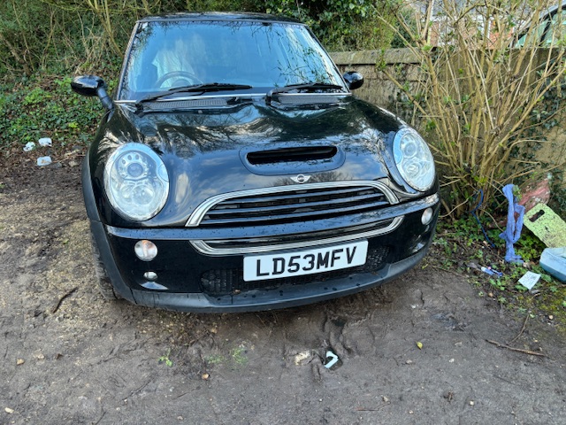

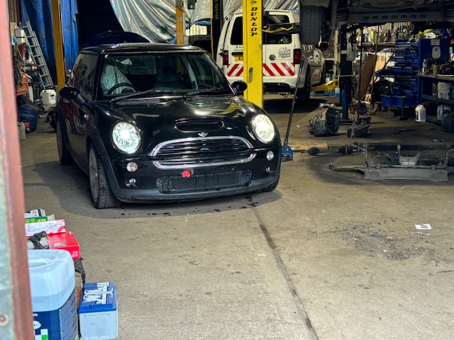

  7. Well a big shift today! Fitted a newer Teflon supercharger which has a 15% reduced pulley on (spoiler alert, they go like stink with these on!!!) but some challenges along the way! I stripped a thread on the alternator, my bad, but also the alternator which I bought which is supposed to be factory doesn’t really fit, which turns out is a common issue with time. I’m not paying £600+ for a Denso one. Upshot is that the connectors for the alternator hut and unused mounting post on the engine, which is there for other cars that this engine went in (PT cruiser). Anyway, I cut the mount off the block, extreme yes but it’s a project car and I did a decent job of dressing it up after so that now alternators aren’t an issue.
    I’ve fitted some essentials, bulbs etc, and the front number plate, so it’s pretty much okay for an MOT and to get it back to my dads house where I can do some jobs like brake line replacement which are on the limit really.
    It doesn’t drive badly with 4 new tyres, and goes like stink!!!

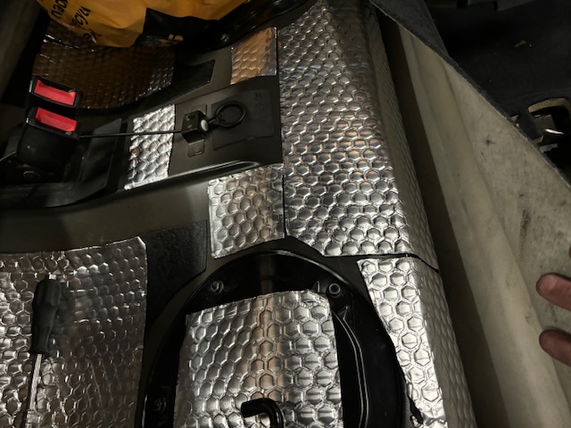

    - I’ve been fitting sheets of Dodomat in the door skins to try and reduce the noise, which I’m hoping with modernise the feel a little.

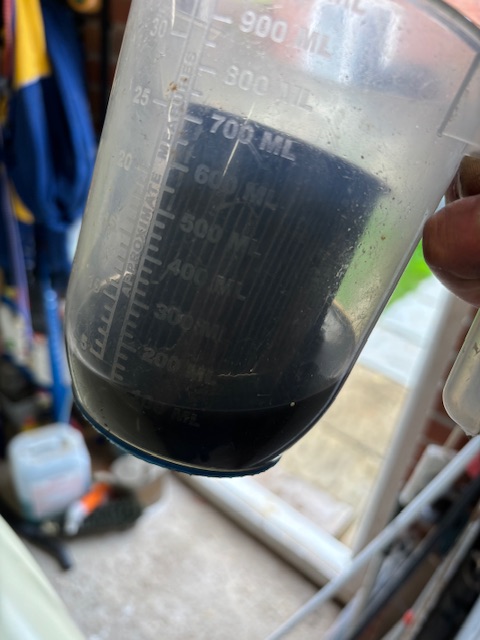

  19. Today’s fuel hours….
    fuel filter… it needed it, grim!
    Some Dodomat which will hopefully help with noise isolation etc and make it a touch more refined like the newer ones.
