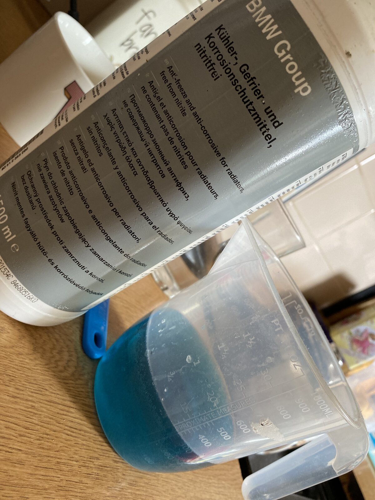

  7. I have plenty of proper bmw antifreeze here ;)
    It's blue

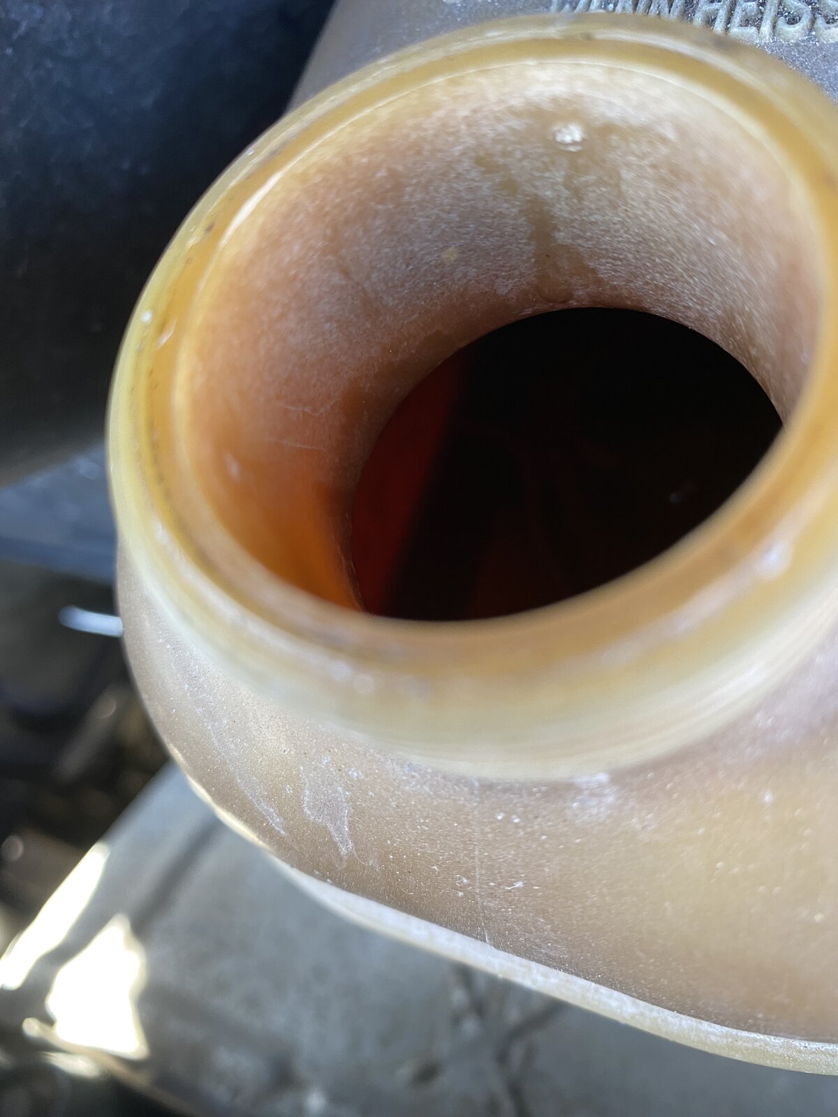

  10. Took out watered down coolant to fill up coolant tank and..... there is coolant in there which I didn't need much topping up
    How weird there definitely wasn't much in there when I checked the other day.
  11. Another question my antifreeze is blue but I have pink around the tank and underneath :thinkingface:
  12. Blue is usually Glycol? Pink is OAT?
    Was it changed at some point? These shouldn’t be mixed
  13. No never mixed I used BMW antifreeze and supply all my parts etc when servicing
    Water is always blue

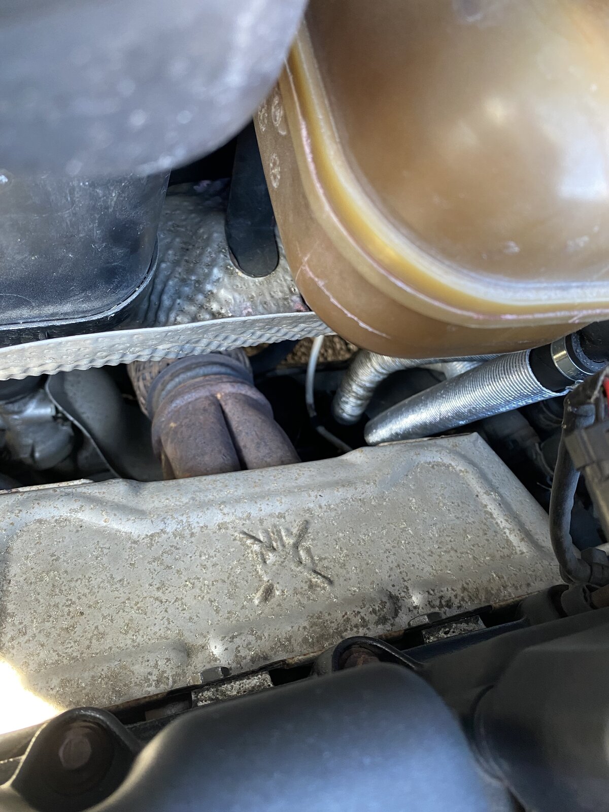

  14. I'm thinking it maybe road salt coming up the super charger scoop onto wet coolant bottle

  17. Was the coolant the same temperature both times when you checked, as it expands when heated.
  18. Both cold
    Not been driven for over a week
