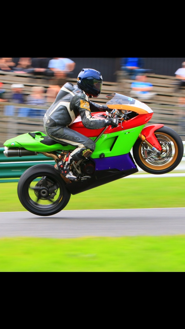

  1. This one looks like most of the weight saving work has already been done. It also looks like it would kill you in your sleep though.
  2. that is horrific.............. !
  3. Remember that spiny roundy weight is worth a billion times more than static weight.
    So wheels, tyres, chain and so on are what's best targeted...:upyeah:
