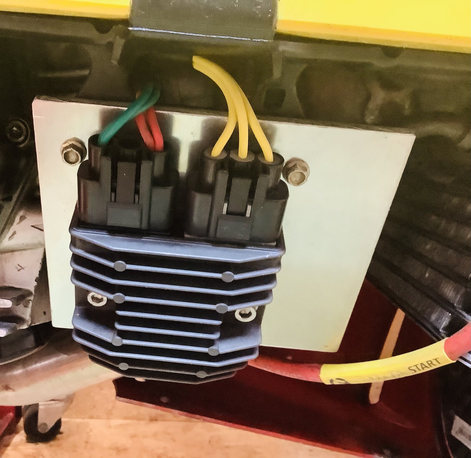

  2. Yes, it sounds to me like the sensible thing to do and ordered one today, the Triumph loom adapter is due today (that is the same fitment as the standard R/R as far as i can see) and the R/R is due tomorrow or saturday so will hopefully set it up over the weekend and make a bracket up, and see how it goes. I've also got a R/R for the standard battery coming as well so best of both hopefullyo_O, will keep posted with results:upyeah:.
  3. Ha didn’t need to bend the plate E0D781F9-A097-4489-8368-4532519260FC.jpeg
  4. I was thinking of making instead of aluminium plate make one out of 3mm carbon fibre sheet as it has heat resistance, i have some around in the garage somewhere.
  5. And off the bike red wires looked a bit close so reroute time don’t see why you couldn’t use carbon heat is minimal to the touch BE7FD56E-E505-48B4-BD94-1D4EE851FA15.jpeg
  6. Wayne, the Ali plate soaks up the heat from the Reg/Rec and then helps dissipate it.
    A carbon plate keeps all the heat in the body of the Reg/Rec which it then has to dissipate itself.
    Although as mentioned earlier, the newer units don't generate as much heat anyway.
    Nasher.
  7. Yes it was a thought on carbon i wasn't overly sure of the heat thing, i have some 4mm ali plate hanging around as well so will make a bracket up from that instead.
    It was a thought with the carbon, it would look good though:joy:, form over function does not apply here.:upyeah:
  8. Drill loads of holes if using 4mm plate, it will still be strong and look lurvely too :heart_eyes: big holes, not diddy ones :bucktooth:

  11. Another thought, how about drilling holes in a carbon sheet over ali for heat dissipation?:thinkingface:.
  12. No :blush:
