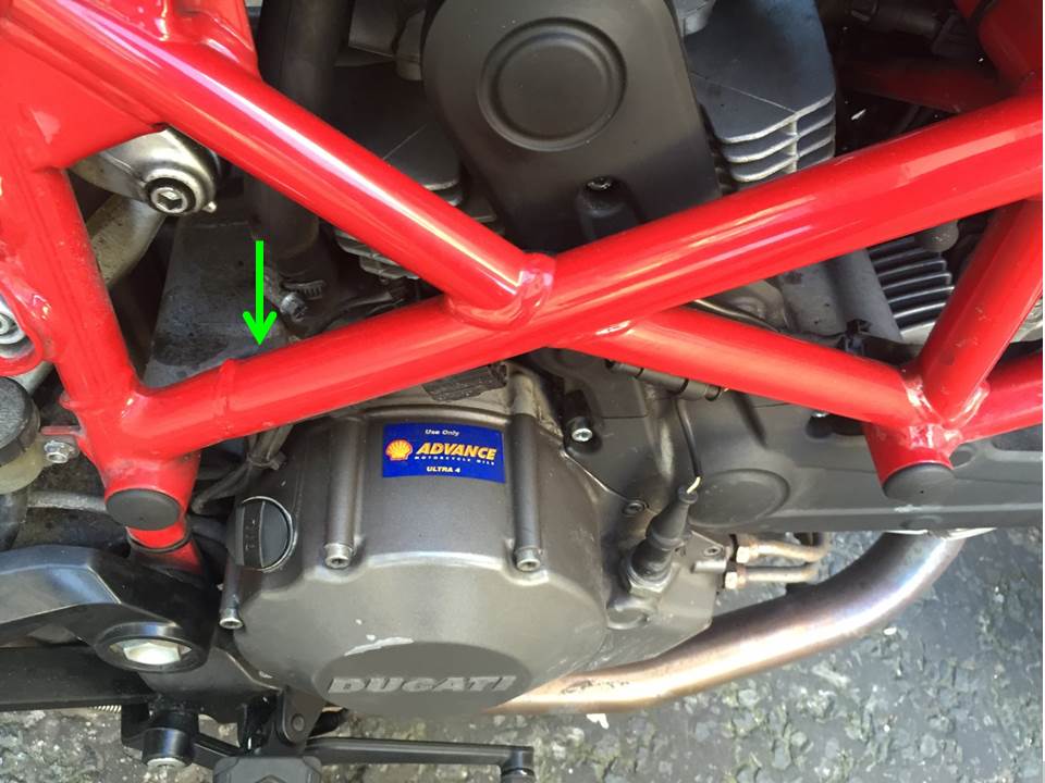

  12. Does your bike have an Earth (M8 Threaded Boss) here as in the picture? You can just see the head of the Cap Head Bolt behind the frame rail. This is a different Earth point to standard on the 1100/1100S Kit - if so this Kit will fit. If not then the 1100EVO Kit that I am just developing will fit by the looks of the Part Drawings.
  13. Thanks Exige, I don't think the 796 has the same earth. here are some pics. Dosed that show you what you need to see.. I have my bike at work today so I can take some more pics.
    I'm near Goodge Street Station on the off chance you are anyway in London.
  14.
  15. Ah just pop down Stu :)
    Doesn't look like there is a blank or a threaded M8 hole. Here are a few pics from multiple angles.
    Note to self, must clean bike this weekend.

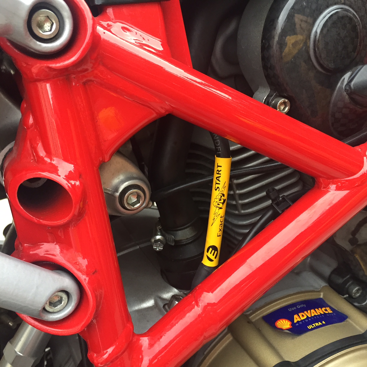

  16. Just to update this thread. Here is the earth on a 2011 796. I think the same as 1100 Hyper Evo.
    The yellow line traces the cable from the negative terminal to the earth point behind the cable cluster.
