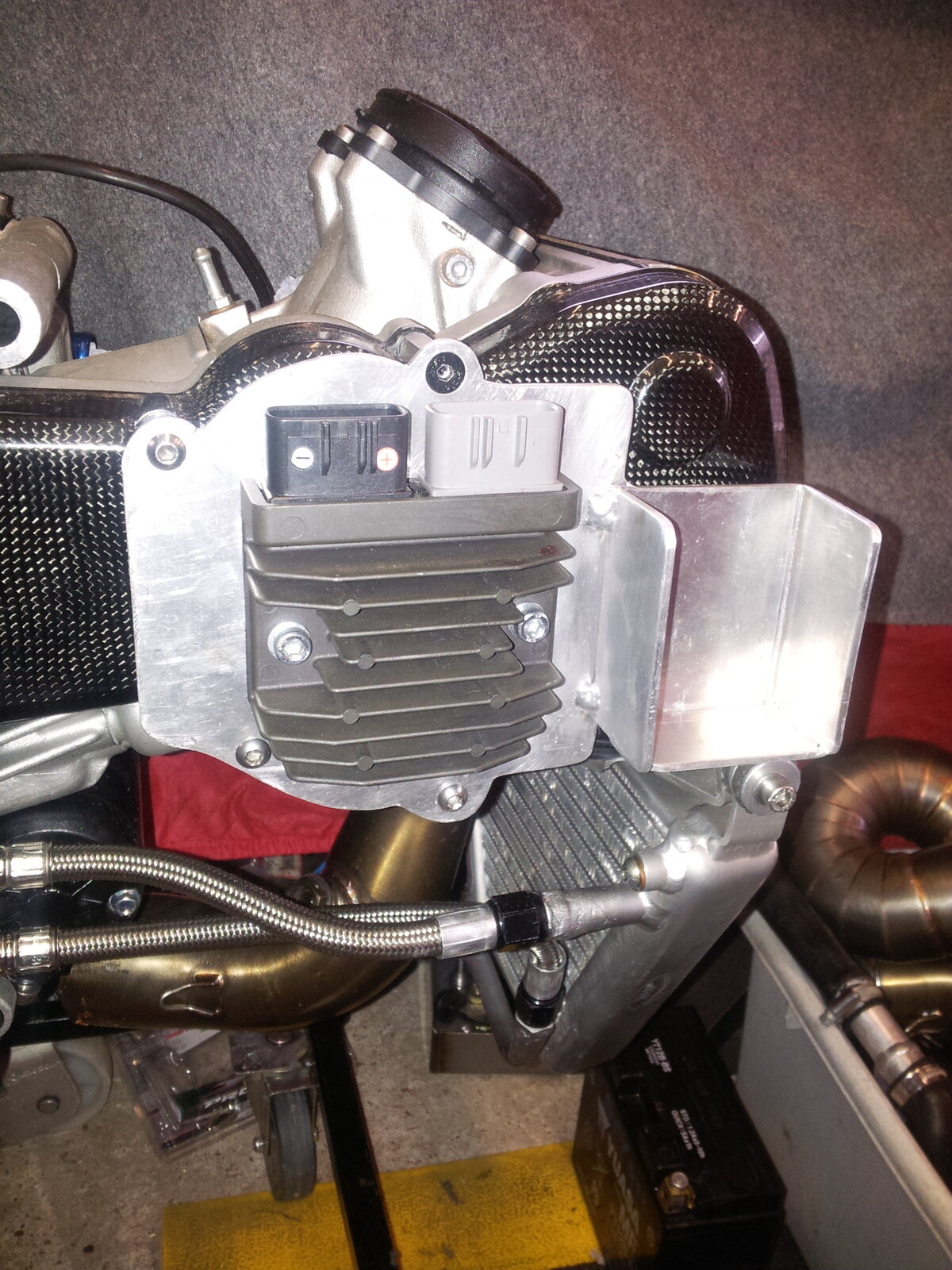

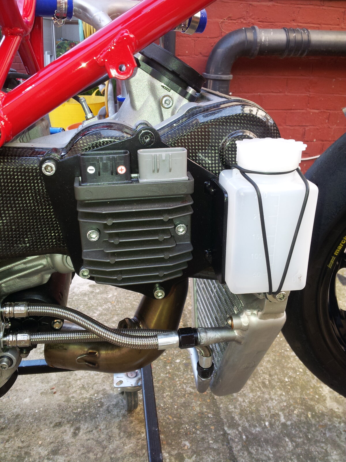

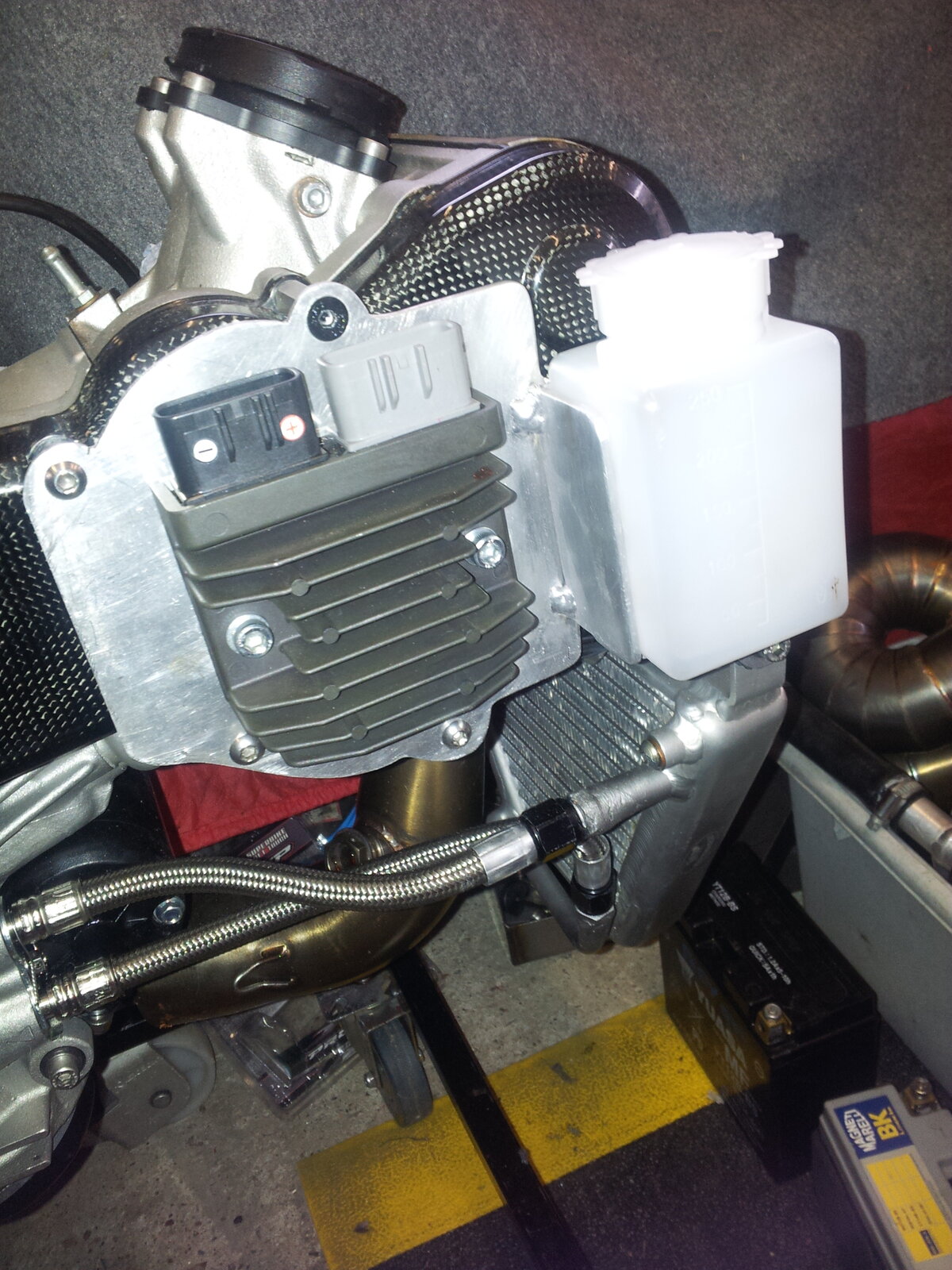

  5. I trimmed it down a touch and painted it black. Also with a place for the overflow bottle..

  6. Just out of curiosity, why do both of the bracket solutions have the mosfet mounted plugs up?
    Is it to do with cable lengths dictating routing?
  7. I put mine that way as when I plugged in the Triumph loom, it seemed to work better to route the cables.

  10. If you read the installation link I posted, the 1098R one I did was in the same place as your 1198. The conversion moves it to the RHS of the bike in a cooler location.
