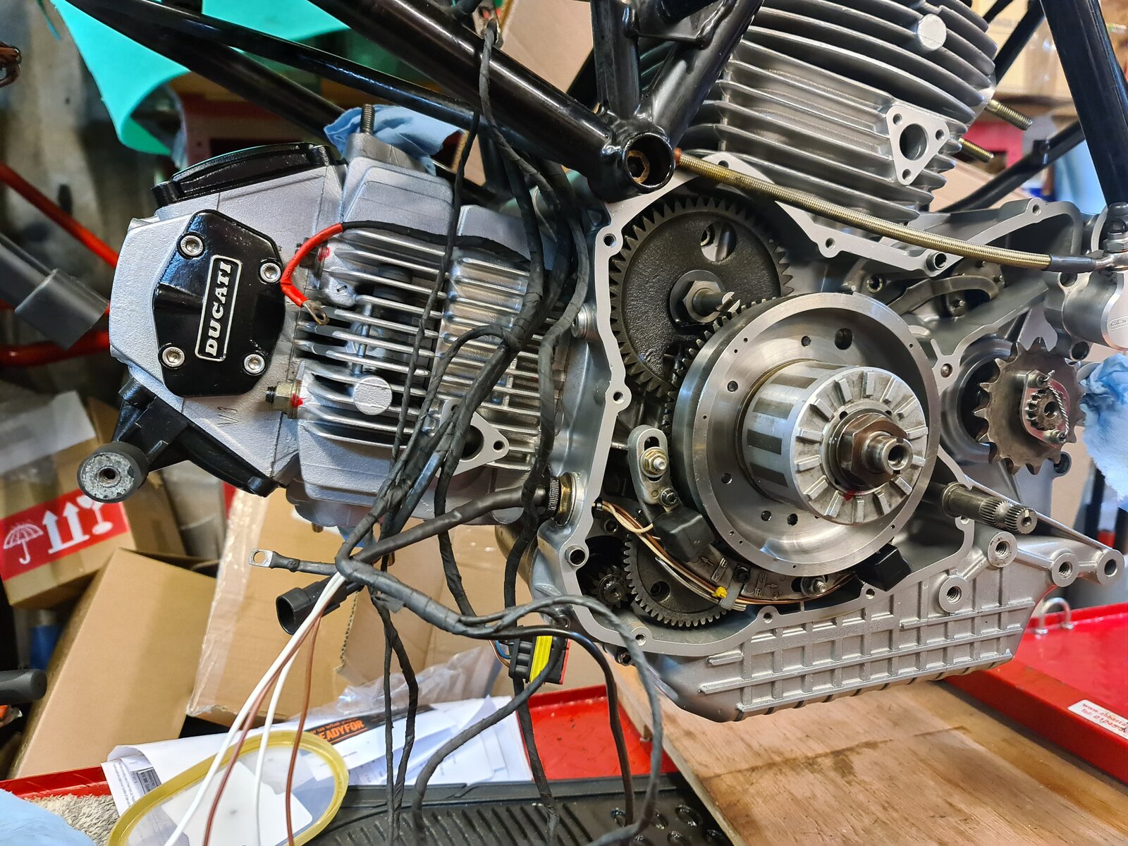

  1. Looking Good
  2. Shame to dirty that piston by starting it :)
  3. Top left engine stud looks way off kilter ?

  5. dear little thing innit ? Matlock ?
  6. yup.
  7. It looks it, but it all goes together ok. One of them was recoiled by a local engineering place, so it could be out a bit. The stud had broke
  8. oh errr. Personally i wouldn't be happy about that, the engineering place appears to have not got the wire insert square or central to the original stud location as you say.
  9. Its not an interference fit, and its been like that for a few years now, so I didnt worry. The studs are really hard to remove, they drilled it. Spark erosion is the best option if it was to happen in the future.

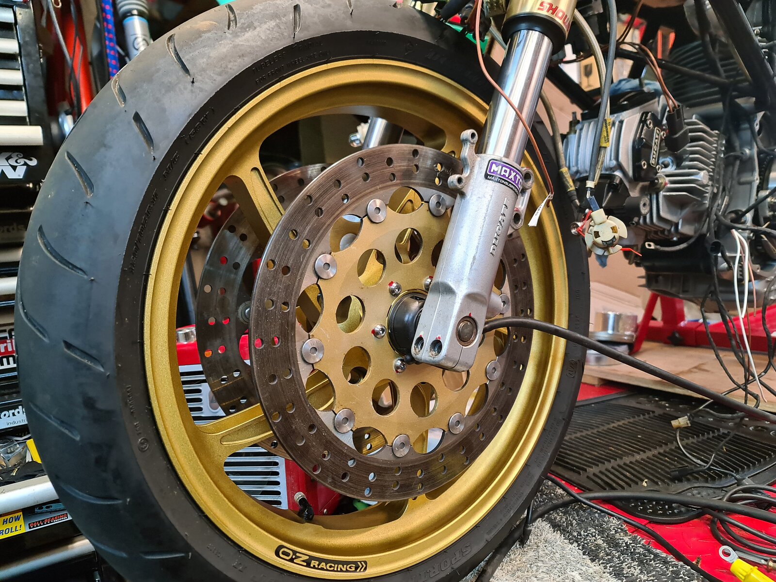

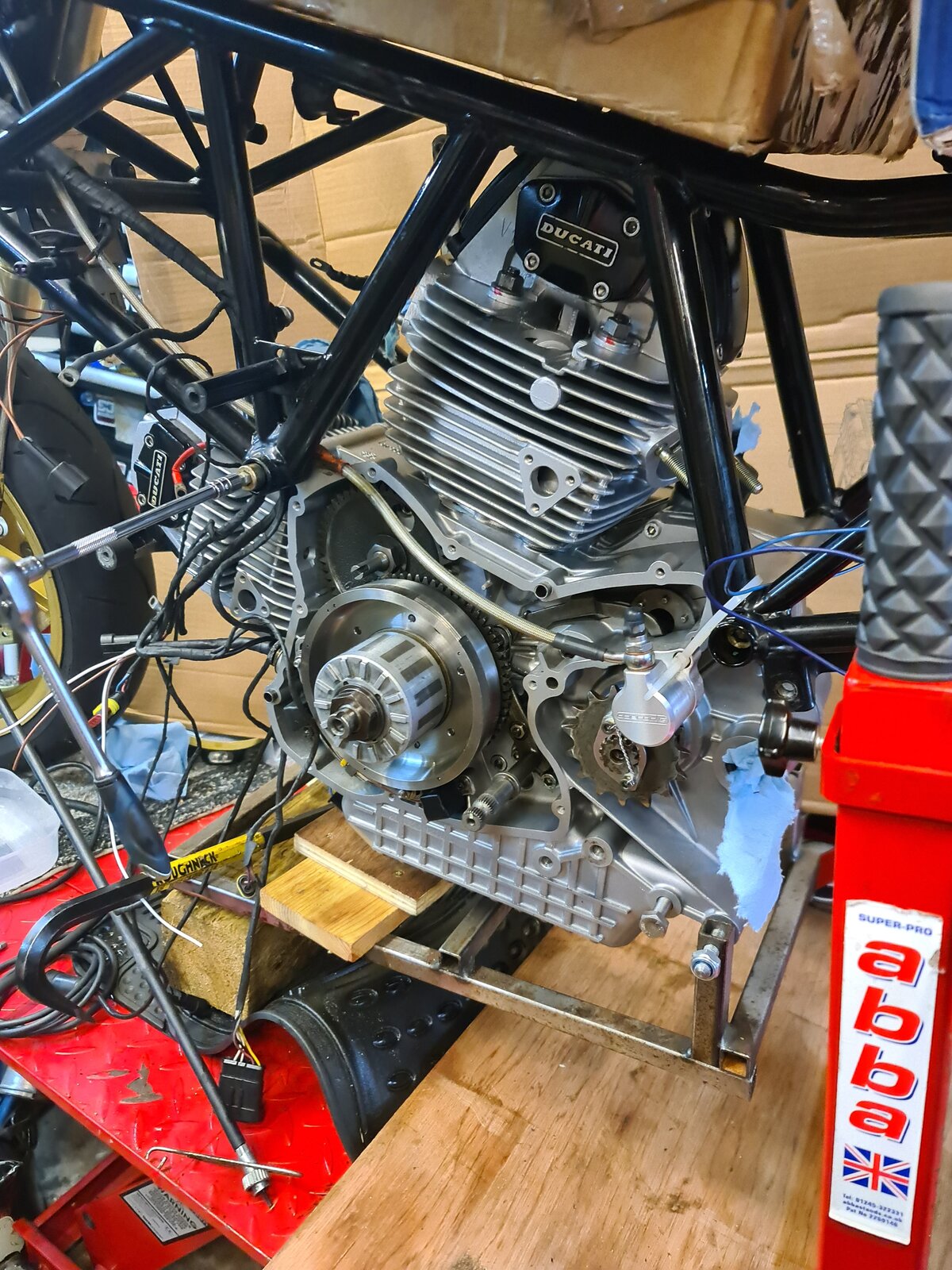

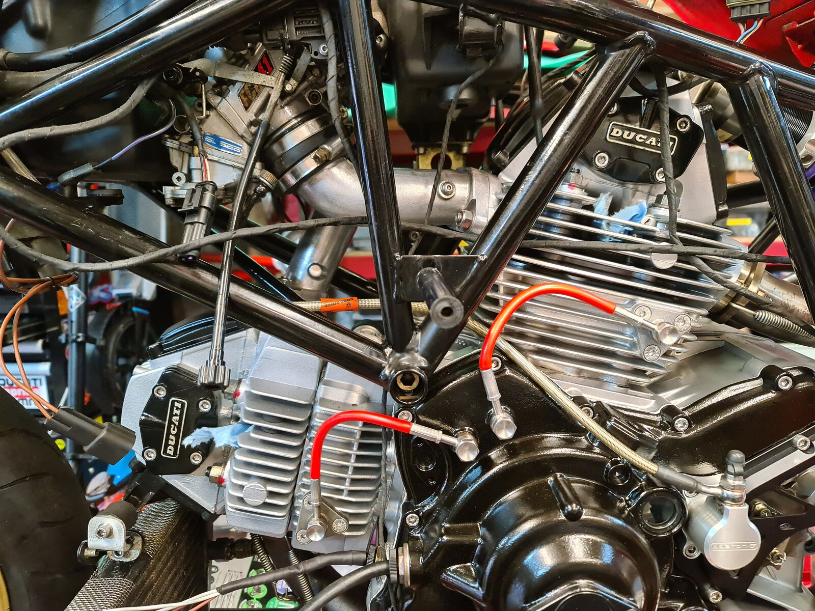

  17. Ive made some good progress recently, engines in frame, waiting on some parts for the alternator case, grommet etc and gear linkage seal. Front wheel back on, trying some other discs too see if theyre any better.
