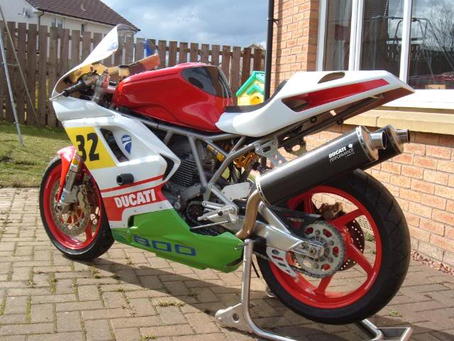

  2. Depends if you want to keep the SS look or not. I has seen Aprillia V4, Fireblade, countless 1098 & 916, t9 and desmosedicci faoring all fitted to monsters and SS models in the DD racing. Check out Kenoir's pics, he's got lovely 1098 and a desmo liveried 600 SS bikes
  3. Bradders is 100% right, DD racing is probably the best ideas hot bed for working out what way you want to go with an SS track bike. This is now my 800 looked when I first built it it up, 1098 body & 9*6 seat.
    The world is your oyster with race bodywork, there is always a way to make it fit :)
