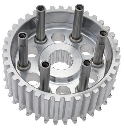

  9. Steve I may have got this wrong as I assumed the Ducati Corse clutch used the Ducati standard alloy hub?
    Steve the NGR pressure plate is 241 grams the standard Ducati ones from that era are 321 grams.
    If the 888 Corse uses an alloy basket and alloy friction plates (as opposed to the very heavy steel plates used by bread and butter Ducatis in the 90's) then these items will be of similar weight to the NGR slipper clutch items.
    The standard steel basket weighs 1120 grams an NGR alloy basket complete with steel finger support band weighs just 445grams.
    A standard all steel clutch plate set weighs approx 1450 grams an alloy set weighs just 927 grams.
    So if the 888 was originally equipped with an alloy basket and plates I am guessing the Corse one will only be slightly heavier than the NGR one so far, due to having a slightly heavier pressure plate?
    Now to the hubs where I could have made my mistake.
    I may have made the incorrect assumption that the 888 Corse uses the standard Ducati alloy hub which is actually very heavy because it also incorporates the rubber Cush drives and the very (bizarrely) heavy cast steel drive plate that plugs into the use drives.
    I have some NGR alloy (non slipper) direct drive race hubs in stock that are actually 637 grams lighter than the standard hub assembly because they forgoe the rubber cush drives and the steel dog.
    Did the Corse 888 hubs forgoe the Cush drives and steel dog drive assembly and use something similar to the NGR non slipper hubs?
    The NGR slipper clutch complete hub assembly is heavier than these NGR race hubs (but not by much) and is still very much lighter than the standard Ducati alloy hubs incorporating the cush drives and steel dog drives. Items like the bearings and ramps weigh only 0.5-3 grams each. The whole assembly is surprisingly simple and incredibly light.
    The weights for each component in our various clutch pacakes is listed in the product description for each item on our web site.
    Steve my apologies if I have incorrectly made the assumption that the Corse 888 uses the standard heavy Ducati hub in it's clutch? If it does the NGR slipper clutch will be significantly lighter than the Corse one. If it doesn't then the NGR slipper clutch will be only slightly heavier.

  12. Sorry NGR make nothing for the wet clutches. Here is a pic their Ducati dry clutch hub. It's 1 pound of butter lighter than the standard hub.
