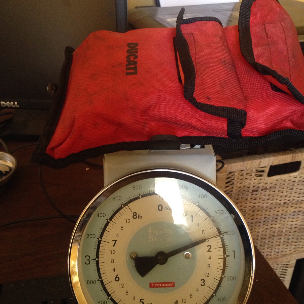

  1. Just remembered this under my seat, now in the garage....another easy saving....800gm[​IMG]

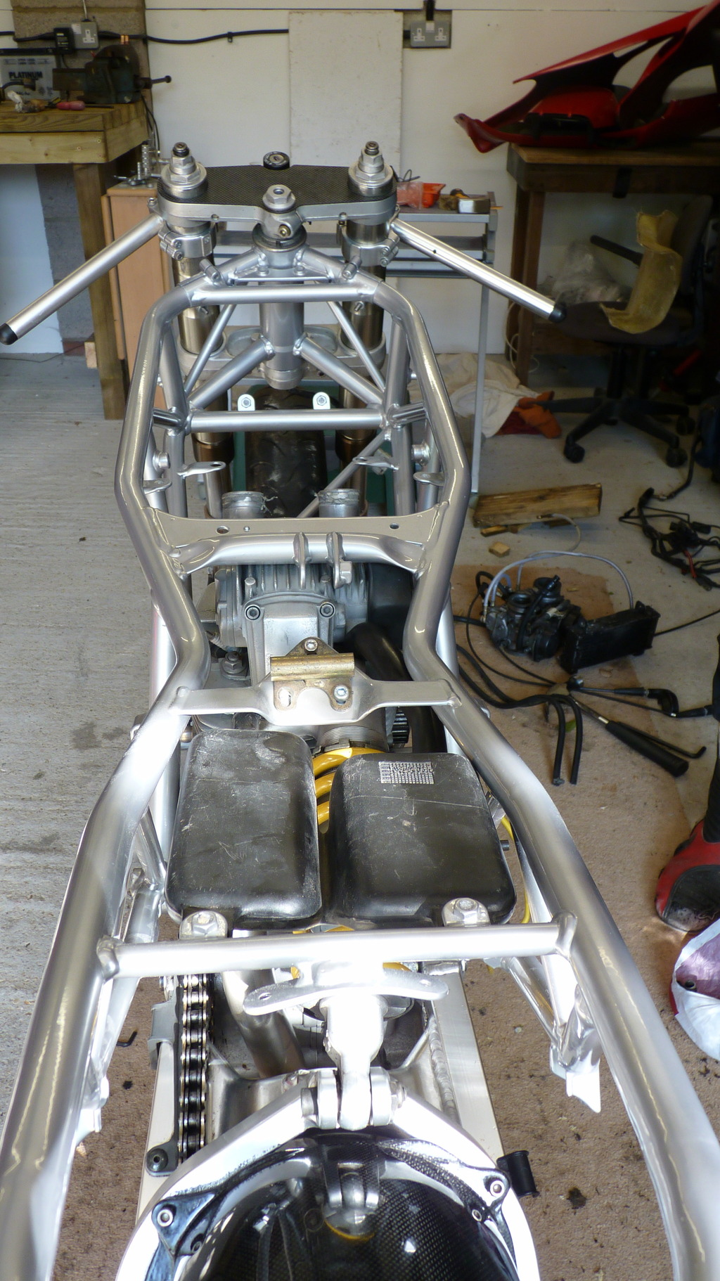

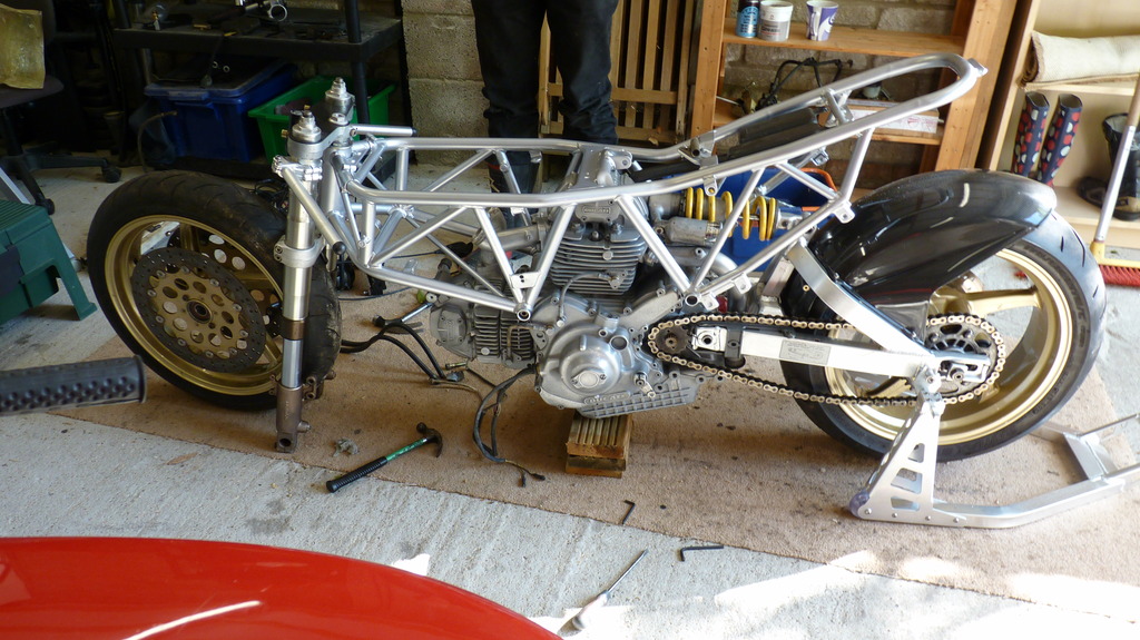

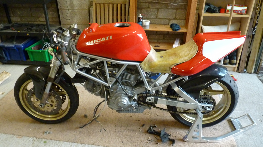

  2. Finally got paint done, gathered up the parts from around various parts of Wiltshire ready to build last weekend
    Slow progress as lots of family commitments
    Having a reference for remembering what goes where is useful :)
    Then got a Visit from Steve Bailey (BBB Fabrications / Duc904Red) and things accelerated :)
    And once on its wheels, its too tempting not to put the tank and seat on ;)

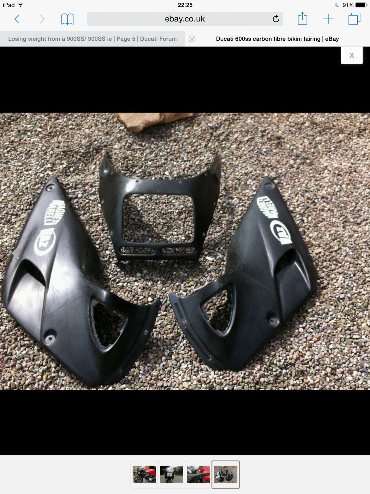

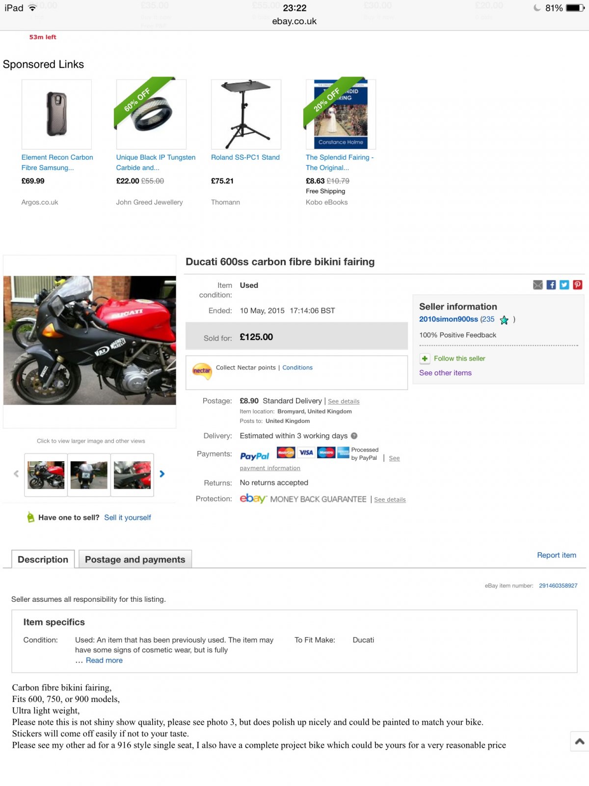

  3. Just bought these off eBay £125 bargain. So light I thought the box was empty !
  4. Here you go Steve. The guy has a seat for sale as well but not to my taste.
  5. Good work, I'd have been all over that for my other 900, I must refine my searches!
    the complete Supermono fairing and seat unit weight less than one standard side fairing panel
  6. Where did you get the hugger?
  7. Rich, I think it came from Carbon king. its a fair bit meatier than the front Guard but its good quality and still lighter than the original by some margin.
