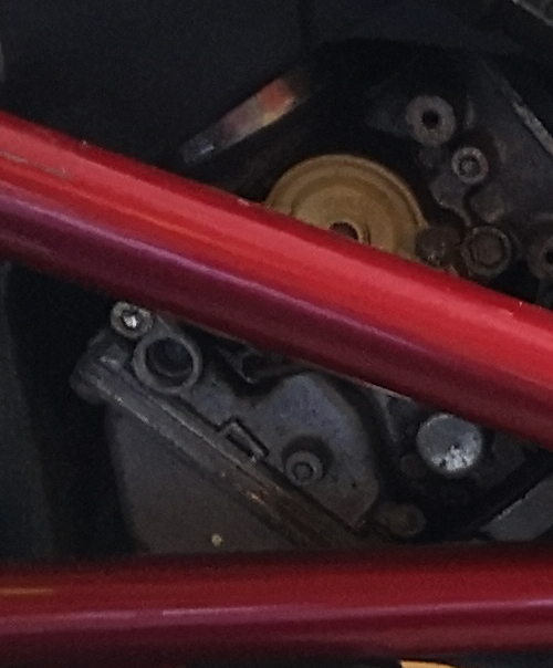

  14. Just post a couple of pictures of bike, one from each side to confirm carb or injection, it's the only way to be certain.
  15. A pic from above and behind the front wheel up under the tank would be even better.
    Almost certainly a carb bike though.
  16. Apologies, apparently it’s dead easy on a Monster to distinguish carb from injection from a side view, so no need for an under tank shot - I was thinking of my SS.
  17. [​IMG]
  18. carb :upyeah:
  19. You can see carb, What has happened to wiring? It looks a mess!
  20. Apart from the battery charger I have plugged in, the previous owner happened. And i've been pulling at it following the fuel lines to see if there was a blockage/kink anywhere.
    bought it very cheap as it had no MOT at the time and needed quite a few odd jobs doing to it. The wirring was none essential (it aint broke so done fix it type thing).
