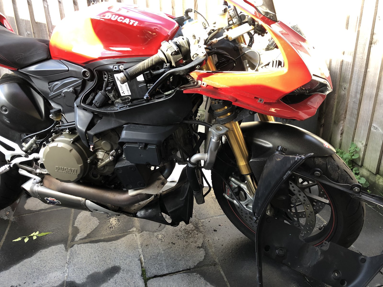

  7. All that to change a plug ???
  8. And I thought filling the cooling system via the radiator cap on an 1198 was a pita!
  9. E771707D-B800-49C6-9DB4-6A9412CE38F0.jpeg I hate this bullshit design!
  10. Only 32 hrs to go.... and then the same to put it back together...

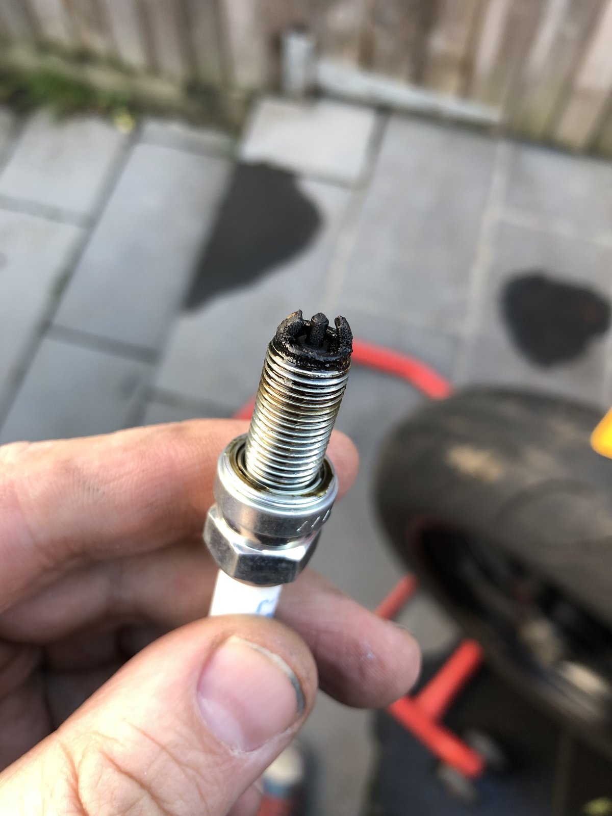

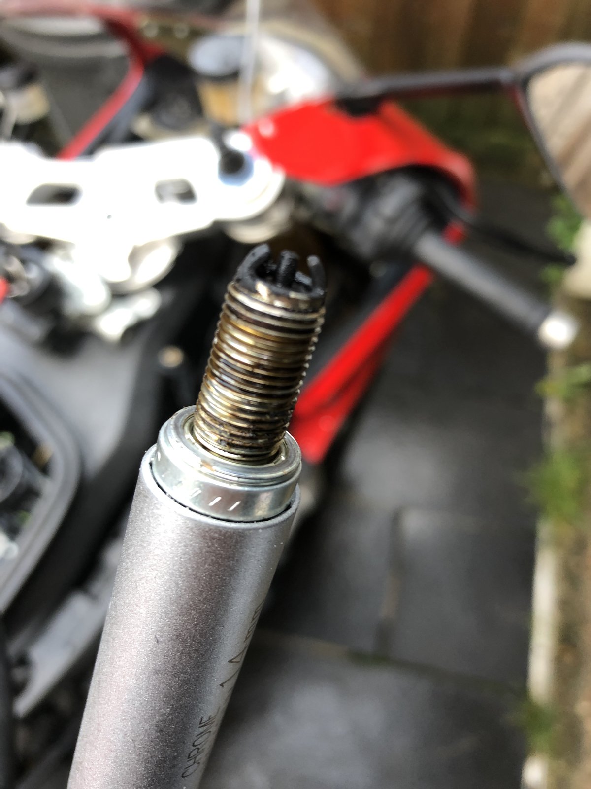

  11. A0307073-06AC-4EBB-97D5-FF6091BD8803.jpeg A0814F32-A0EB-4E9F-9659-EE3384D11A58.jpeg Ok, so managed to put all back together . Few bolts ( easy ones ) left to do but getting dark and started raining so I called it a day. Will finish off tomorrow morning and fire it up . Better fucking work after all that effort.
    Here are the plugs I pulled out
  12. By the way. I didn’t have to take rads off the bike. I took off radiator holder and managed to rotate upper rad slightly so I could get to plug with 3inch socket extension. Anything longer would be way too long

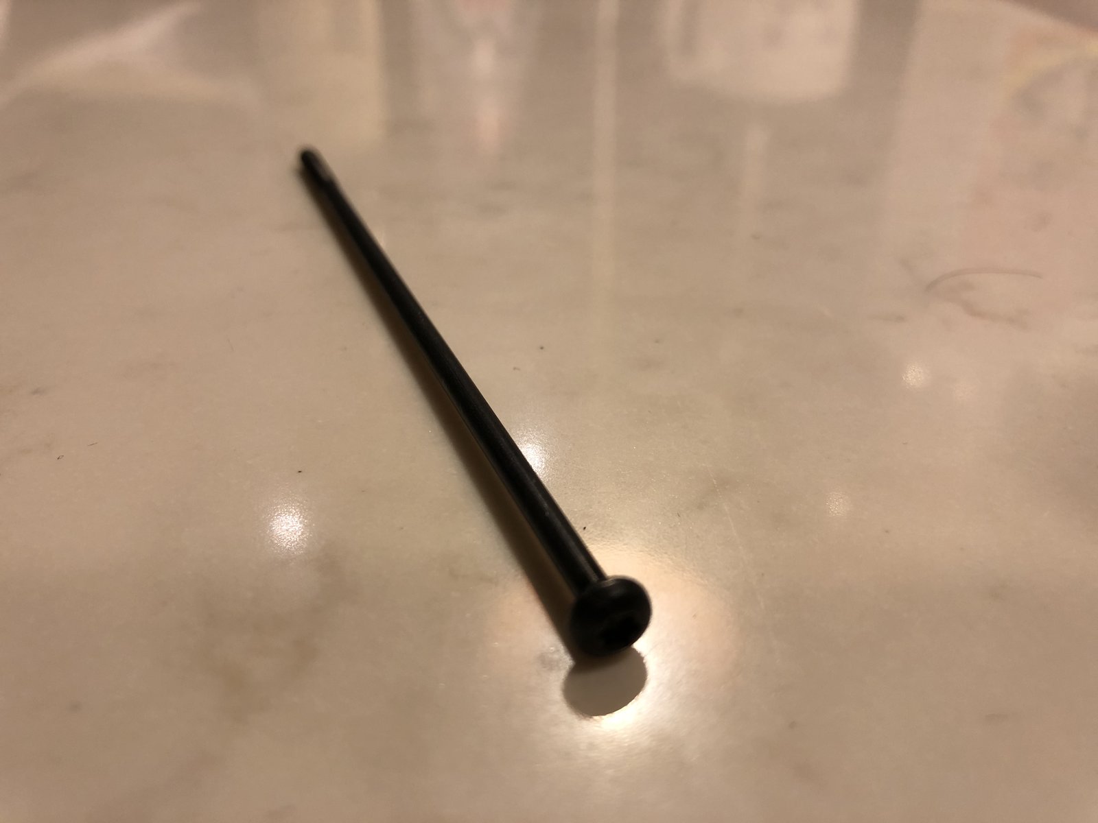

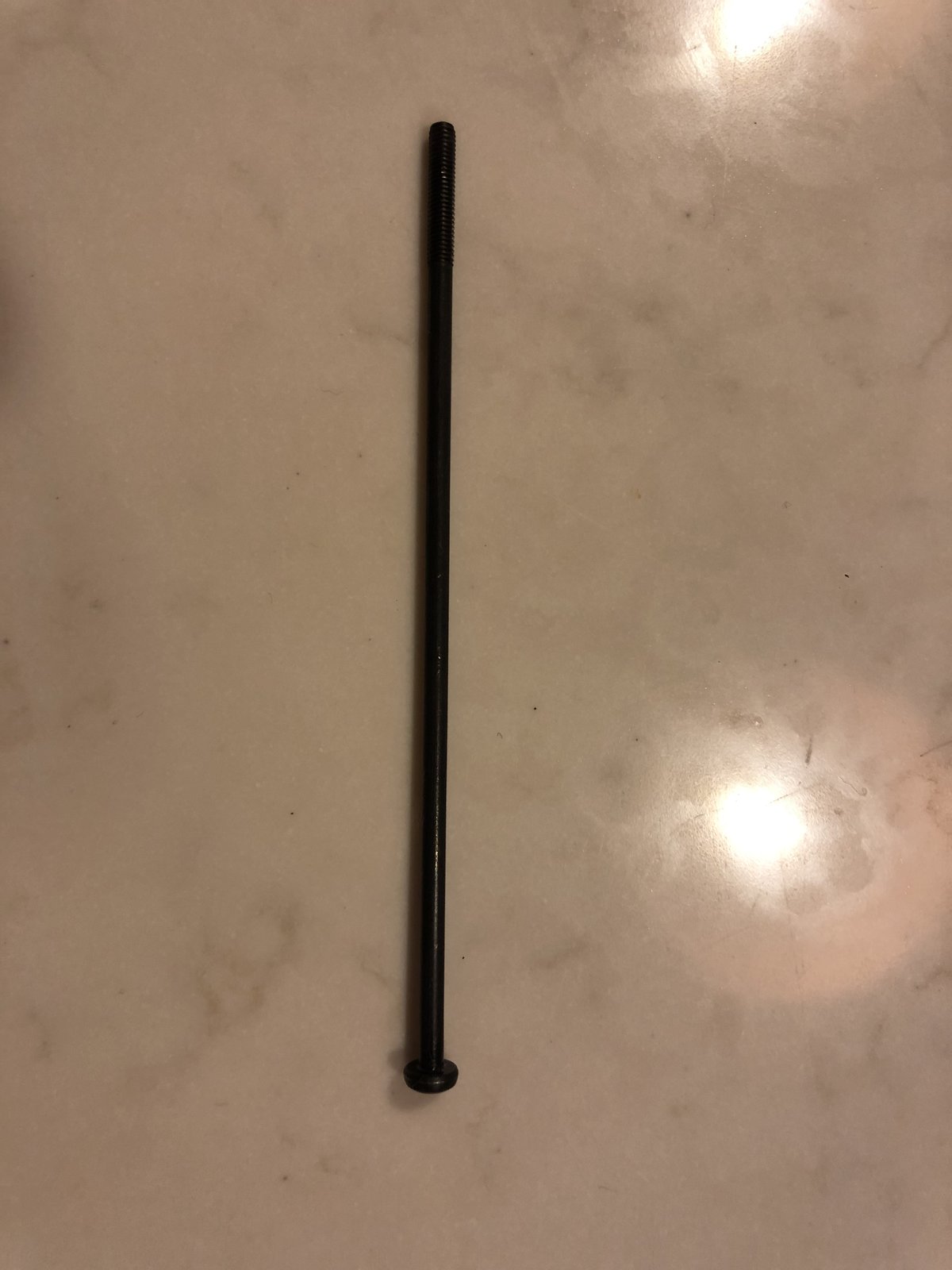

  13. After putting all the tools away just now and putting left over bolts on one side I ended up with this long screw on the floor. I don’t remember pulling it out of the bike. Anyone recognise what can it be? I am hoping it’s just fall out of my tool box as I have no idea where it could have come from on the bike?
    Approx 4 inch long? C6FDC7DC-7A9A-4C1B-A1C7-D80EDC3E017E.jpeg 1633F410-49BE-4A8F-8F98-88D7DDFFA6A4.jpeg
  14. Do you have sliders/frame mushrooms fitted?
  15. Nope
  16. fan housing screw?
  17. yes, I had to take fan housing off the bike, but I don't remember taking this screw out? where in fan housing it would be from?
  18. without looking at my own bike, you split the fan housing, and there are screws used to secure the 2 halves, maybe one of them, or the flaps on the top on the fan shroud have a long metal part to them..
