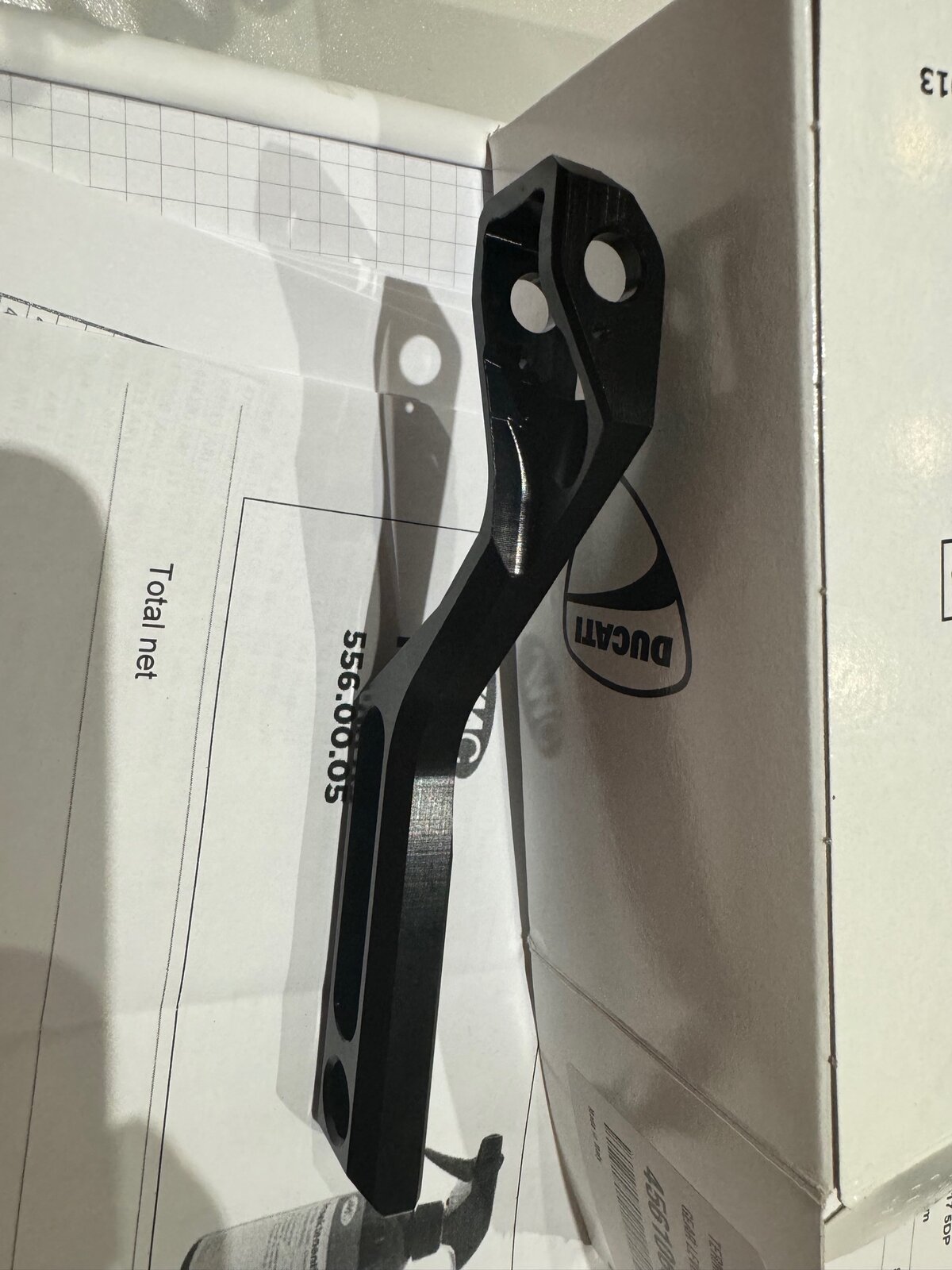

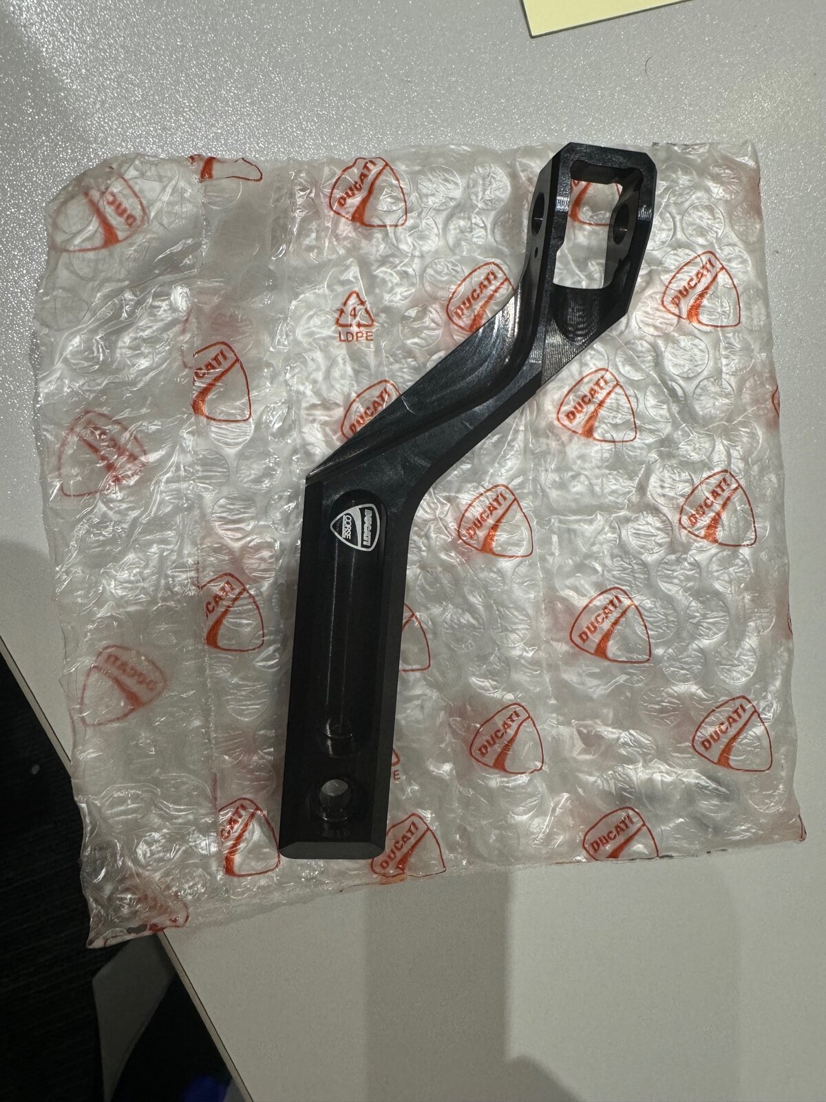

  8. 78CCEED6-0BC6-4BBF-AC12-CEDAB930C938.jpeg AE4B0F29-D004-477B-A6A7-01B9864CCCC5.jpeg Received a call from Ducati Cardiff with not good news. Gear lever (£208) has turned up but there is a small issue. Not hard to spot. More calls to come. Nothing is ever straight forward for me.
  9. You didn’t expect to get the peg and all of the associate fixing paraphernalia included for £208, did you? Silly boy! It will be at least another £200 for the associated bits. Ducati rear-sets. Reassuringly expensive!:cool:
  10. £208! Robbing bastards. Plus you have to pay for the toe peg too? Thats just nuts. Fuck Ducati.
