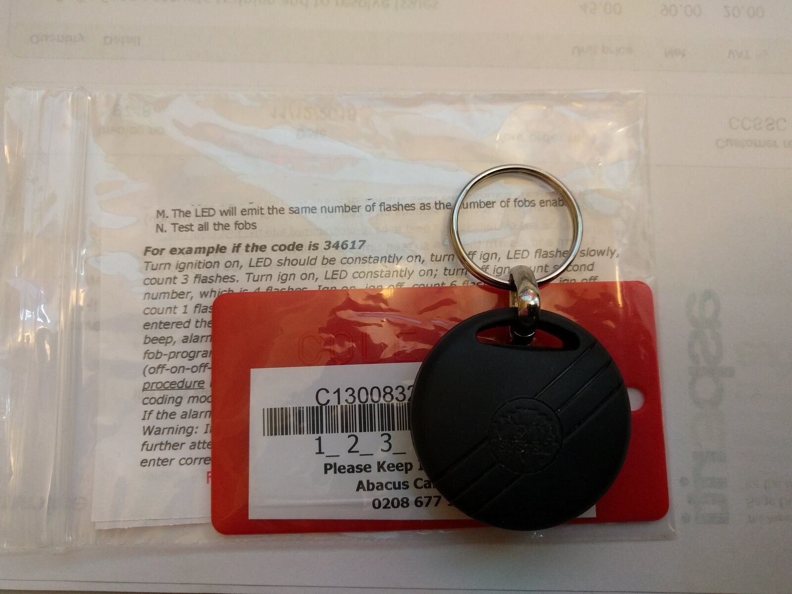

  3. Abacus have just emailed to say that my replacement Meta fob is on its way, so no doubt I'll have fun coding that to the Meta as well, they say they are including instructions!!

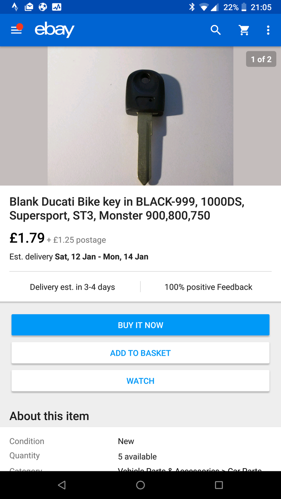

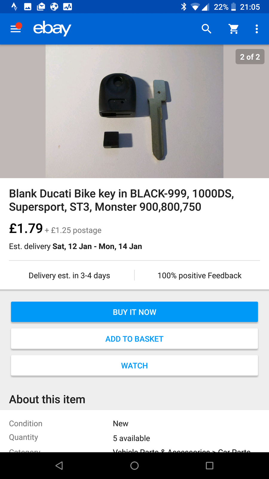

  6. Buy cheap black key off ebay (no more that £3). PM me your address and I will post you a transponder. Fit transponder in key and program to bike. Sorted.
  7. Sounds good to me.
  8. Chrisw, that's very good of you, will this do for the blank? I assume the transponder inserts in the rectangular recess? Will pm my address if this is the one to get. Screenshot_20190109-210542.png Screenshot_20190109-210522.png
  9. That will be fine. The small piece of plastic in the picture is the tray for the transponder.

  13. Thanks @chrisw just what I needed....
  14. Looks like you're all sorted :D
  15. Yes, parts OK, just a bit nervous now about coding both the new key transponder and the new Meta alarm fob!! Looks like it may be a bit of a fiddly process for both. Anybody got any tips apart from follow instructions, watch the videos and be careful?
    BTW, brilliant service from Abacus Car Alarms https://abacuscaralarms.co.uk/ - brand new Meta fob ordered yesterday, arrived this morning!
