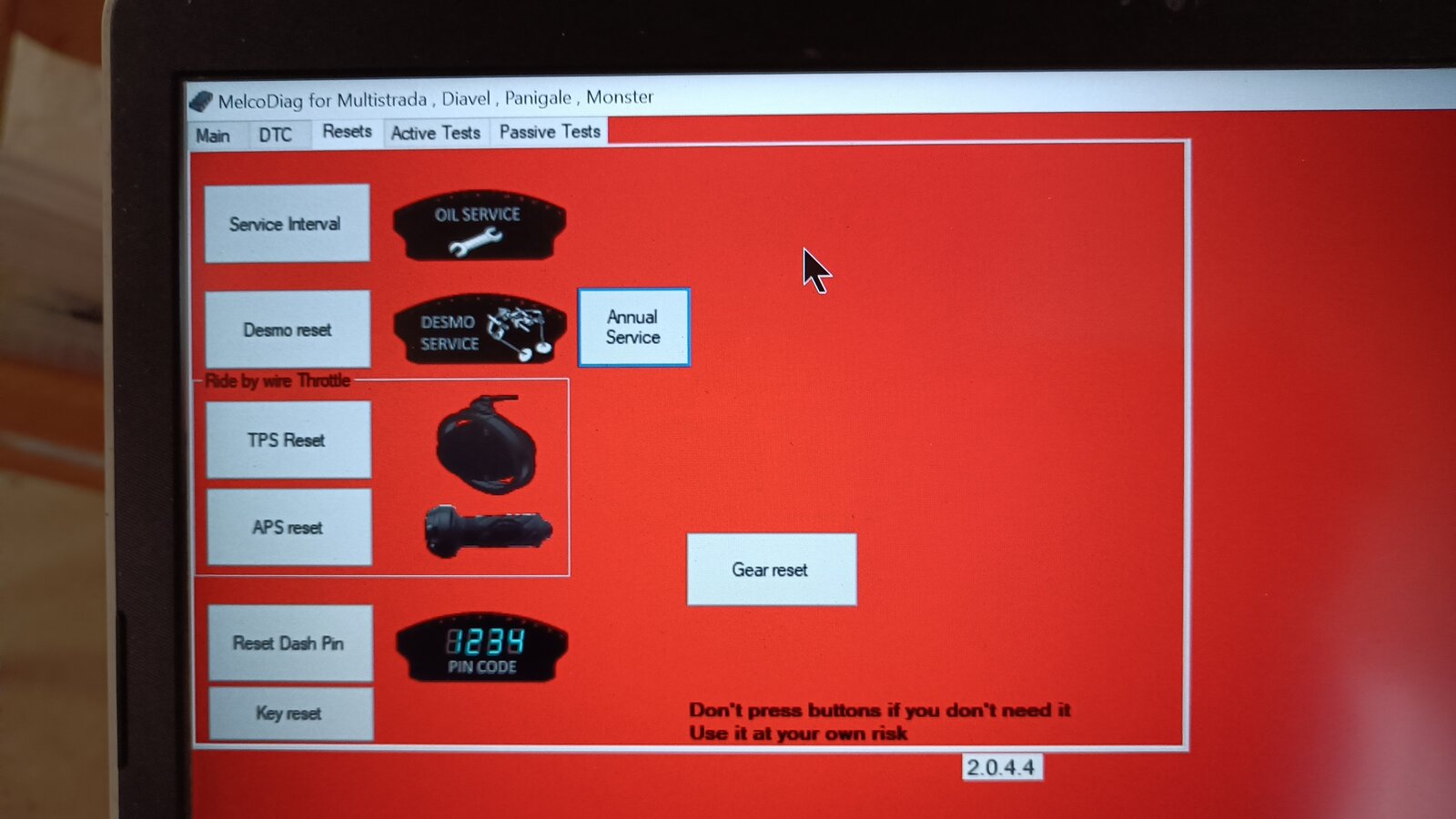

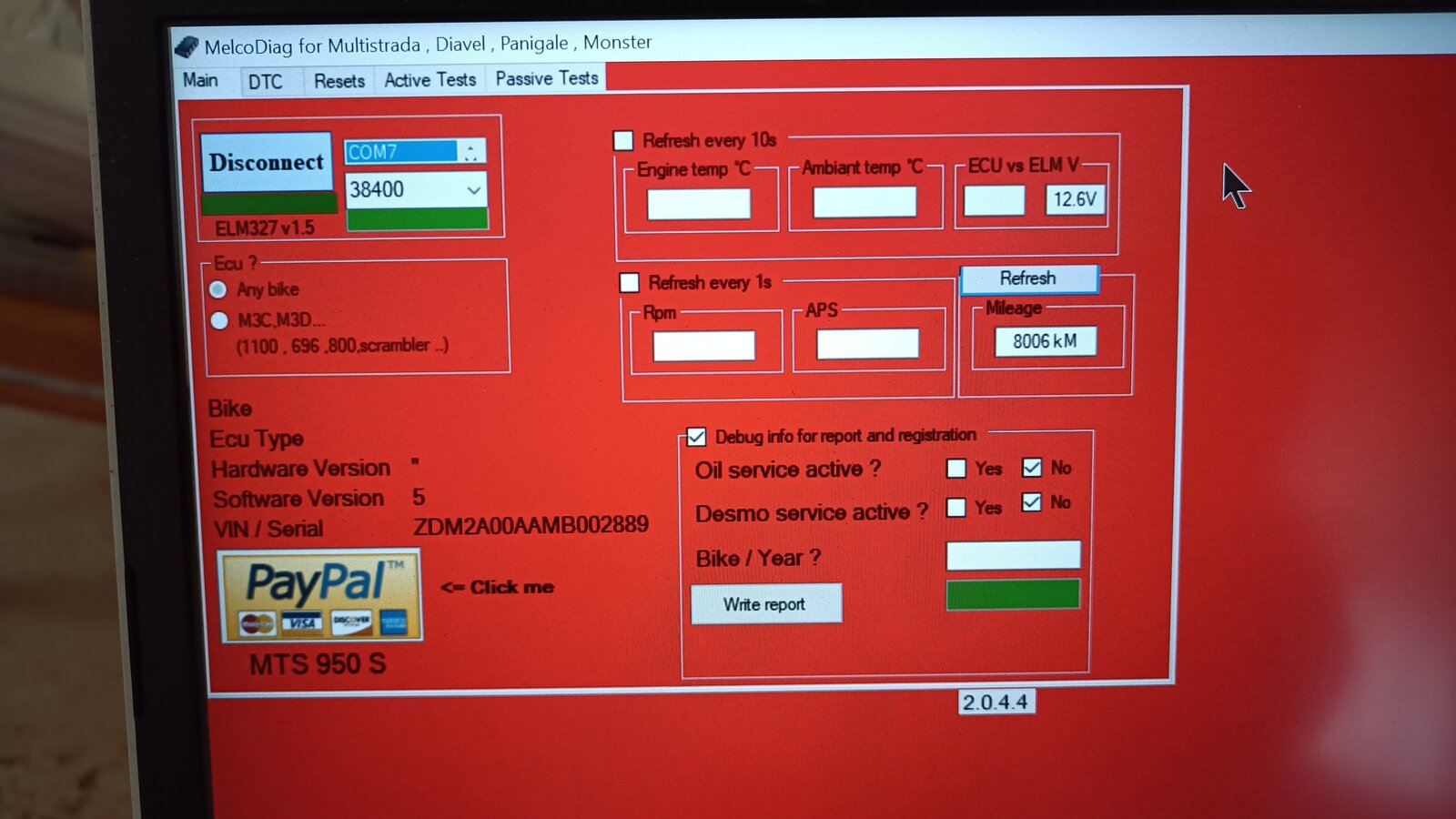

  2. You download and run the MelcoDiag app, and once connected to the bike the app will read the relevant ECU data and fill in the blanks. Manually fill in email and other relevant data regarding active lights etc.
    Once you've done that, click "write report" and it goes automagically to JP, who replies to your email with a small license file. This file you place in the same folder as your MelcoDiag software.
    Now you connect to the bike again and...voila...now you can do things! :upyeah::)

    I have the correct 4 pin adapter, downloaded melcodiag successfully, used an elm327 scanner and written the ecu dump and tried to submit it all, to get the licence. Everything connected properly between the bike, the scanner and the software.
    However, when I tried to submit the application, it didn’t work and the pop-up said that details were incomplete…..either the wrong software or connector had been used!
    Bike is a 2015 Multi 1200…Any ideas……before I fork out for an OBDSTAR i-scan???
