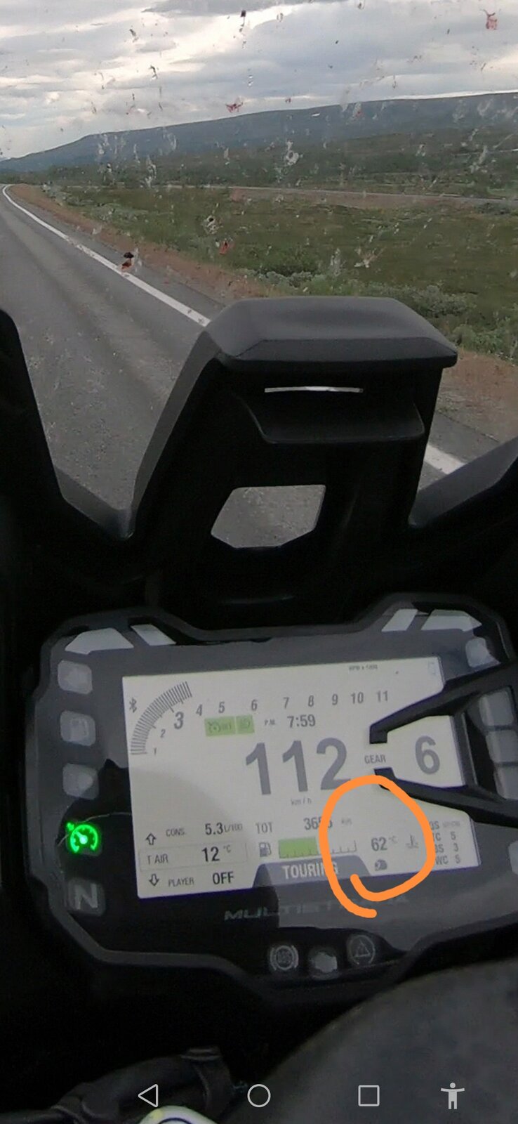

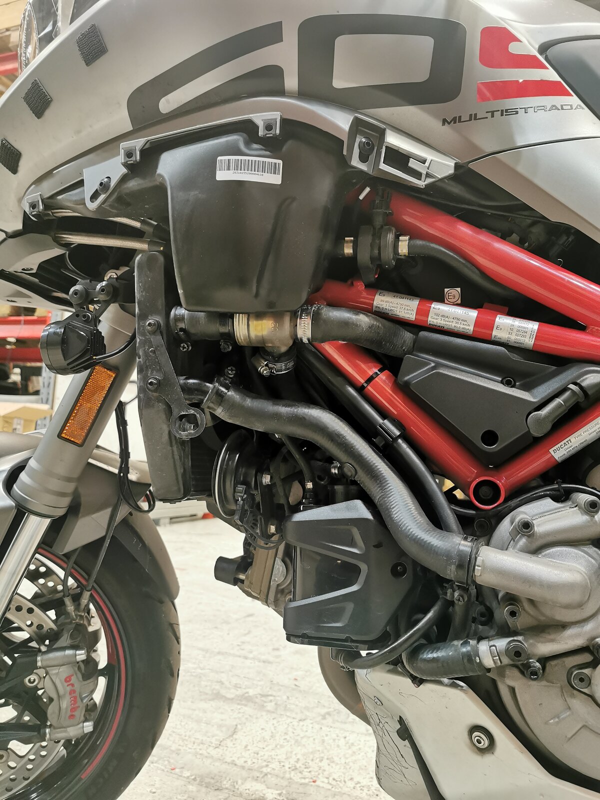

  6. I run MS 1260 s gt which runs at low temperature.
    I have developed a new thermostat housing with a replaceable thermostat.
    Now I drive with a 70 degree thermostat and the engine runs better with a slightly higher temperature. Should switch to 80 degree thermostat which I think will work perfectly in our climate.
    Usually covers the radiator, but then it will get hot with city driving. It will be unnecessary with this thermostat housing;)

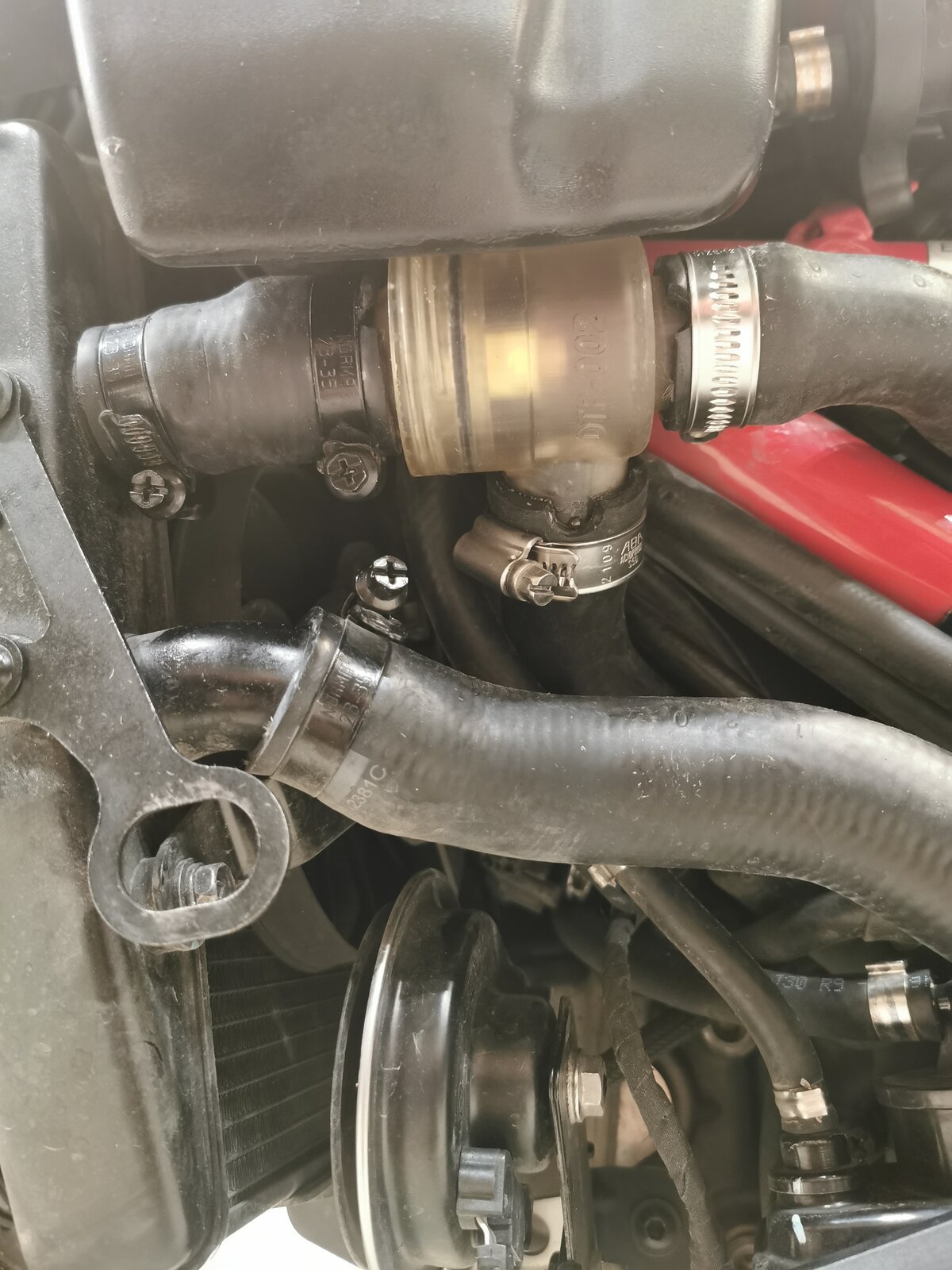

  11. This is a prototype, the product has the same dimension as the original part. Just loosen the clamps and replace with the original thermostat housing. Thermostat can be bought on ebay, AliExpress ...
  12. Thank you Kjell,
    You say "this is a prototype" is it something that you have made? or something adapted from another piece of plumbing? I see the embossed lettering DT 002 but haven't found anything similar on the net.
    Please enlighten us further.
  13. Looks like this is SLA - yes?
  15. Actually, it looks like it reads DTR 002
  16. So if you replace the original housing with this one, what is different about your part? What does it cost compared to the OEM part?
