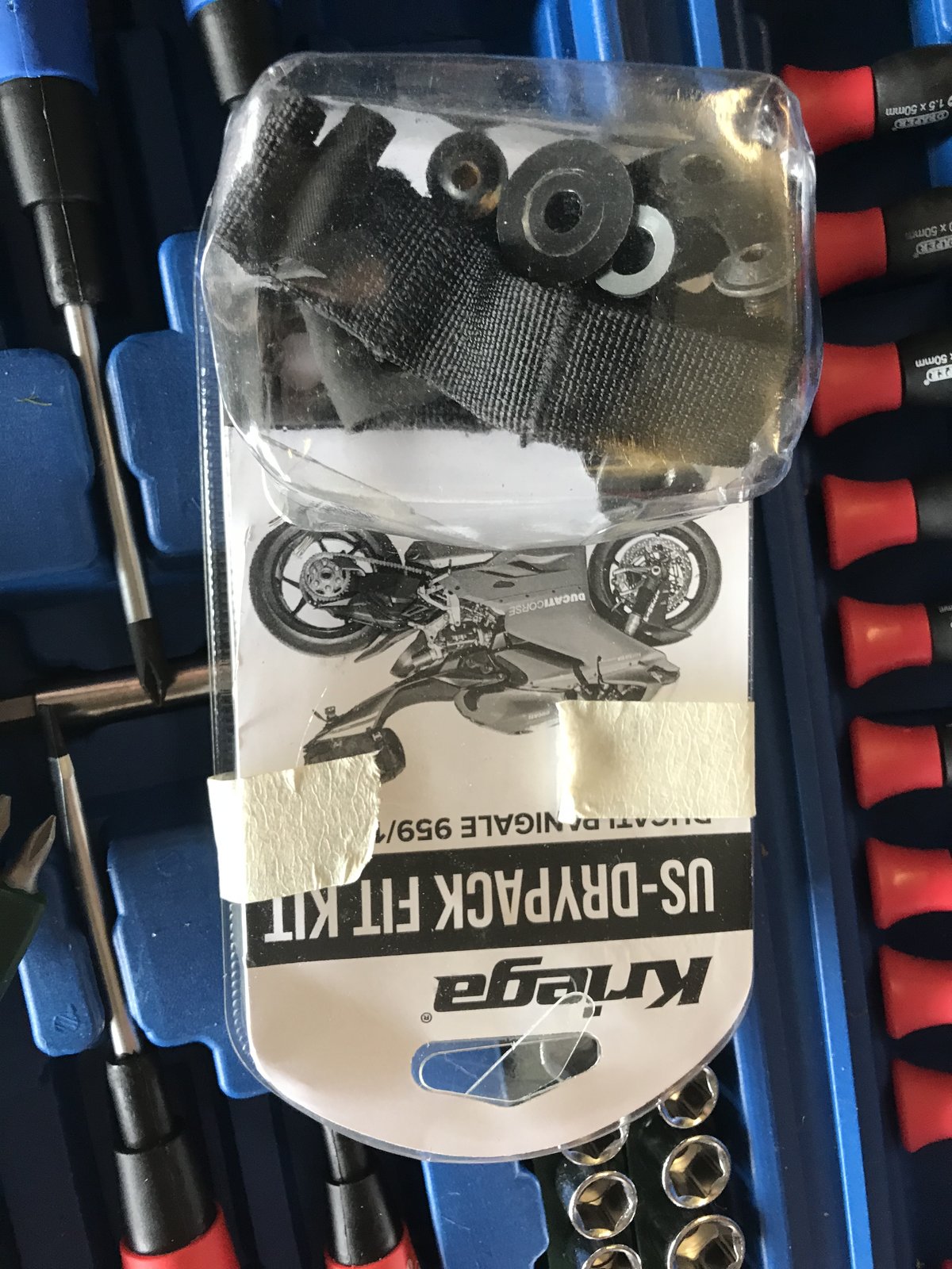

  1. Fair play! When i spoke to Kriega they said thats its really difficult to get something sorted. Did you go straight under the pillion seat and tie on the sub frame? Can you send any pics of where you attached it to? I haven't had a look yet as don't have the bike so any advice would be super helpful. Did you ride out to Italy for the GP? How did you find it touring on long rides?
    Thanks again for your reply!!

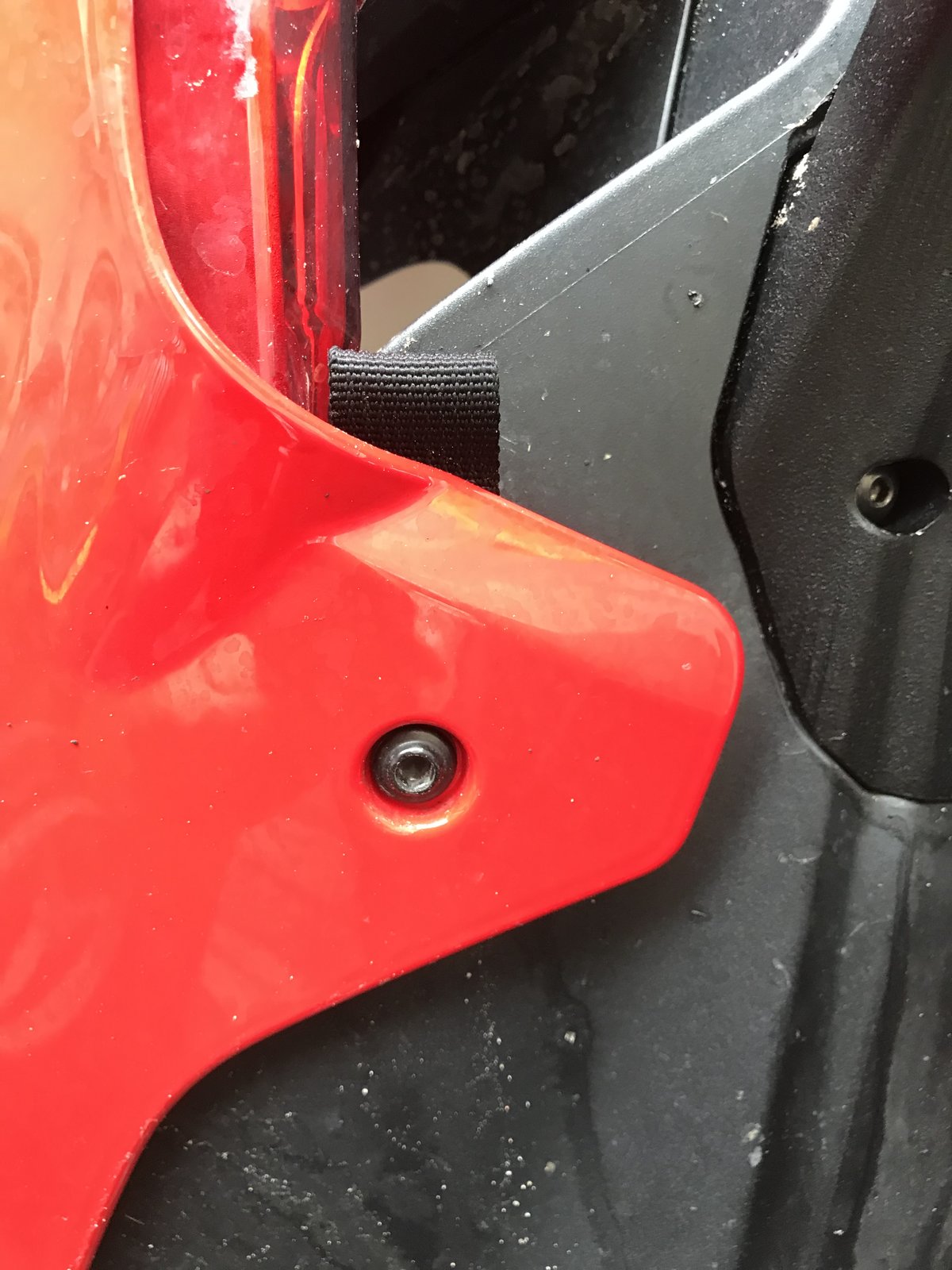

  2. I'm on a tour as I type and taken in a few stops including all the Mugello madness! As I'm on the road, I can't provide you with any pics and in my case I slid the nylon loops beneath the pillion seat, clicked the seat back into it's place and pretty much good to go.

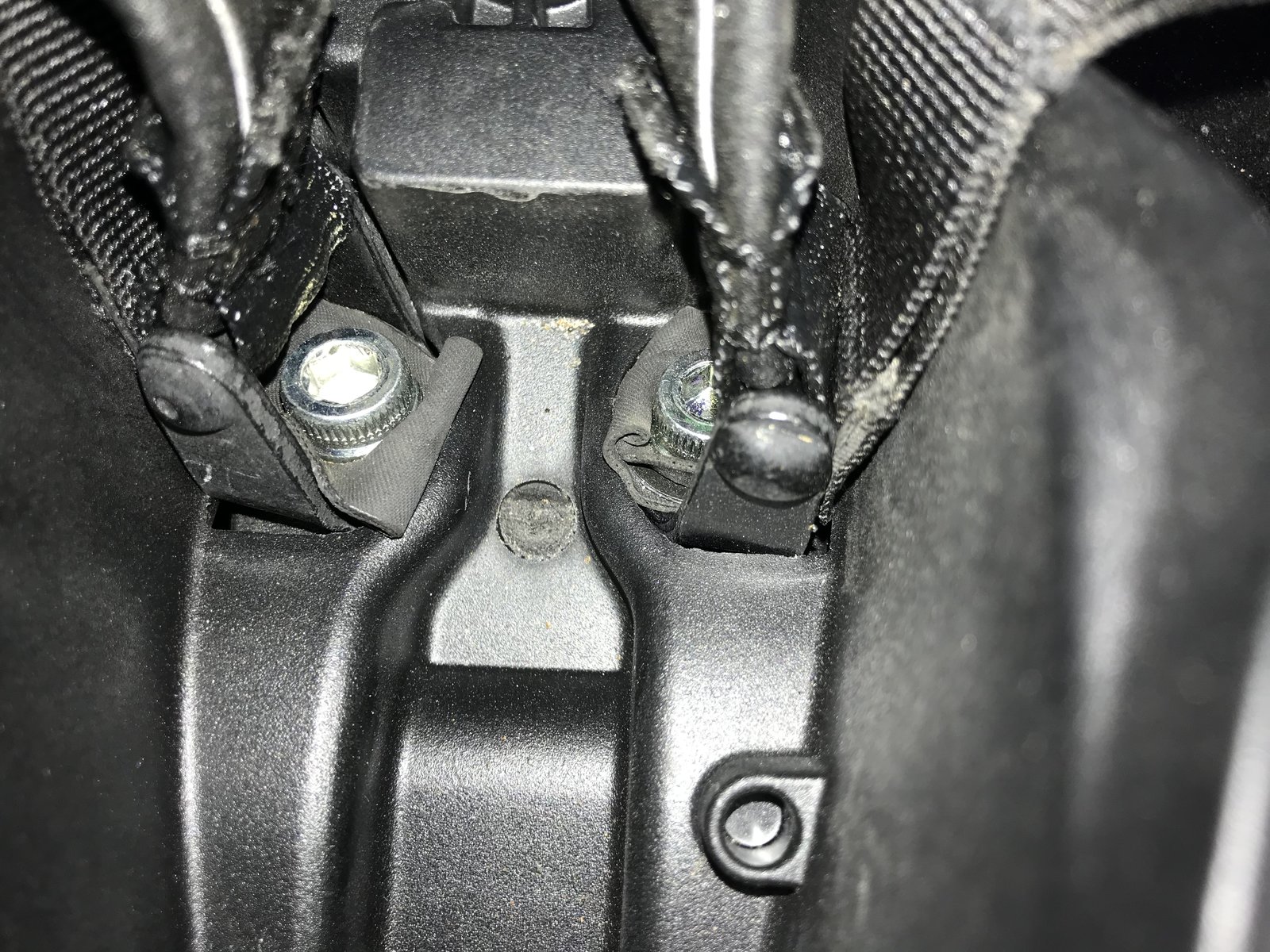

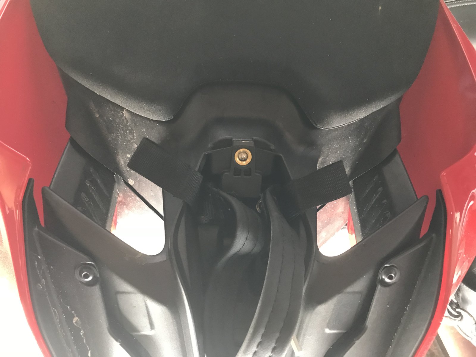

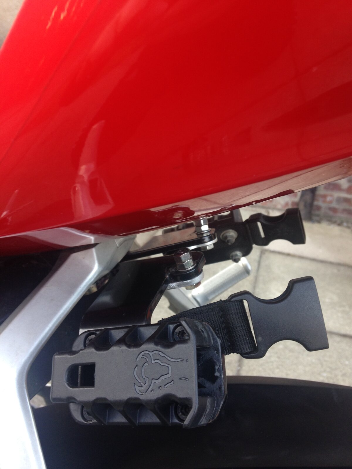

  3. Here is the setup I did for Le Mans, long ones attach to the pillion strap and the then shorts ones attach under the rear fairing that you screw on for the pillion seat. Never budged an inch.

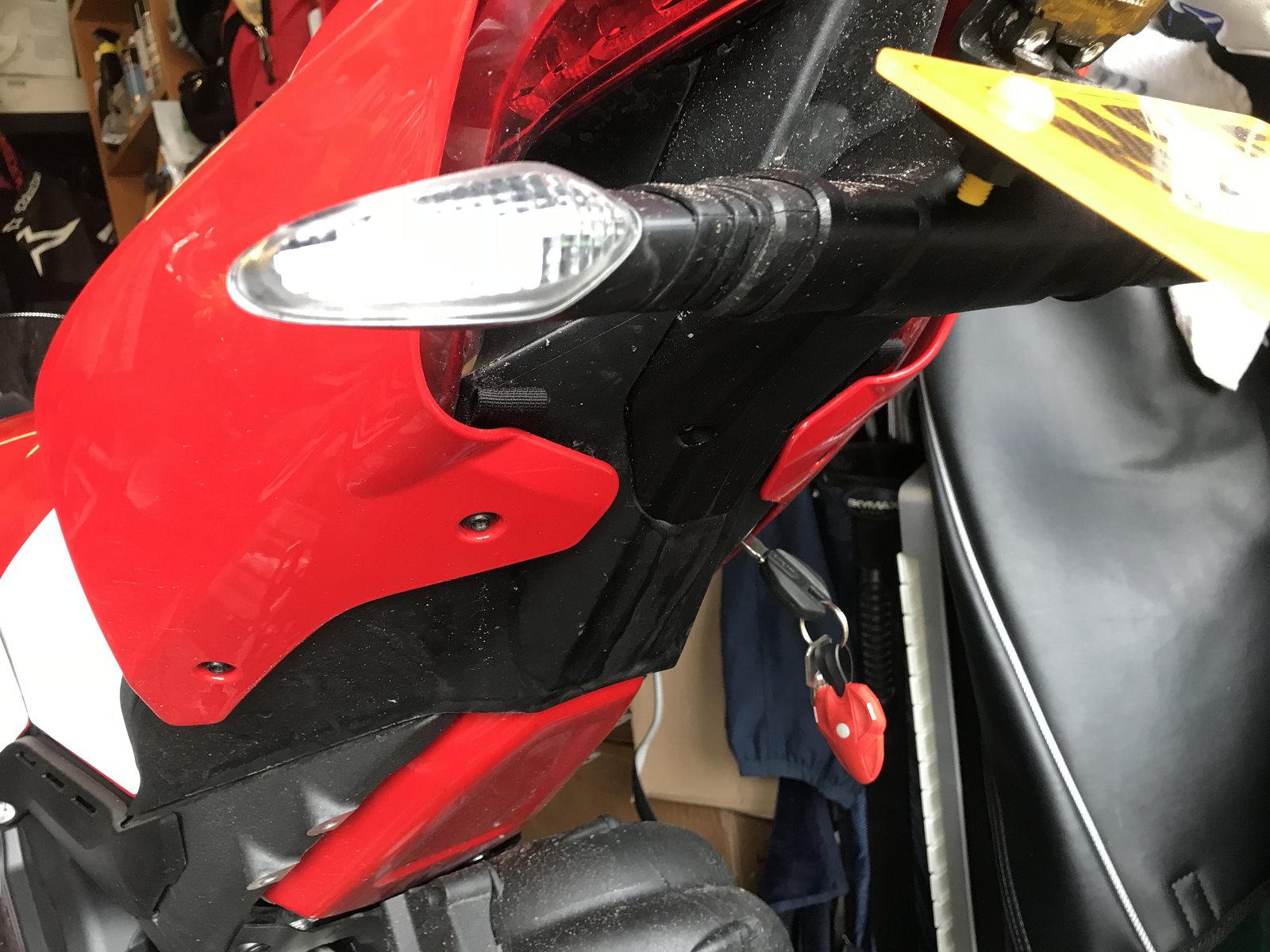

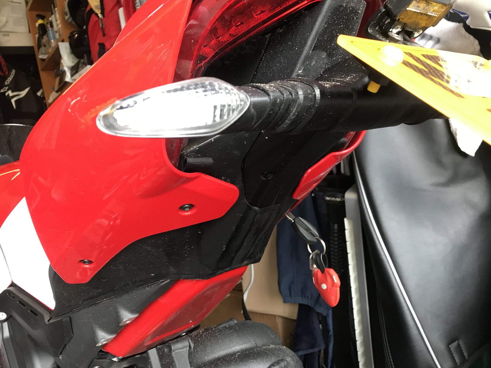

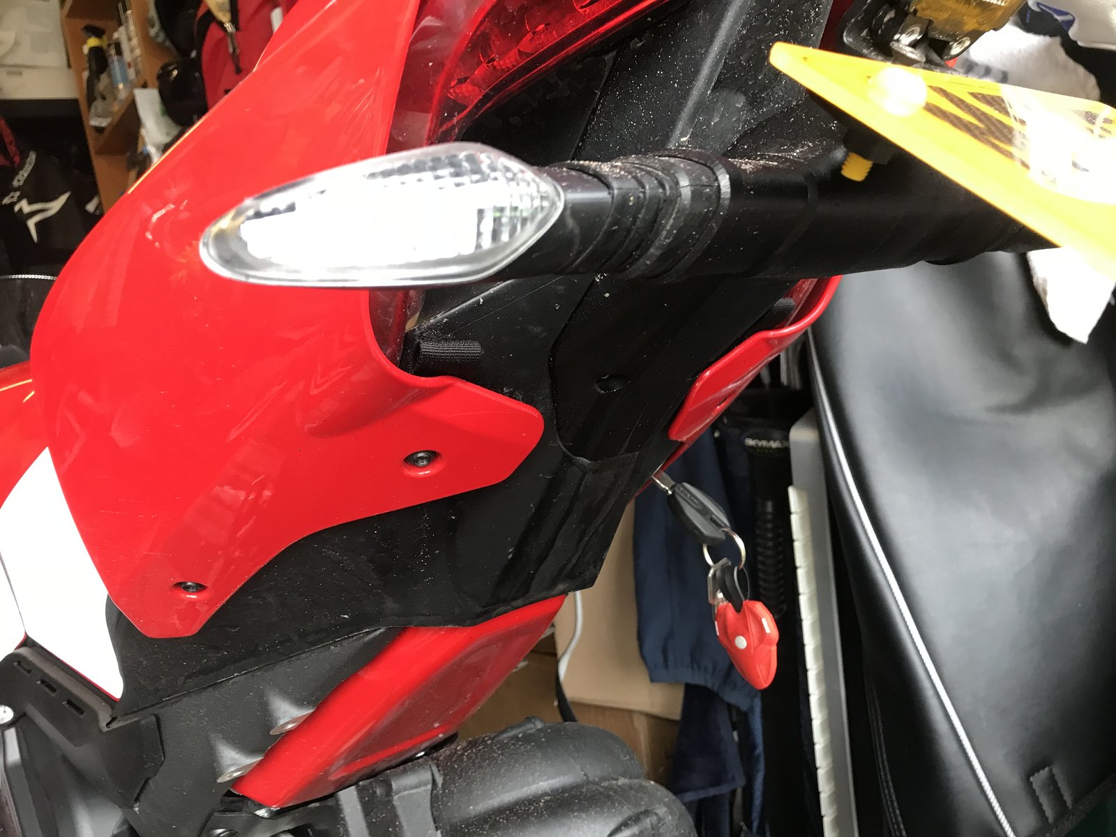

  4. I bought Kreiga kit for my recent trip and both the 20lt and 5lt (I packed pretty light!), let water in... anyone else had this experience?
  5. I have a 20ltr and last year I got soaked to the skin on the way to Le Mans, rear lights were doing a dance for about 3 hours till they dried out. All my kit was bone dry although it was packed. Maybe that made a difference
  6. Both of my dry bags were full, strapped down pretty tight, internal bags all in place properly. Bit gutted, fitted really well on the 899 and had high hopes what with all of the positive reviews. Sportsbikeshop.com have kindly said to return them so will be doing so soon.

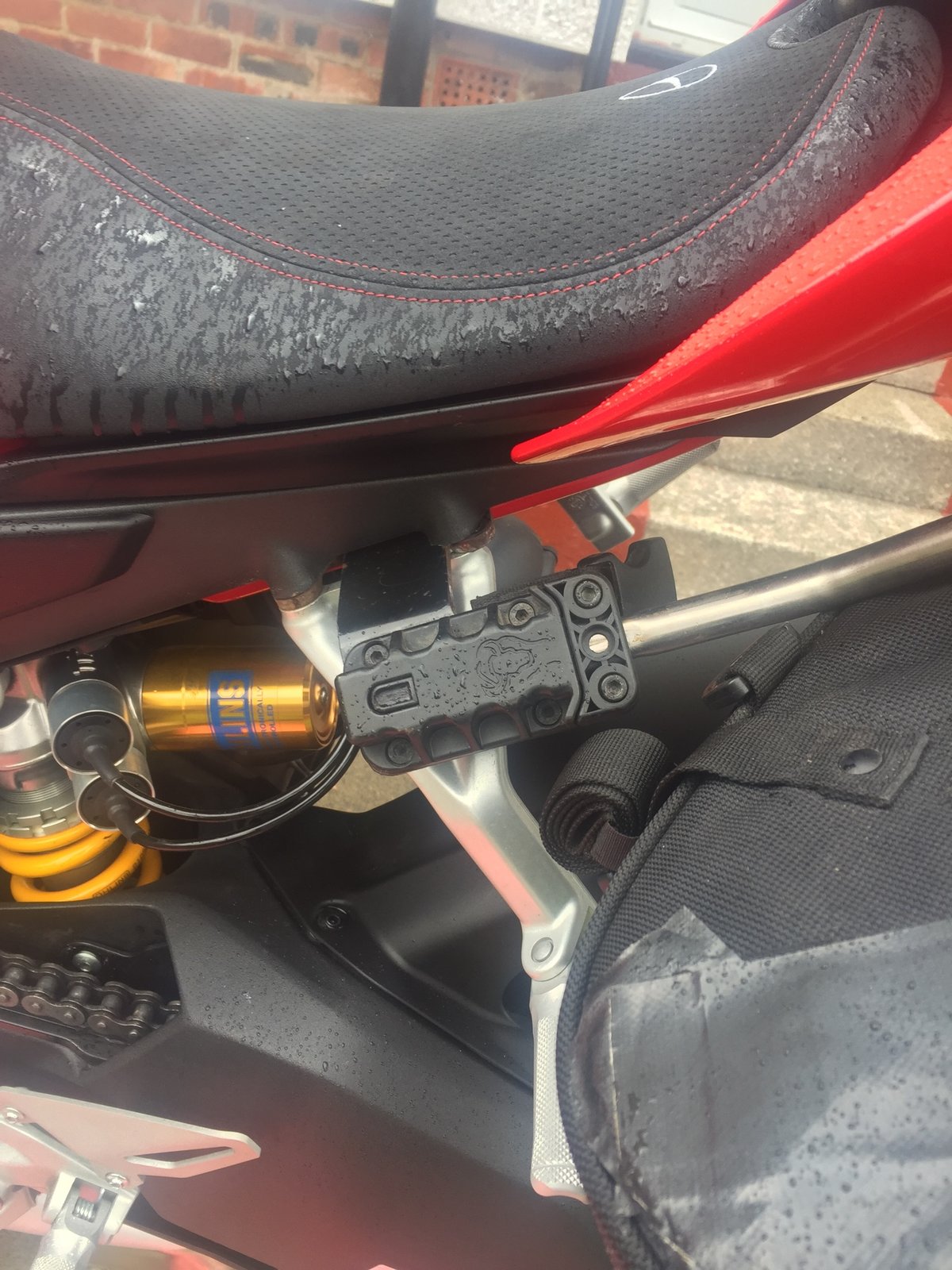

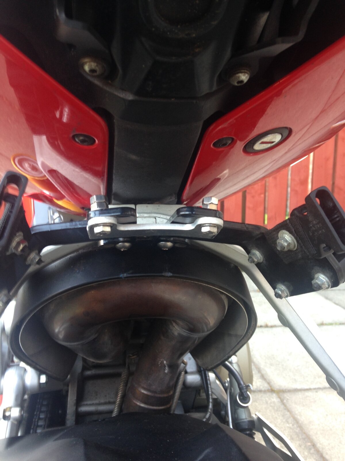

  10. Thanks for the detailed photos - Very useful. Are the 4 straps included with the Kriega 20L bag or did you purchase them separately ?
    I am working with a friend on making an additional plate to attach to the original 1199/1299 mounting kit to see if I can use the SW Motech Panniers and will upload some photos and details if it all works out (Might be useful for other folk switching from 1199/1299 to the V4 and want to use their original SW Motech luggage)

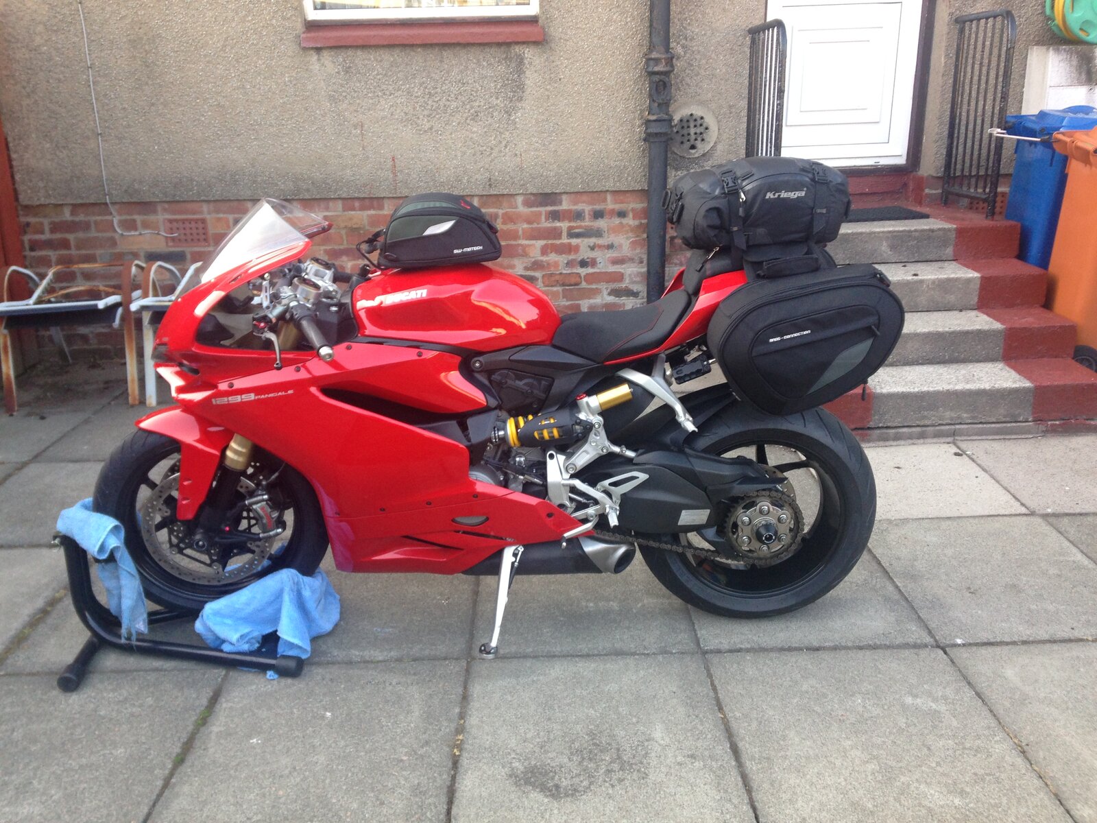

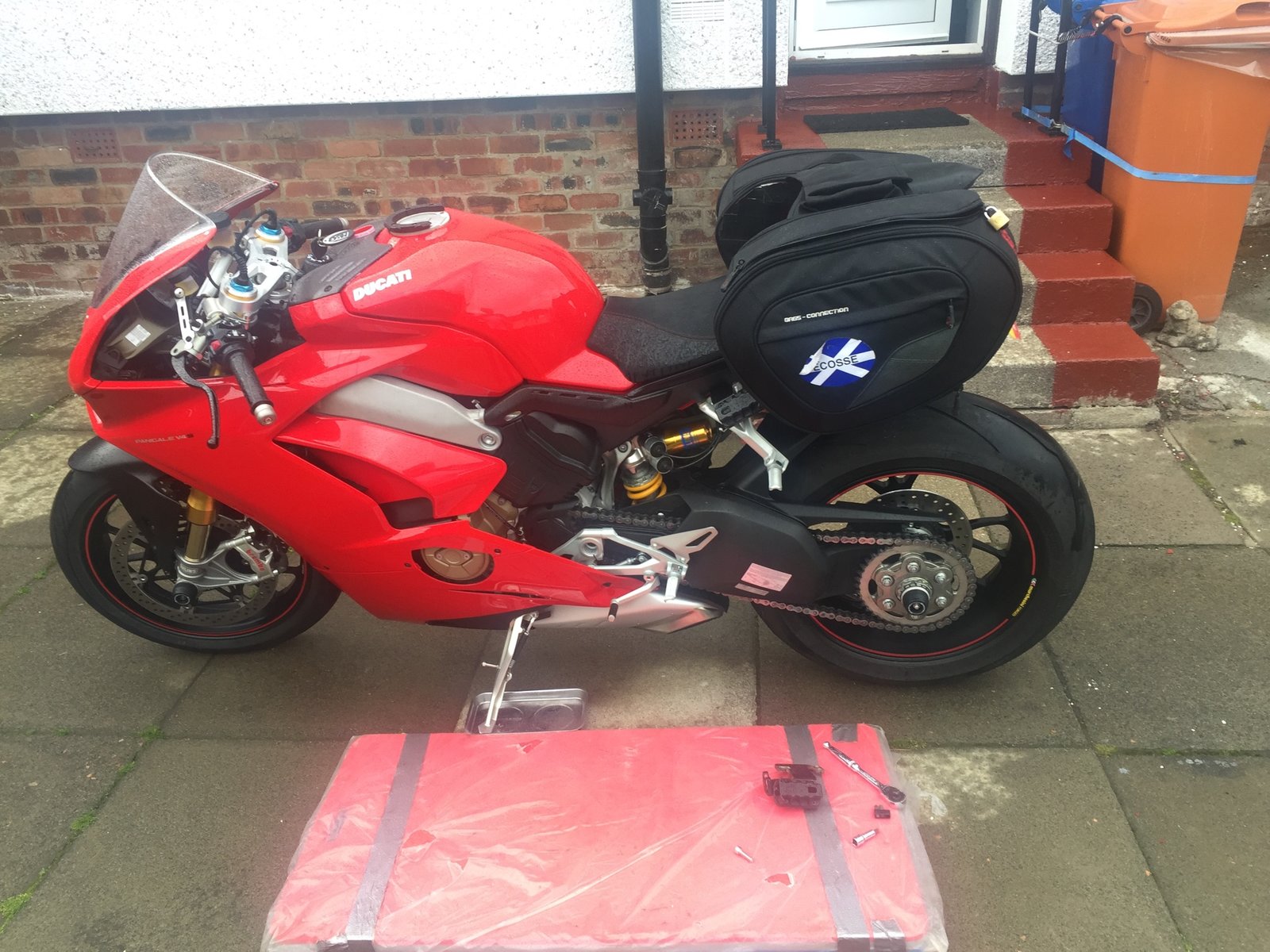

  14. I just drilled the brackets from my gsxr1000 and cut the arms smaller

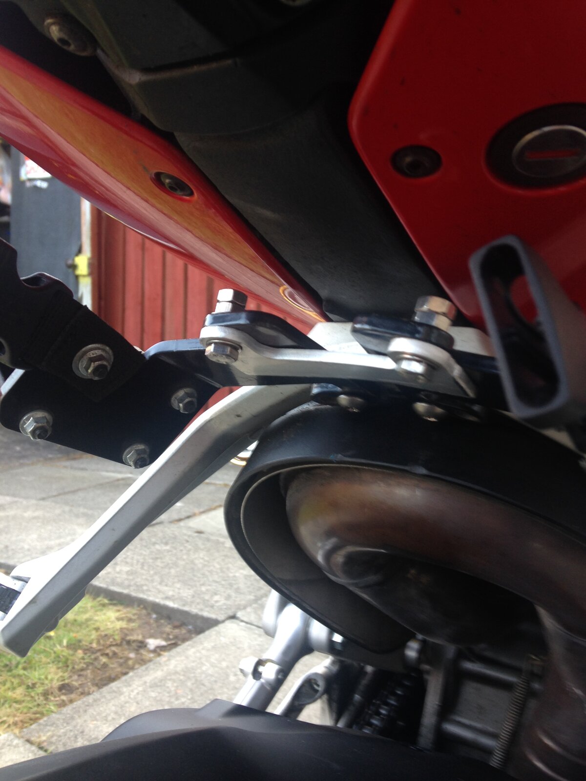

  16. Hi Cul
    The 1199 Kit will fit but it is a little tight to the heatshield of the exhaust, and you may need to angle the bolt at a slight angle to beginning with to get it to take, but I did not have to take the heatshield off and there was no cross threading as I remove the kit for use with my V4S with a modded special plate that I made.
    One thing to note is that you are aren't able to use the rear passenger pegs with the kit as there isn't enough room to mount them on the 1299 but that didn't bother me as I ride solo on my sports bikes.

  18. THEY WERE OFF MY GSXR1000 K12 I DID A MOD ON THE BRACKET AND CUT THE SIDE ARMS WENT FROM SCOTLAND TO ITALY AND BACK NEVER HAD A PROBLEM HAVE NOW FITTED THEM TO MY V4S
