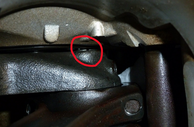

  3. Do you mean the crank plug as in this pic?
    A little tricky to see through the top of the engine but if there's no protrusion, you're probably OK. The alloy 'bits' are worrying though as there aren't too many places they could have come from.

  4. If it's backing out you can just see it. I got a small screwdriver and could just move it, so decision made, split the casings.

  6. That's the one (the big plug that is), I'll still split the cases to check for any damage and debris and whilst there I'll stake the plug for peace of mind.
