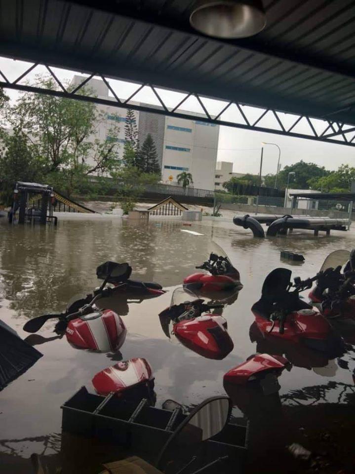

  1. Imagine having dropped your bike in there for a service!!
  2. WOW, that'll be some insurance payout, premiums up next year fellas! :worried:
  3. it was in Malaysia so hopefully won't impact us :upyeah:
  4. That’s heartbreaking
