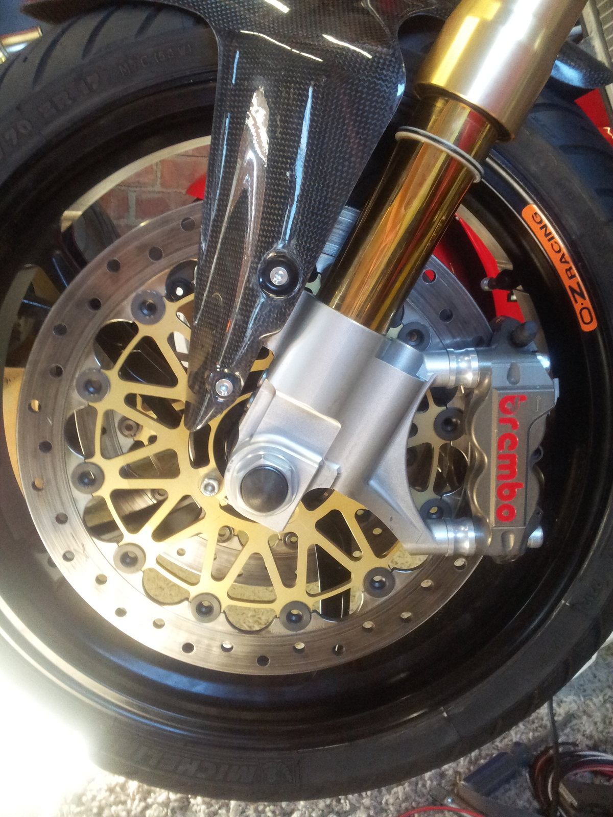

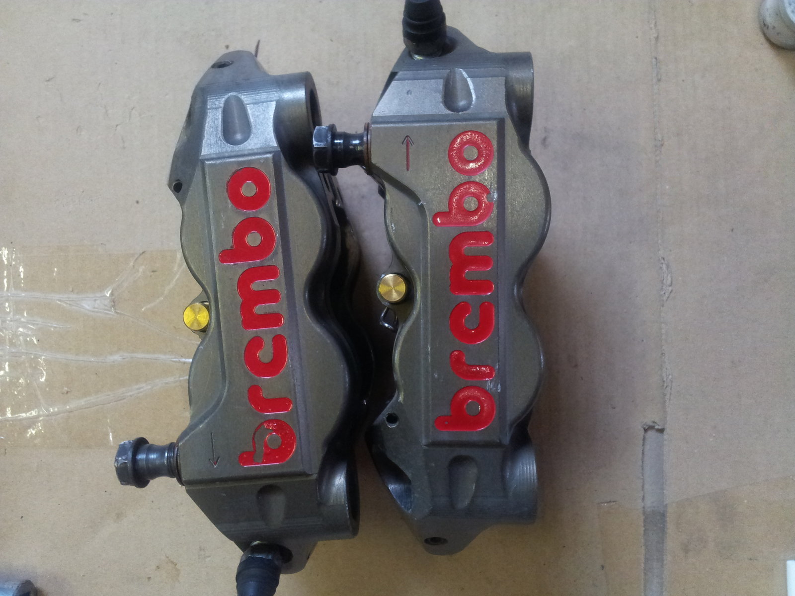

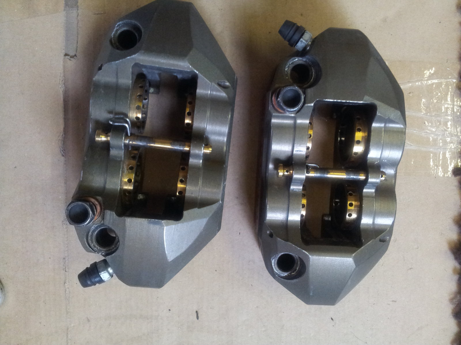

    Here's some brake porn..One of the best systems I have used. Along with a 19RCS master
