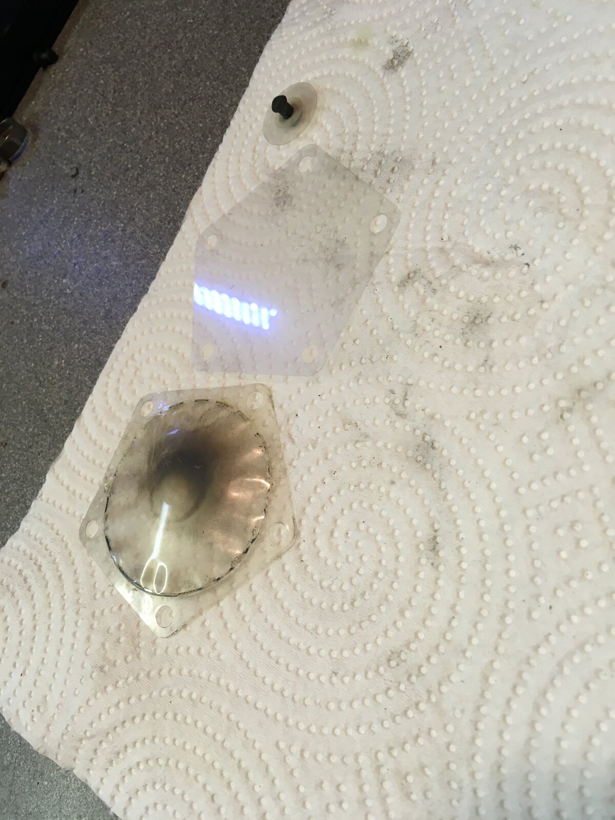

  1. F20611EB-2CE1-42B9-A939-00FC5F84F5B2.jpeg Just serviced the pump, this is the old diaphragm, I do believe it’s seen better days, it’s bowed up about 8mm in the middle and feels brittle, as opposed the the new one which is flat and flexible, unfortunately I’ll have to leave the bike a week to see if it’s made any difference to the “not starting after being left a while issue”.

  3. I have a 1999 M900 and have what sounds like a similar problem for the last couple of years. Starts really easy if it has been running in the last few days. If it hasn’t been running say for a week then it is very hard to start and seems to flood as smell of petrol if using the choke but rarely starts without also. I cleaned the carbs last year but problems remain. I had thoughts that the starter motor was using too much power as when letting off the starter it would sometimes fire. I stripped the motor and replaced the brushes. I thought it was better but problem remains. I have checked the starter circuit and all good. I am wondering again about the carbs and whether I need to replace diaphragm and jets so will be interested as to whether yours is better with new diaphragms. It’s a frustrating problem!
  4. Hi Clive, I’m next starting the bike on Saturday and I’ll post the result on here, I’m a bit dubious as to the fuel pump diaphragm being the fix, the only mechanism I can think of is that the fuel is evaporating in the bowls over the week and the fuel pump is taking time to refill them due to the diaphragm not operating efficiently, seems a bit of a longshot really but we’ll see, sounds like very similar symptoms on your bike, I’ll let you know.
    PS replacing the fuel pump diaphragm is really easy, but put a mark on both halves of the pump before you strip it, I didn’t and then found that the screw holes aren’t “poke yoke” so it can go back together in the wrong orientation for the inlets/outlets, luckily there was a smear of dirt across the joint that I could line up to get the halves in the correct position:)

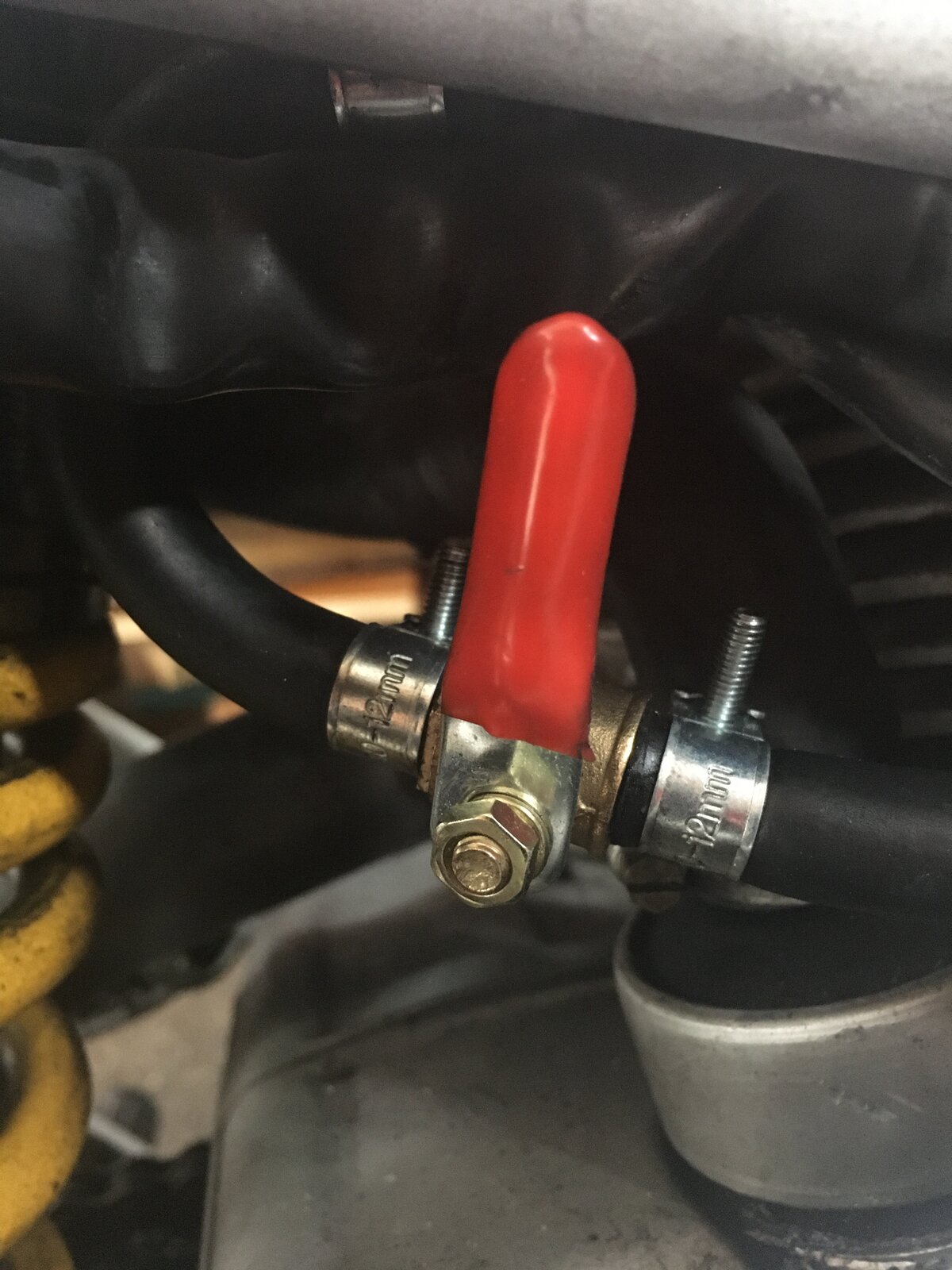

  10. I’ve bypassed the vacuum petcock and installed a manual one in place of the inline filter that I had fitted, unfortunately I’ve now got to wait at least 3 days before attempting to start it again, if it fires right up then it proves it’s the vacuum petcock (the inline filter wasn’t blocked and the vacuum line to the petcock was fine), so if all goes well I’ll just need to get a new vacuum petcock and put it back to standard. CEB3F796-048F-4F17-A3C8-52216A4B3AF9.jpeg

  13. Neat job there.
    If it works and let's hope the wait is worthwhile, I'd be inclined to leave it as is.
    I found the OEM tap on EBay for £19 odd, so good either way.

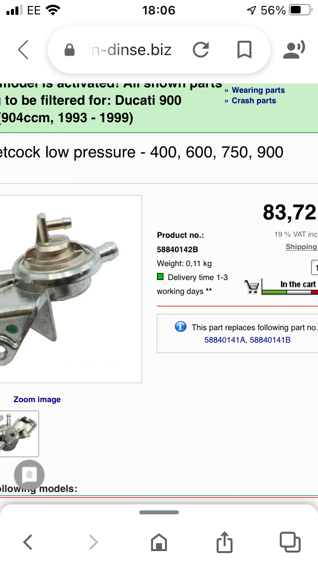

    As regards the OEM tap, I was using 58840051A. There's also 58840071A but I'm not sure what the difference is. The former is on EBay and latter is available from Stein Dinse.
    I like your manual tap though..
  16. Ah right, it’s this type of tap travelling man, at 83+ I think I’ll stay with the manual version, that said I’ve just realised I’ve forgotten to switch the fuel off, so into the garage I go, doesn’t really matter provided the float valves are ok but you never know!, I might try a generic vacuum petcock, they are around a tenner on eBay
