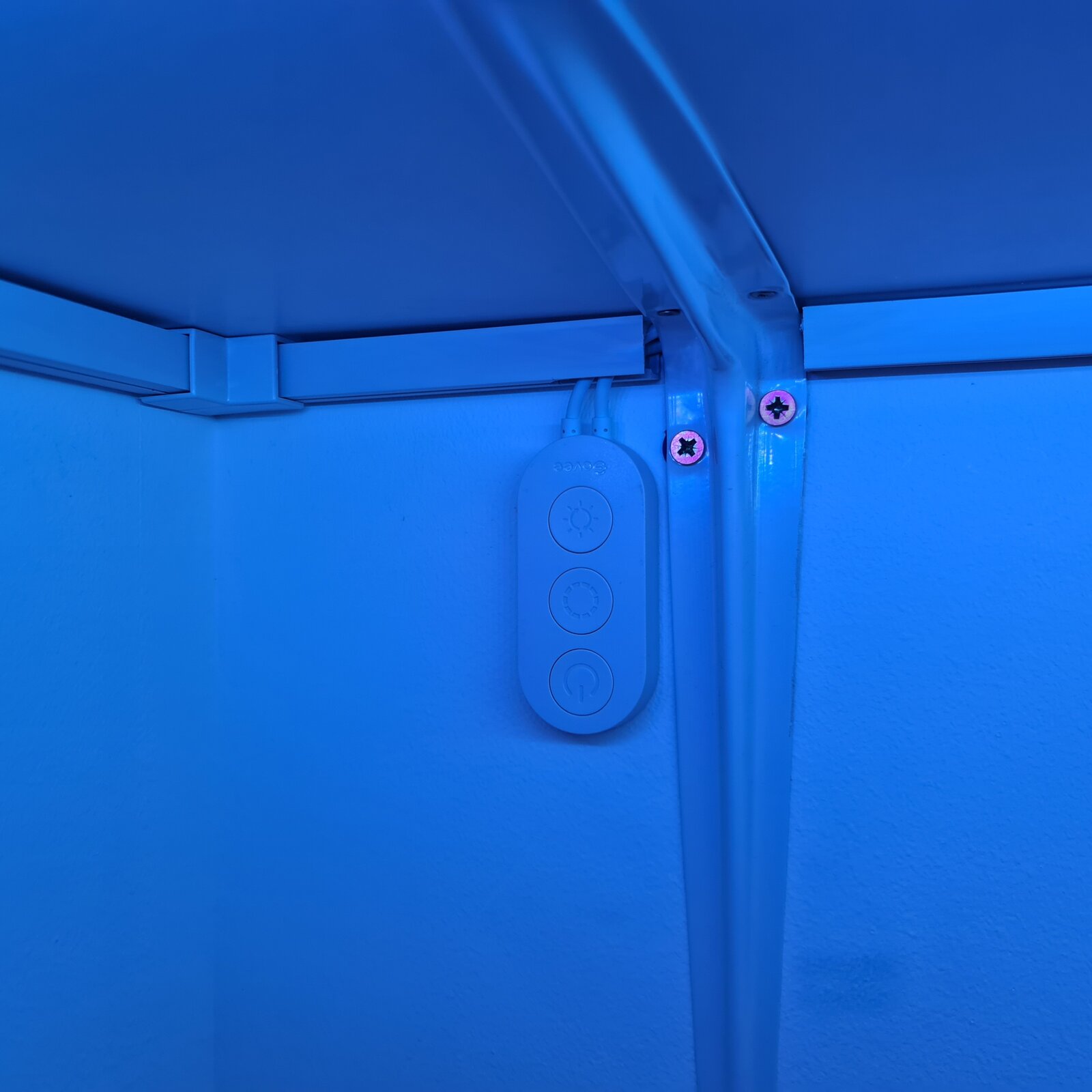

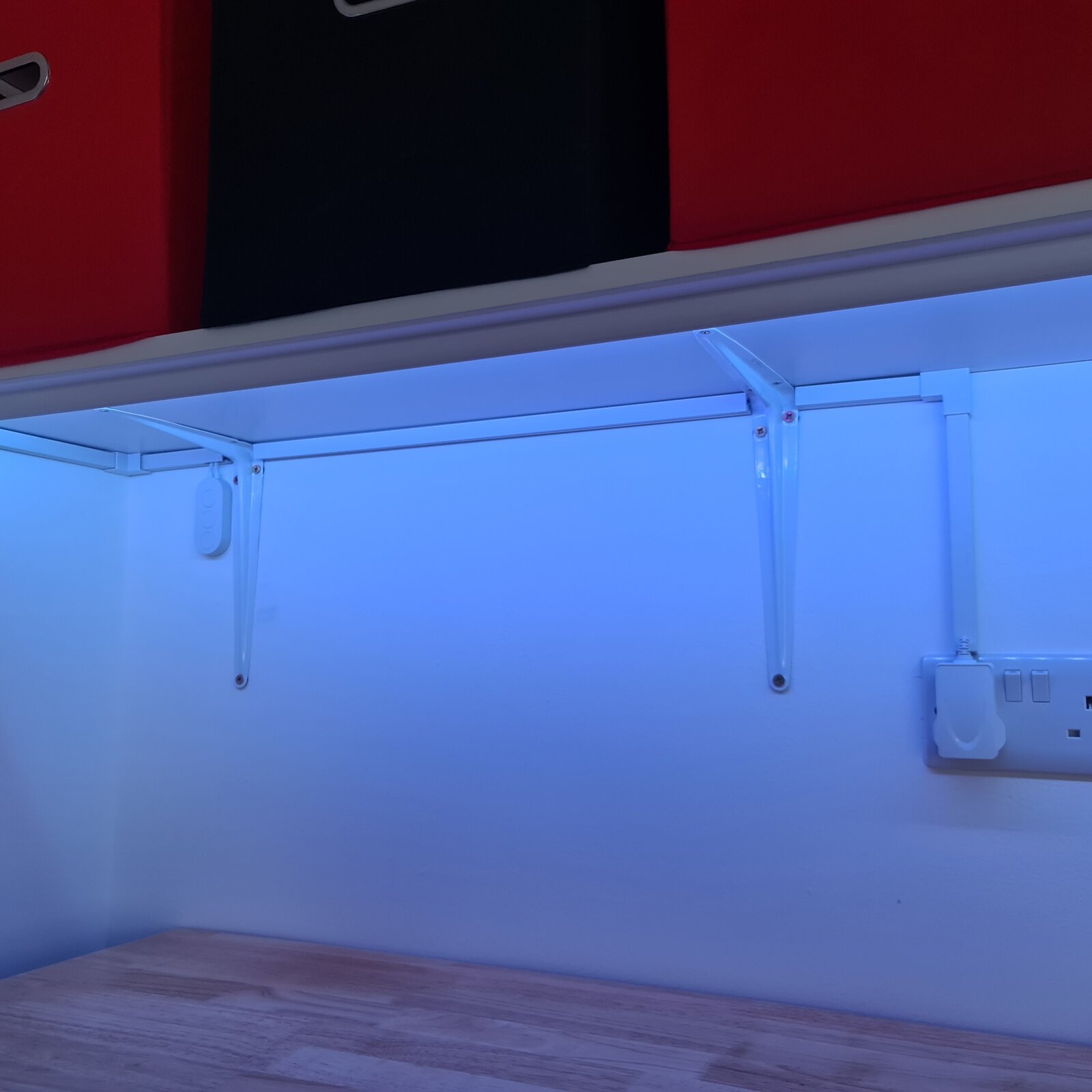

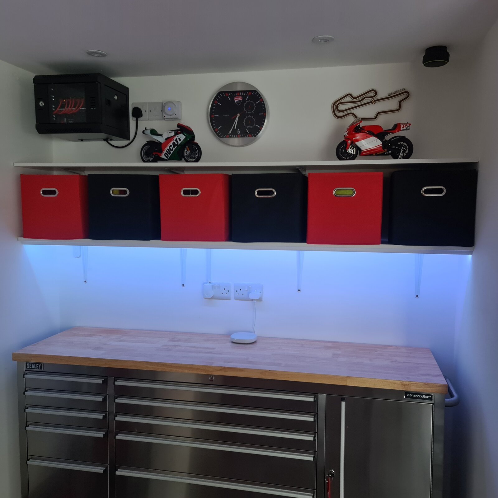

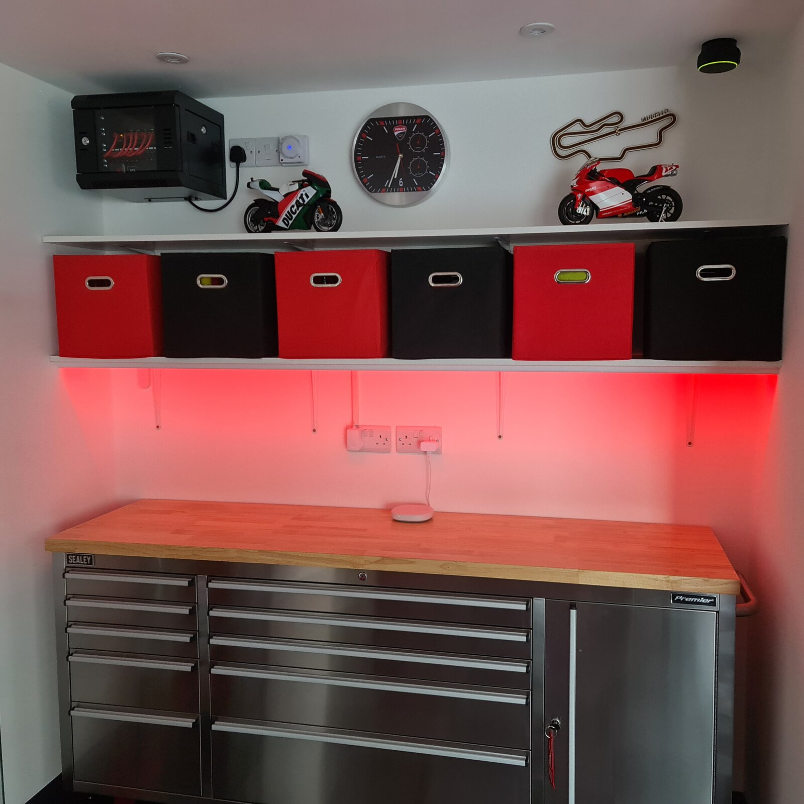

  3. Getting around to completing some of the final fixtures and fittings for the garage. Today was the LED undershelf lighting. I found a perfect solution to hiding the LED strip by inverting a bathroom seal trim and bonding it to the front of the underside of the shelf, this not only hides the strip but directs light back and downwards onto the tool chest and worktop. The hardest job was cutting and fitting all the conduit to hide all the wiring. This is a Govee RGB strip so multiple colours and different modes, so can flash and change colours in time with music, or you can set it to a permanent colour, adjust intensity and of course control it by a timer or to react to another event through IFTT or control it via Alexa or Google assistant. Total overkill when a straight fluoro strip will do, but hey ho.
    Conduit and control panel box (on the left)
    Here is the Control panel, where you can select the lights off or on, the mode you require, or the colour (seen here in blue). I have some white "snap caps" to cover the shelf bracket screw heads, that will go on later
    Cool white is the default colour
    There are 24 million other combos (as with any RGB system) but here it is in red.
    In case anyone is wondering the white box on the tool cabinet is a Smarthings 3.0 Hub, which when I have time, will go into the network cabinet on the wall. It provides Z-wave and Zigbee services to some of the security devices in the garage and work independantly of the CCTV.

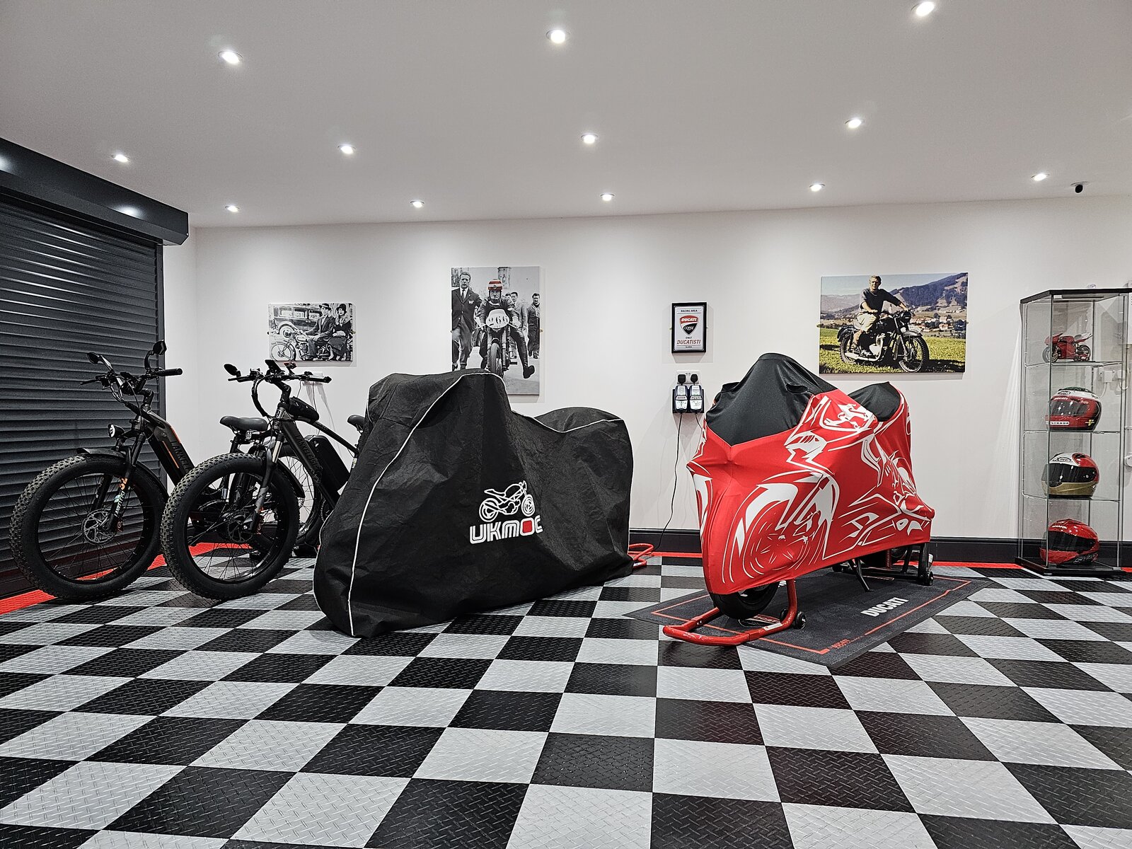

  16. Two new additions to the man cave. Bloody brilliant fun to ride.
  17. I can’t see them, you’ve covered them over.
