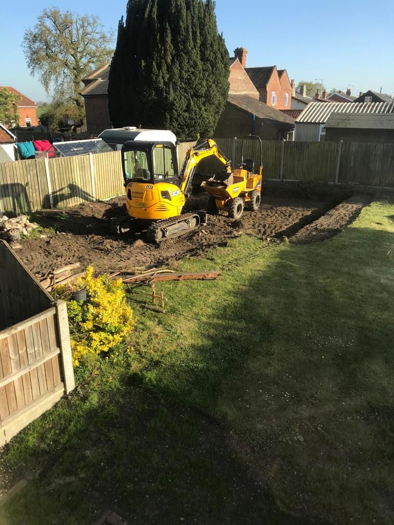

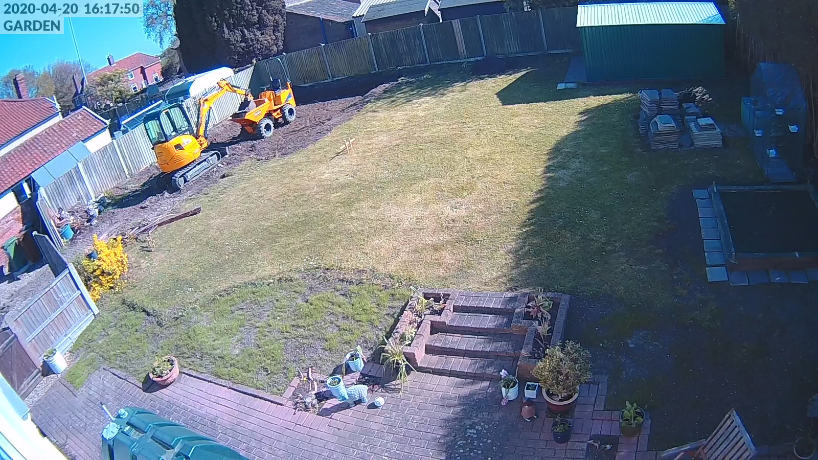

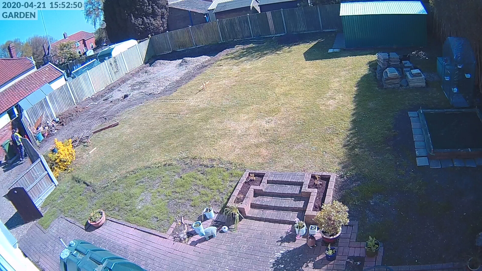

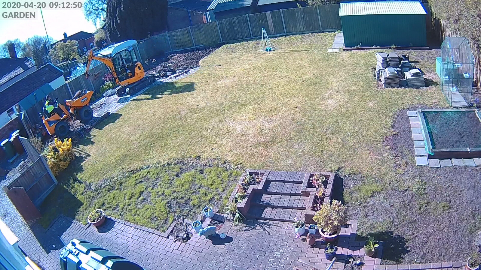

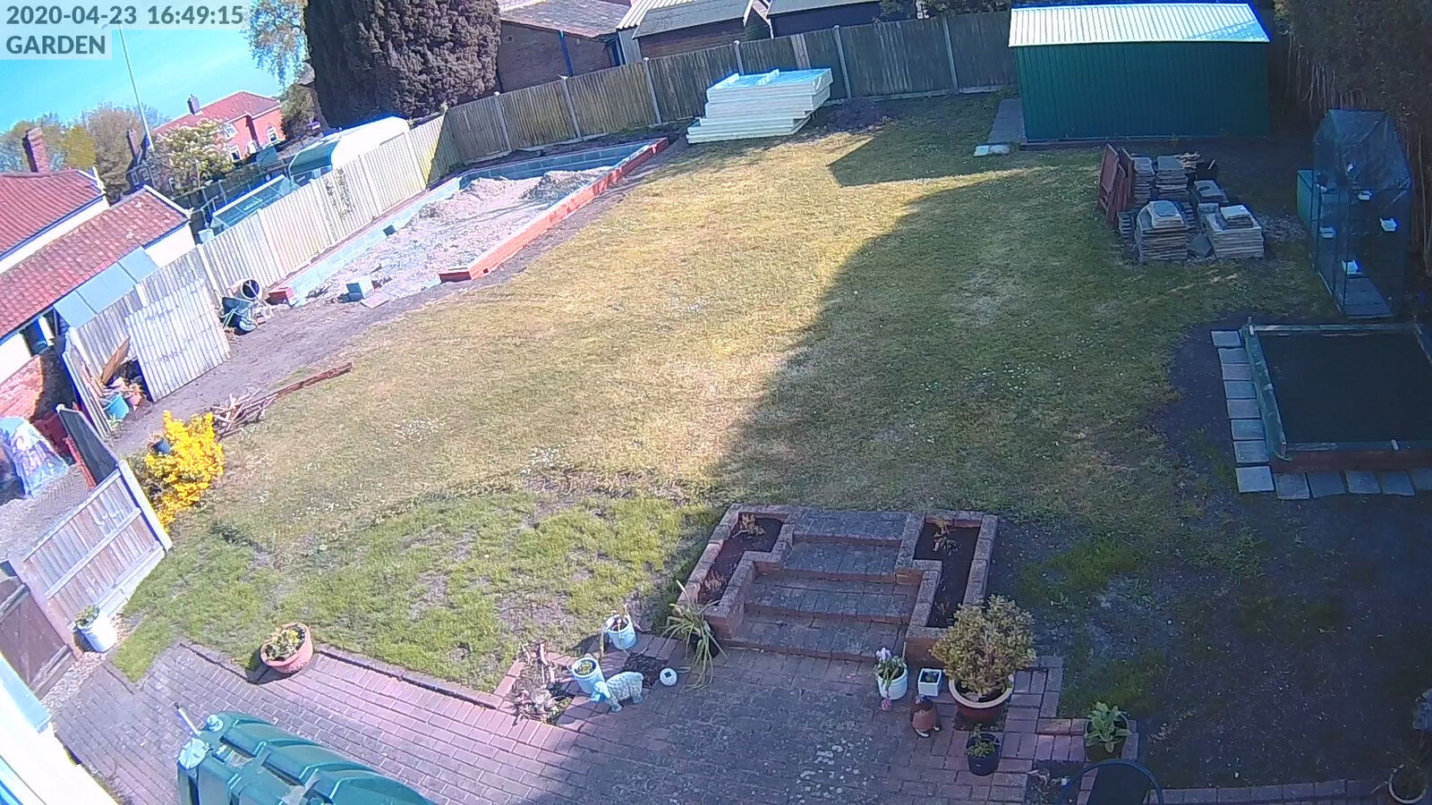

  11. April 20th, digger and dumper working their merry dance across the lawn and removing the old patio.
    Patio and top soil removed

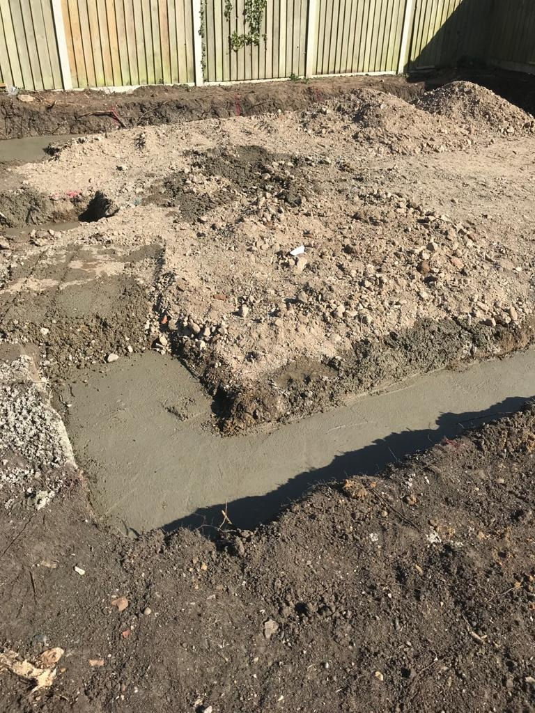

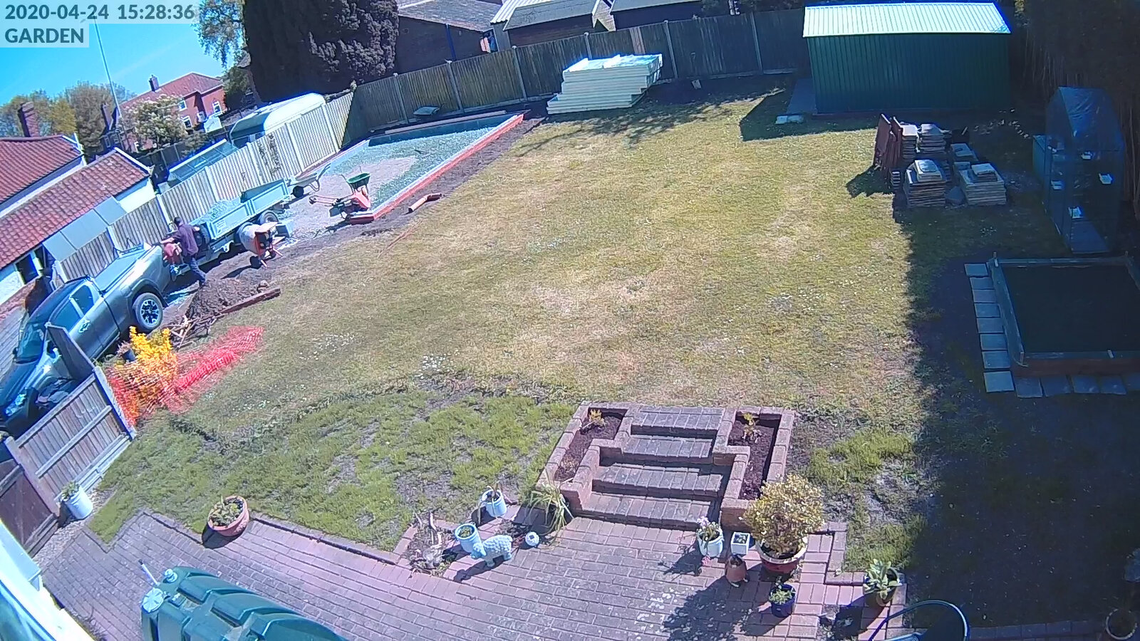

  12. Trenches dug out for foundations, down 1.5m, 60 tons of earth removed in all :astonished: 1st site inspection by building control, then concrete poured.

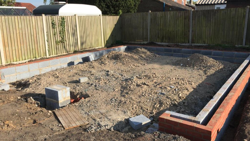

  14. Base layer block work down. Footprint of structure is 7.5m x 6.5m
    #54 Topolino, May 7, 2020
  15. We did speak to them and gave them copies of the plans months before we started the build and prior to planning permission being granted. They were aware of the implications in terms of the light they would lose but we did fell an enormous Eucalyptus tree that used to fill their gutters up with leaves and when it shed bark, so they have gained a lot more light than they stand to lose, which they are happy about. The chap that lives there co-incidentally also knows our builder and he often chats over the fence to him, so I think its pretty harmonious thankfully. The back end of the garden is flanked by a church and the two huts are used by after school groups so they aren't troubled by it either. Always pays to be on side with your neighbours from the get-go.

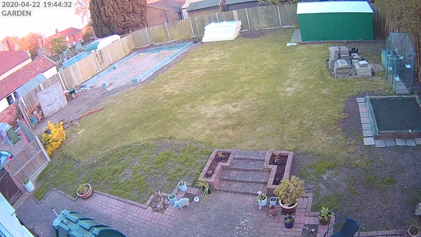

  16. Outer base layer brick face laid.
    Pathway dug out and hardcore layer being added (20 tons of the stuff!) prior to initial DPM being prepared.
    All tamped down ready for the 1st DPM layer

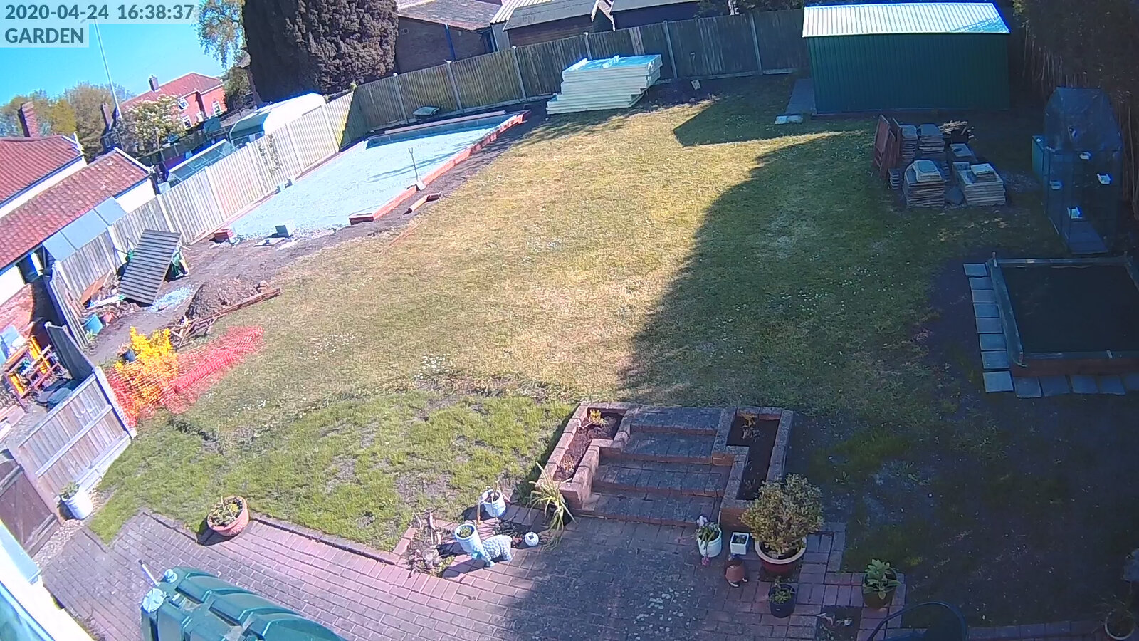

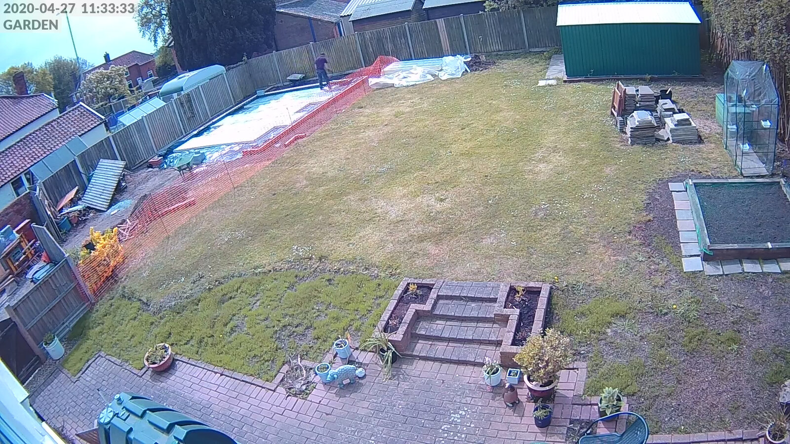

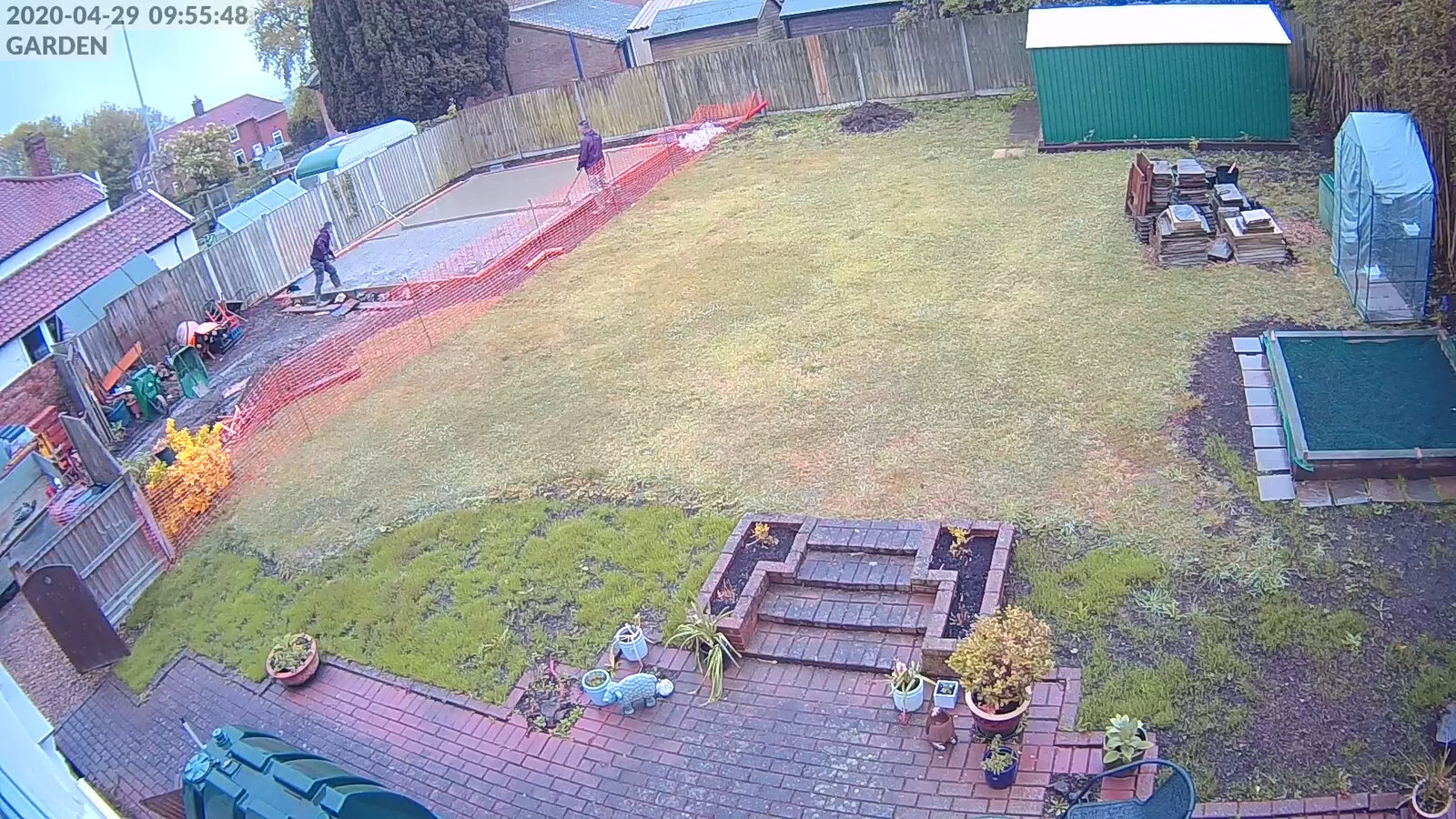

  17. 1st DPM layer laid down over the hardcore, then a layer of thick heavy duty insulation is fitted on top.

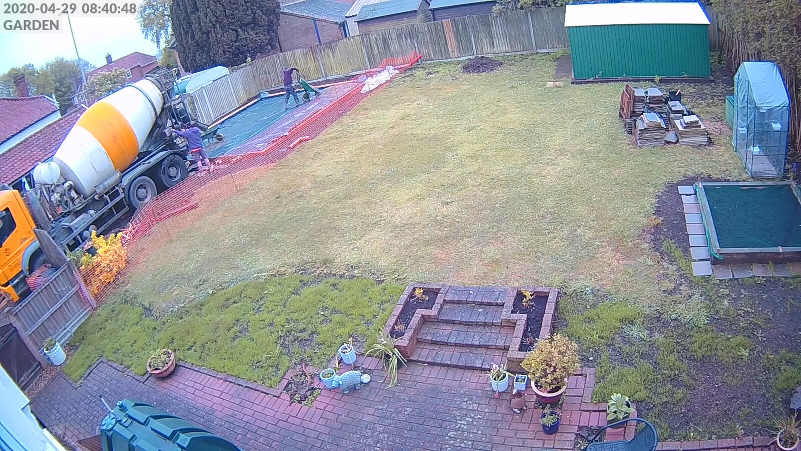

    2nd DPM layer added over insulation, then the mother of all cement lorries turned up and managed to reverse into our garden ready to pour the concrete for the main garage floor slab.
    Concrete poured and stage one of the levelling begins.
  18. Rain stopped play for a few hours and then the floor was smoothed to what I can only describe as billiard table flat using a power floater. Our builder wasn't happy with the initial results due to another mild rain shower so he came back later that night and left after he was finally satisfied with it at gone 10.30pm. He is a very diligent bloke. We did apologize to the neighbours BTW!

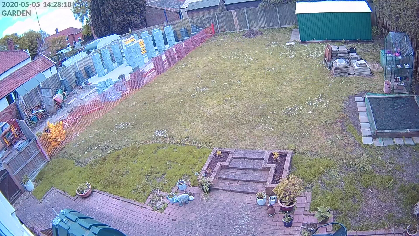

  20. Almost a week later and another huge lorry arrived to deliver the Thermalite blocks and outer blocks, as well as several tons of cement and huge rolls of cavity wall insulation. These were then stacked on rubber sheets laid out on the now solid garage floor slab, like a giant game of garden Jenga. Here you can see the Thermalite blocks. This is just a third of those needed!
    And then more for the next two hours....
