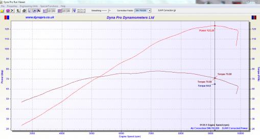

  7. Howdo!
    Ran a PCIII on my ST3 powered Superlight and she made 115Bhp, took the bike to Chris at CJS who then re-mapped the ECU......123Bhp/78lb of torque. Well recommended! Bike is so much smoother all the way through the rev range.
    Cheers Pablo

    When I took mine to him (he's based at Lougi Moto) I thought this kid is an arrogant sod, he was constantly smoking a tiny ickle roll up whilst checking the bike on his lappy,and baffling me with whot could have been complete bullshizle, I took the bike on brands indy next day and it didn't miss a beat,but I didn't realise how much he'd improved it till I had my first run up the hill and when I gave it the usual % of thottle the front wheel came off the ground by about two feet.
    Remapping is defo the best way to get the most out of your bike. It's taking away euro emissions regs and parameters that are there to please buracraps not us.
