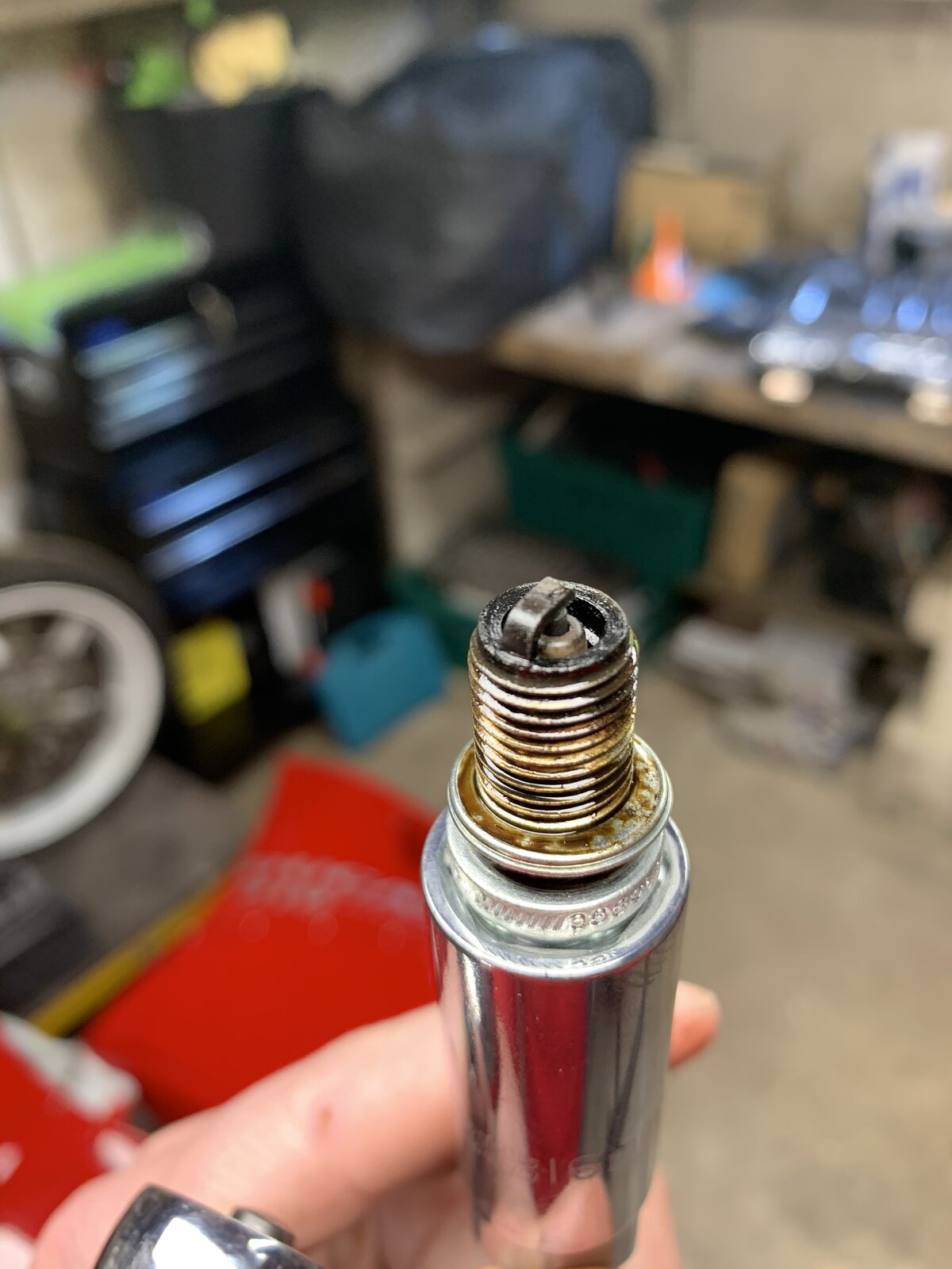

  10. F9F535AE-AB33-41EB-A21E-D30B3720690A.jpeg Uhm, this bad?
  11. No doesn't look bad.
  12. So amount of oil is ok? Phew
  13. looks like the oil is on the outside of the plug, the electrode looks fine.
  14. The only way I can think that oil could have got there is if you, or a previous owner, either removed the plugs and dropped a small amount of oil into the cylinder, as the bike was going to be laid up for a while, and some got onto the plug thread or someone purposely put some on the plug's thread to avoid corrosion and ease it in and out. Either way, it's nothing to worry about.:upyeah:
