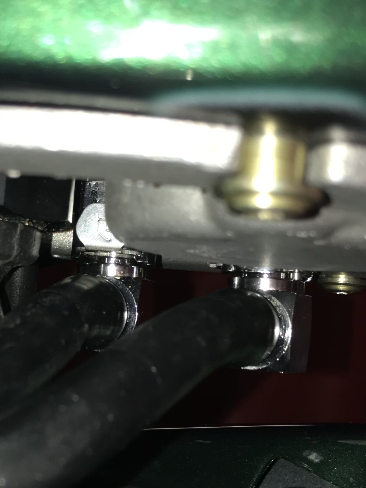

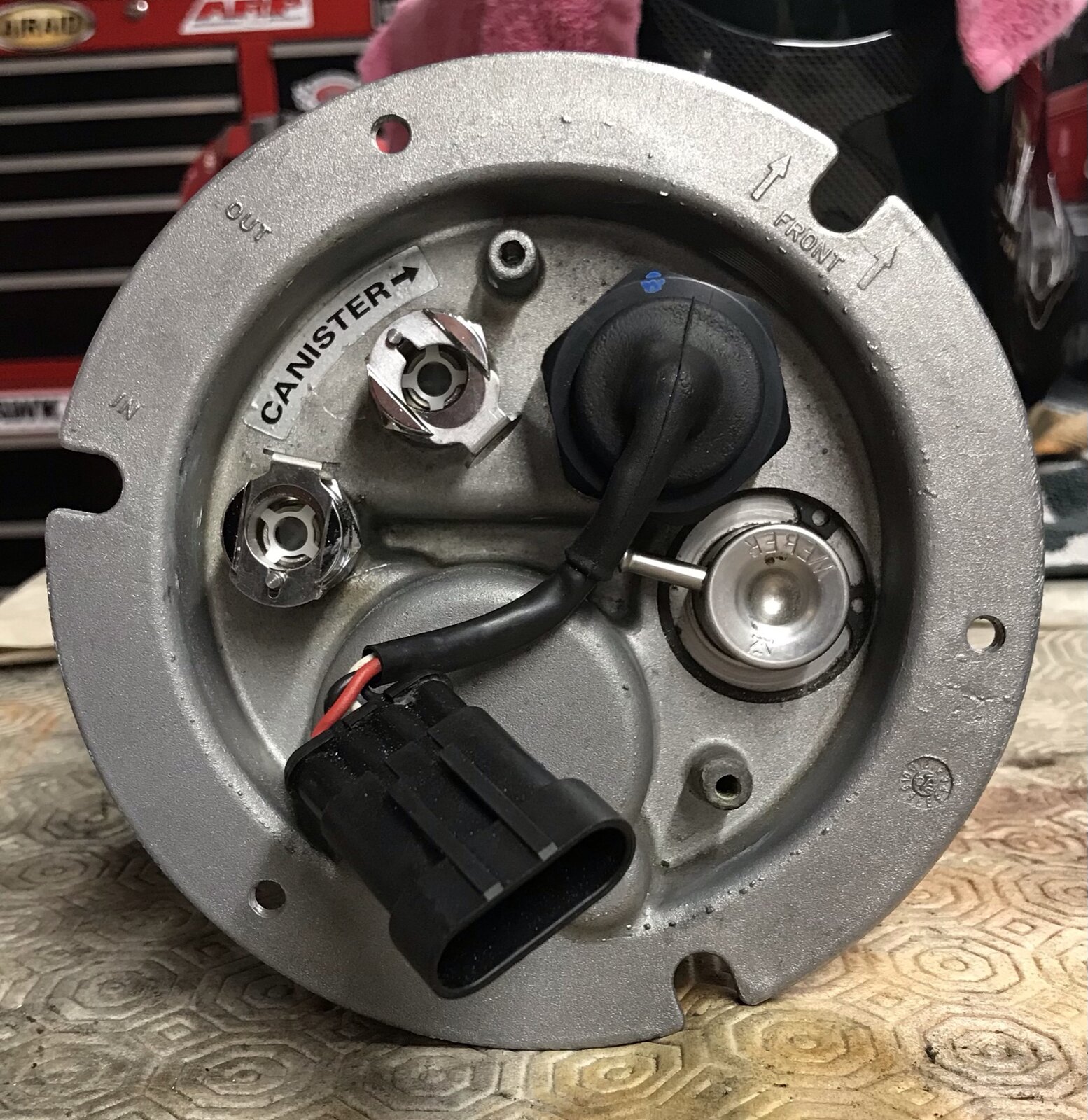

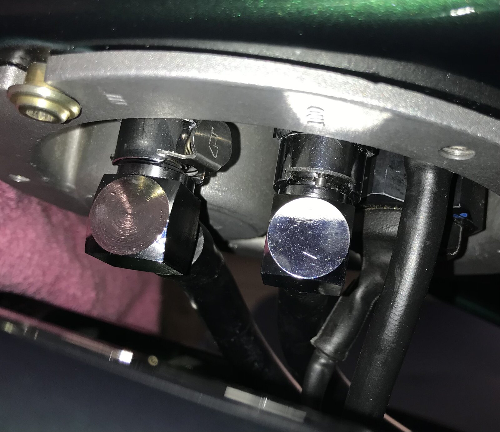

    First, I took advantage of having removed the tank to upgrade to metal quick couplings. Very happy with this fairly basic mod. Found really good quality couplings (and customer service) at this German based shop: https://www.benzinkupplung.de/

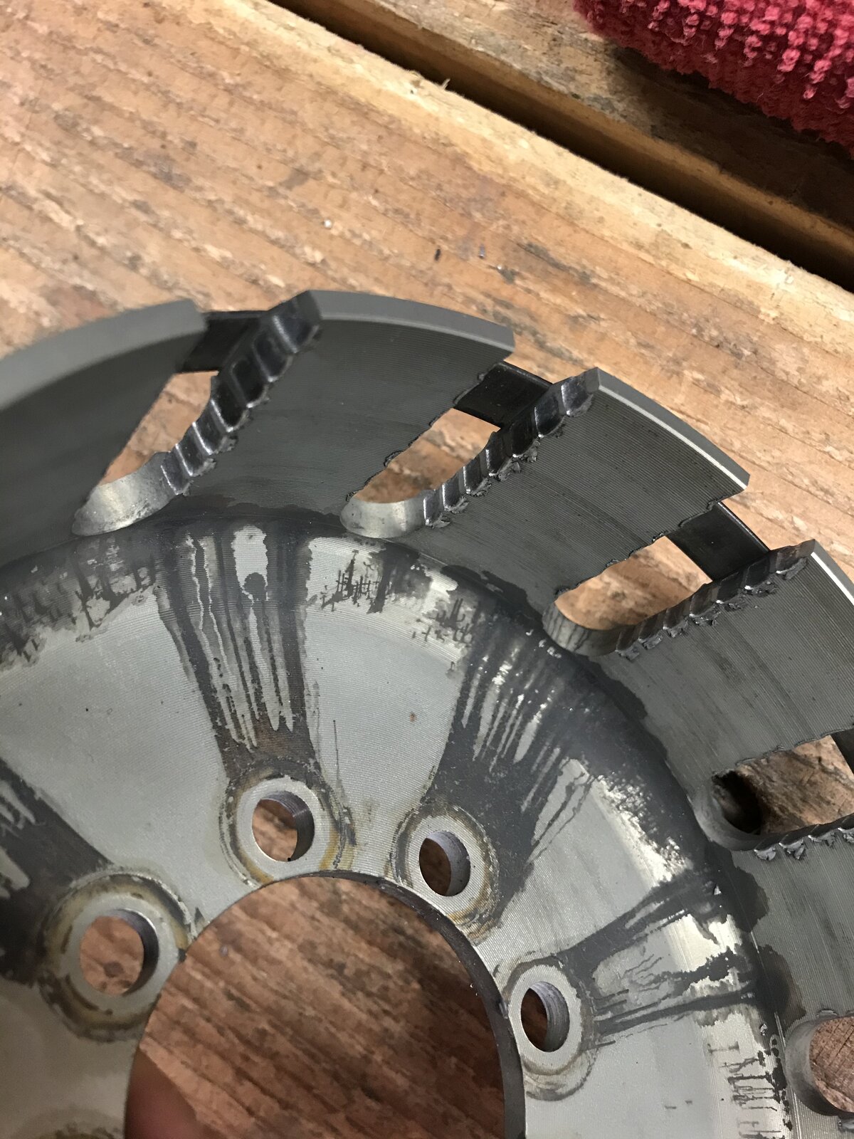

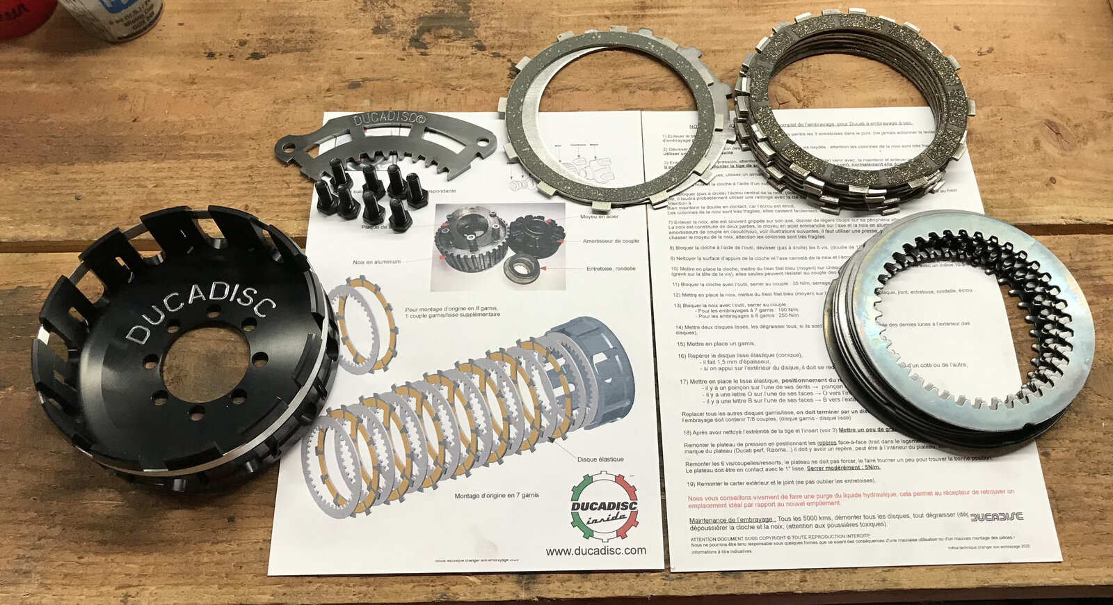

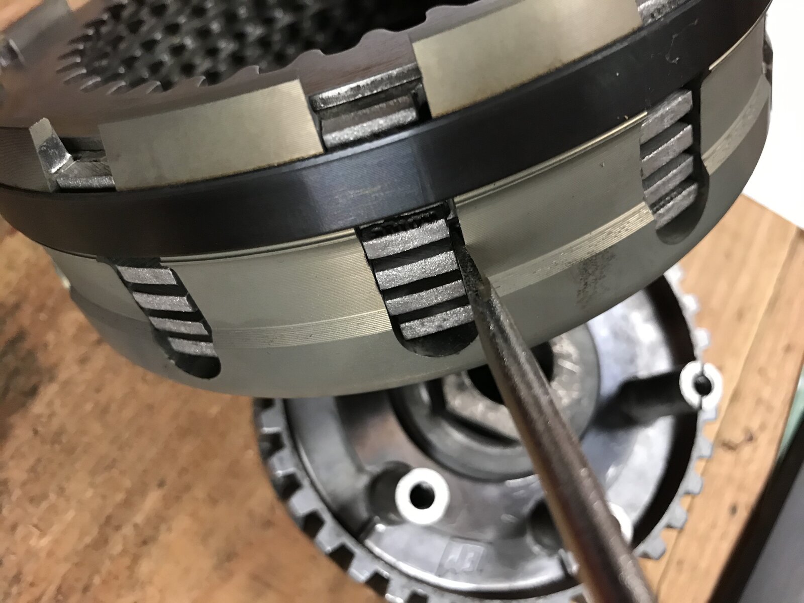

    Finally, as the engine/exhaust note are now perfect, I started to find the clutch rattle way too loud. Got the whole thing out and there’s a good millimeter of play between the friction discs tabs and the basket. Too much. Surprising as this clutch has only 7000 miles on it...
    I ordered a new ergal basket and a new set of discs with the “silent” combo from Ducadisc, in the north of France, considered as the Ducati dry clutch guru, over here (http://ducadisc.com/fr/). Hoping to get it in the post this morning or tomorrow. He says the bike will sound and feel totally different, with a much less noisy clutch and a very soft clutch action. We’ll see.
    #22 Guillaume69, Apr 12, 2021

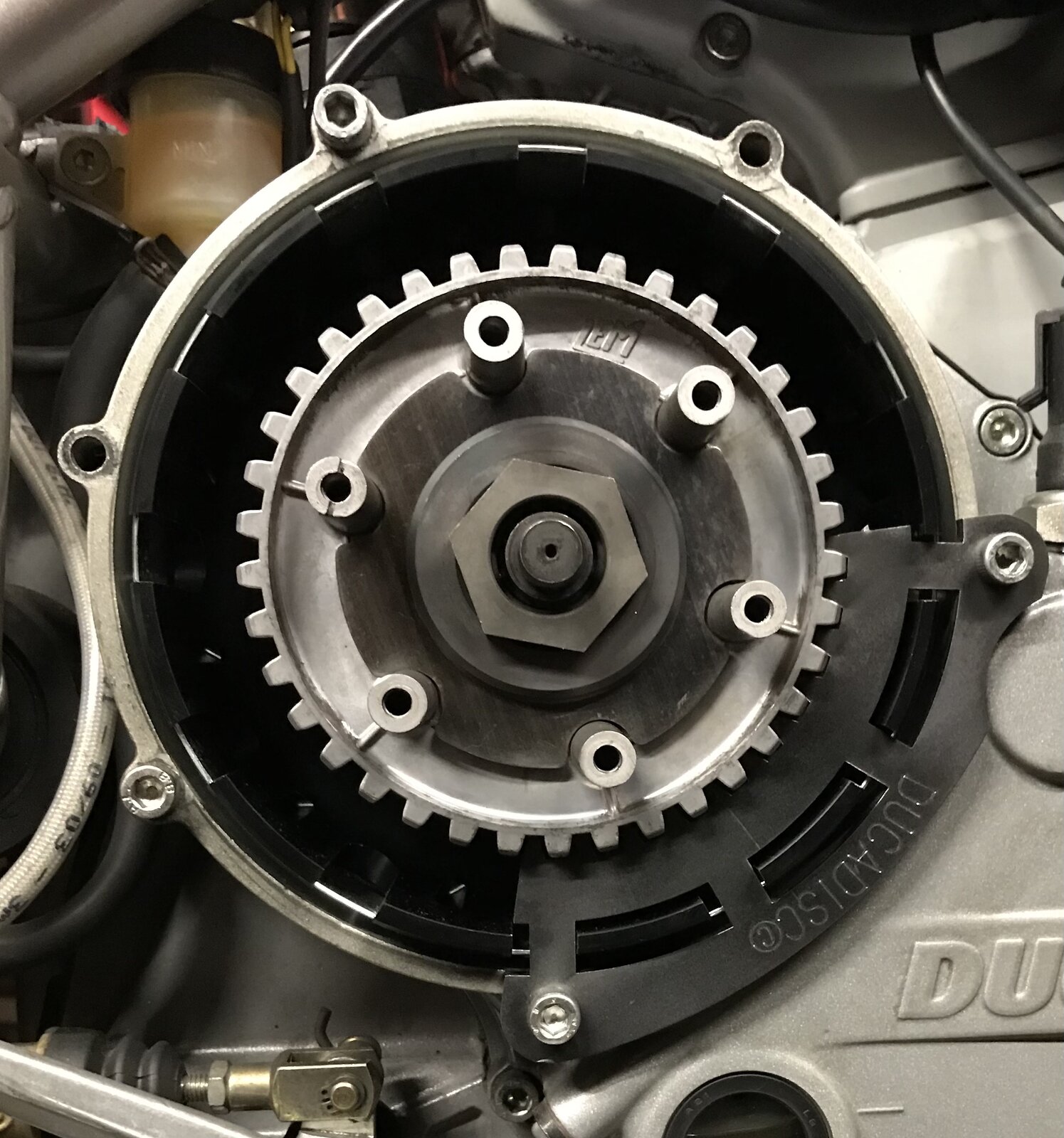

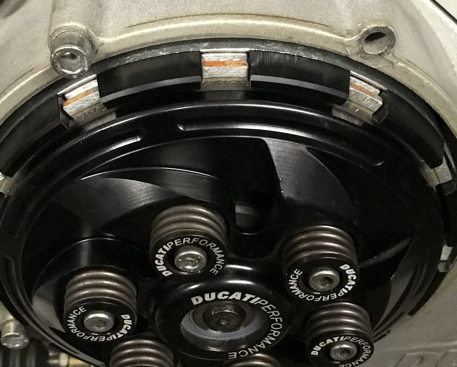

  3. 73BCD667-3B8E-482D-BBE2-C6A2DDDB278F.jpeg Got this in the post today! Couldn’t be happier with the quality. Looking forward to put it on and test it.
  4. Let us know how you get on, will be interesting if much softer when pulling the clutch in.
    Looks a nice kit, a shame we only see the pressure plate when fitted.
  5. Indeed! Once mounted, it’s all hidden...

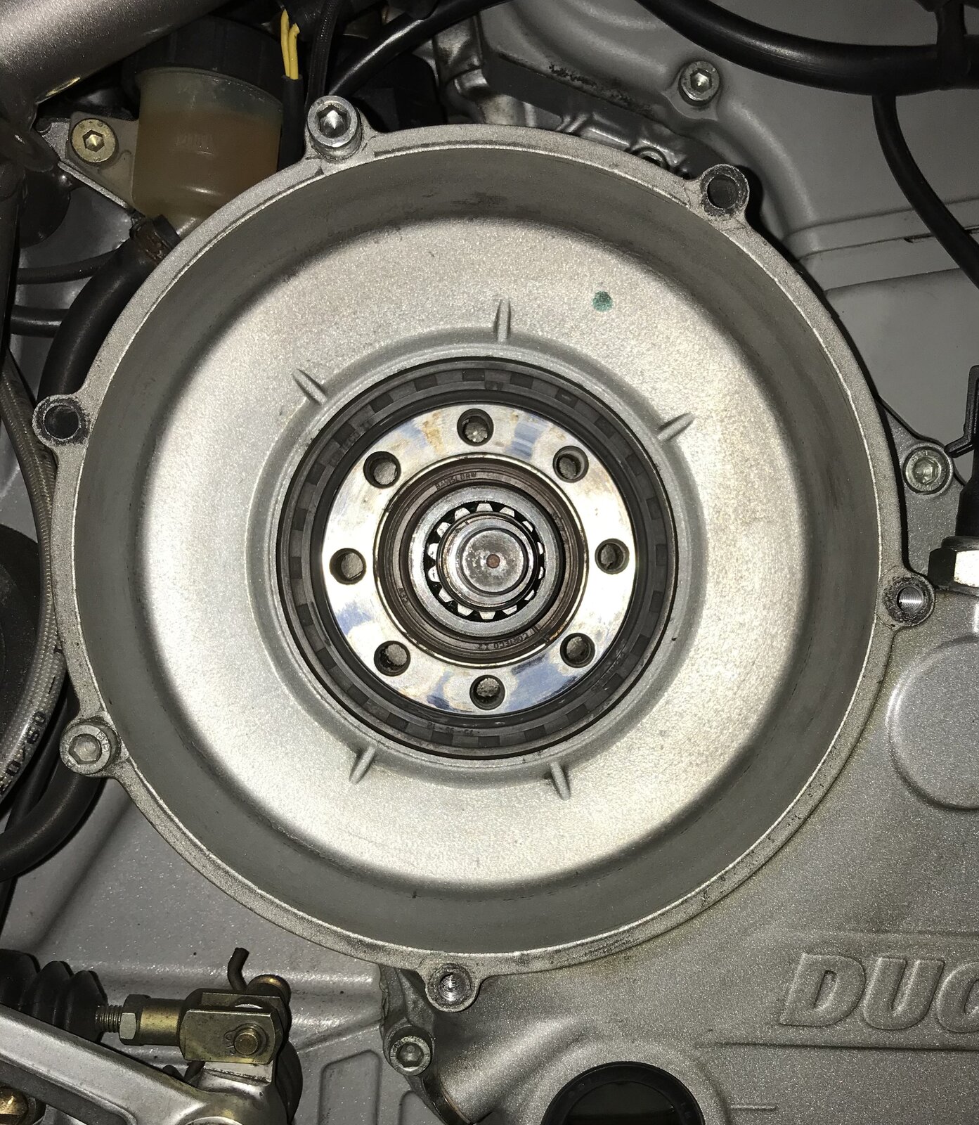

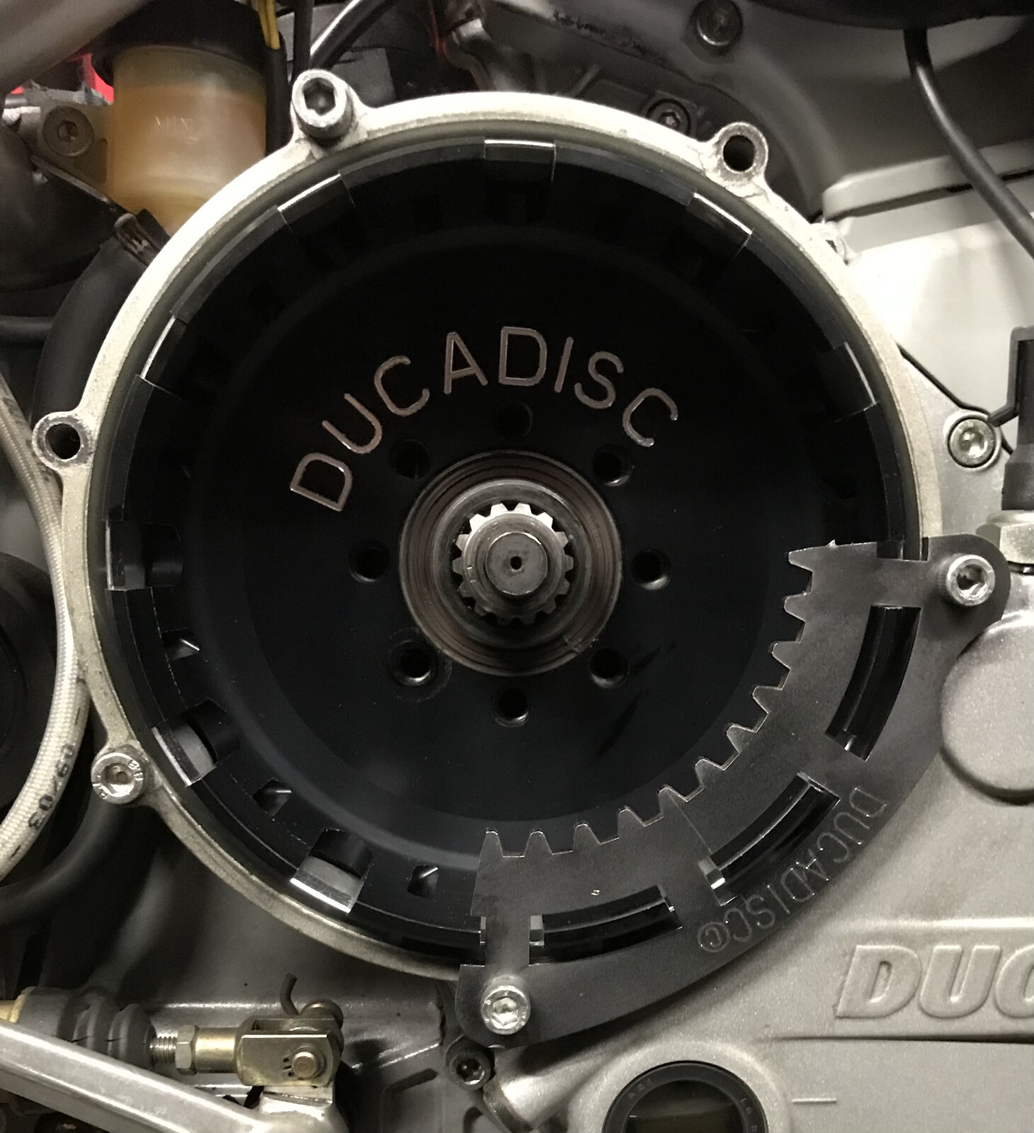

    Kit is mounted on bike and there’s already a significant difference at idle. No more gaps, no more rattle. Just the mat sound of a perfectly set dry clutch, if that makes any sense. I need to test it on the road now. Being locked down, again, it’ll have to wait till May...

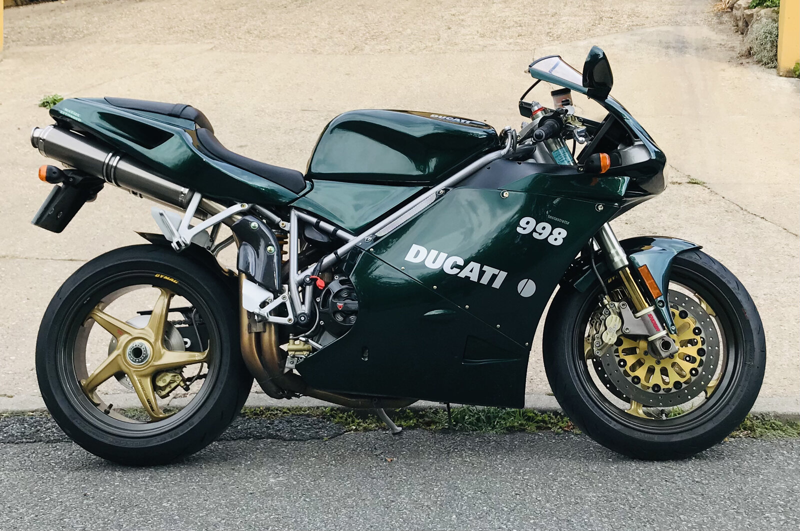

  10. I have been fiddling for some time with the idea that gold and dark green could be a nice match … So I decided to put the Dymags on the Matrix for a try. I personally think it looks even better than on the red 916.
    And handling wise, well, it feels like an 848 now… I feel no longer limited by my ability to swing the bike quickly enough from one side to the other in twisties. The new limit is rubber grip. :D
