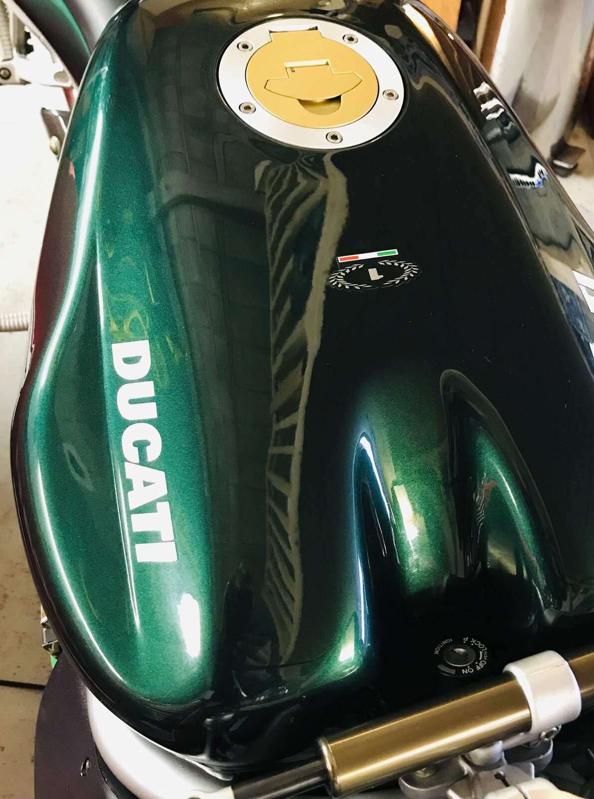

  1. Yes i”ve seen it, but i am having mine painted in the Original Verde with grey wheels, they are doing Silver stickers for me, but i am having the seat Logos changed from Reloaded to Reimagened. Just can’t wait to get it back now

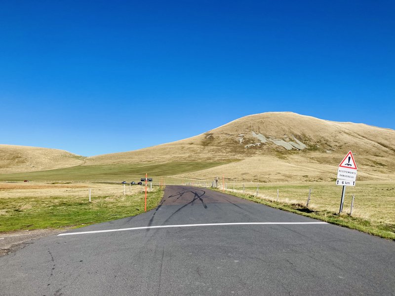

  3. We went for a 2-days bike trip two week-ends ago, in Auvergne, just south-west of Clermont-Ferrand, in France. That’s about 2 hours from us. Trip was organized with our Planète Ducati forum group. High grounds (1000m-ish) so usually damp and chilly in late October. But not this year. This year, fall has been absolutely fabulous, save a couple thunderstorms here and there o_O
    The Matrix with the Dymag wheels was the perfect bike for this trip. Fantastic feeling all the way!
    It looks like a track, doesn’t it? Well it’s not. It’s just the pass between Chambon-sur-Lac and le Mont Dore, road D36. :D

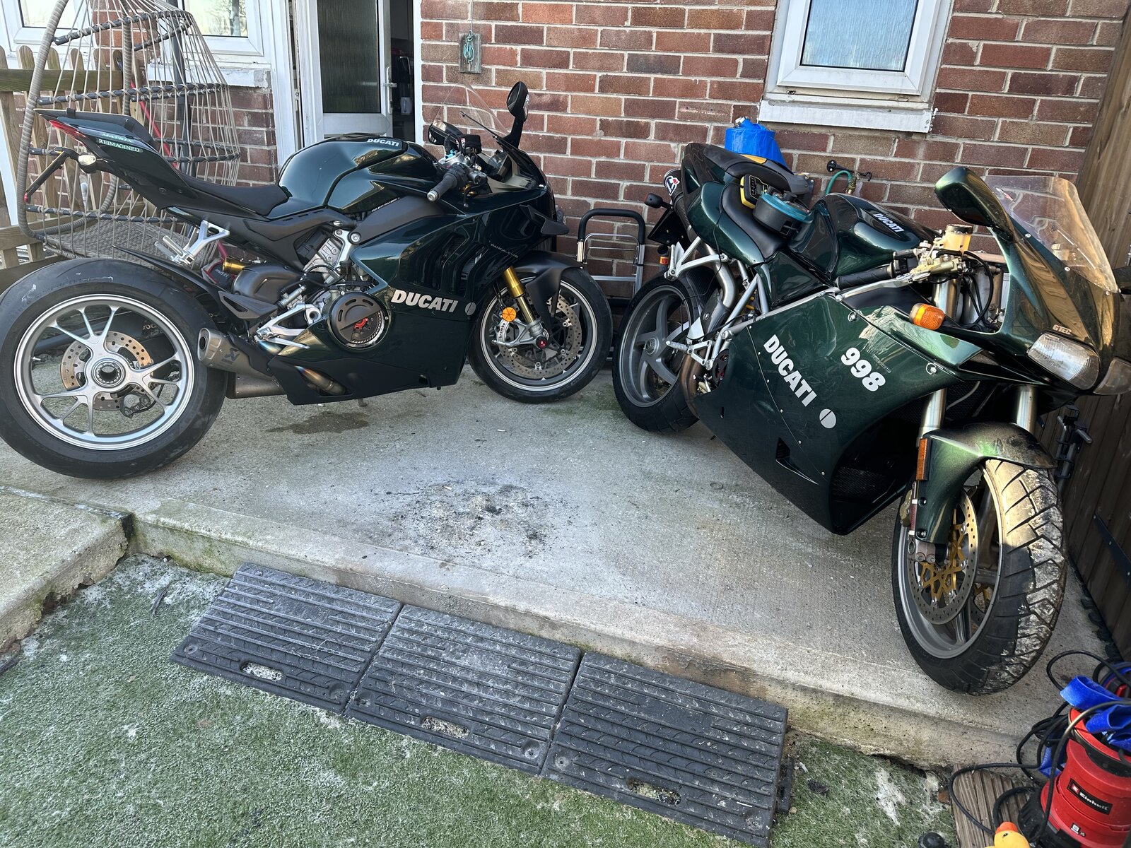

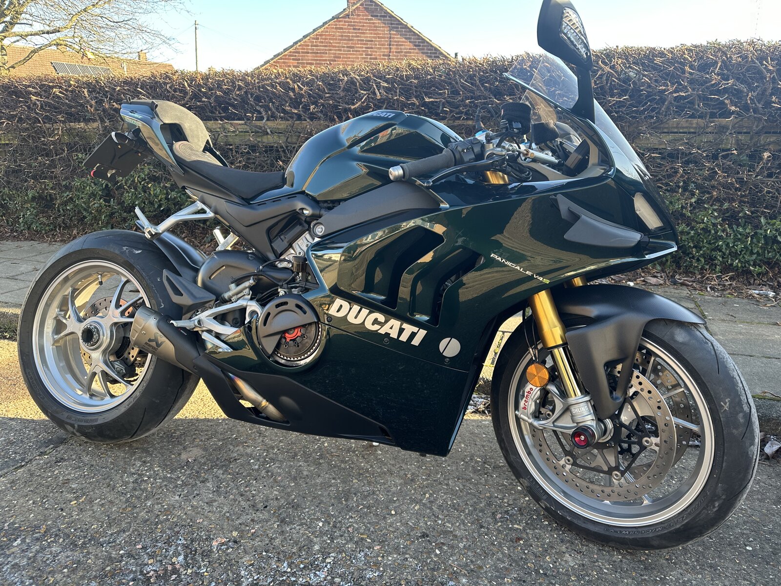

  9. The V4 is back and it makes a great big sister to the 998 91C89BAC-FB12-4BB7-91FE-B600DEA7C4FE.jpeg 124DB817-362E-4022-B6D5-D05B652DA574.jpeg

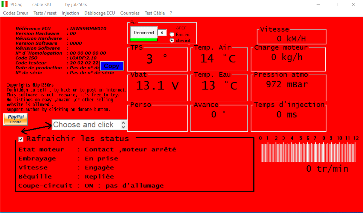

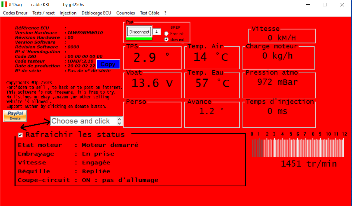

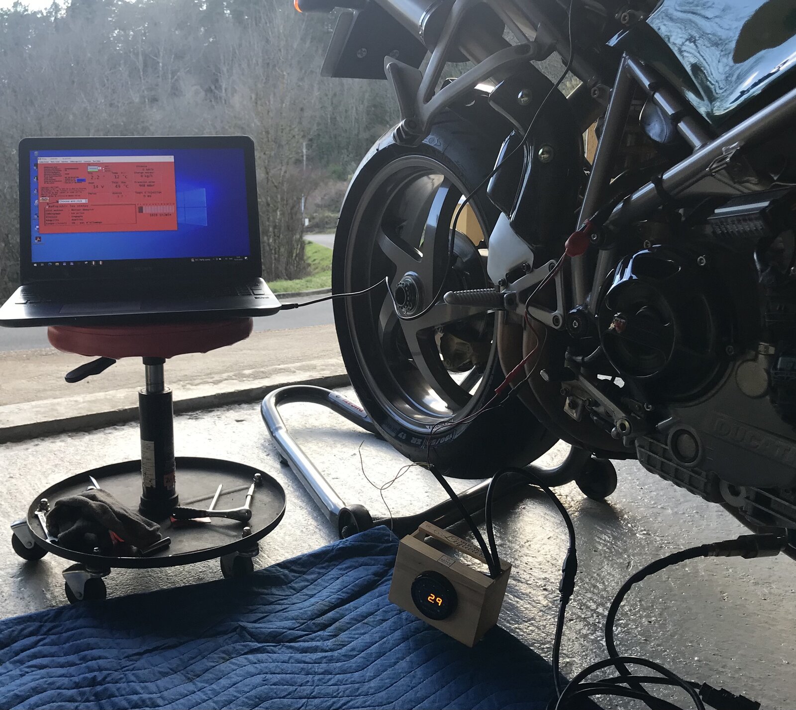

  11. I successfully connected JPDIAG diagnostic tool on the Matrix today. First time user as I have a Mathesis for the 916.
    After reading A LOT about how JPDIAG should be set up and used to work properly on the dedicated forum:
    https://jpdiag.xooit.eu/index.php
    I pulled the trigger on the LONELEC cables:
    https://www.lonelec.com/product/guzzidiag-3pin-interface-cable-kit/
    Downloaded the JPDIAG software (v.28):
    http://jpdiag.akress.com/download.php
    Read some more and…
    Voilà! :D
    Engine OFF: 30CA8D29-4825-49B8-8447-D59E81B704B3.png
    Engine ON:
    I have to say I am really happy it worked at my first attempt, as the reading of others misfortunes can be rather discouraging…
    I had a blast starting the fuel pump or the fans from my laptop, fiddling with the rev counter needle, visualizing the TPS degrees move as I turn the throttle, and so on. You know…
    Now, on to (non-linear) TPS (manual) reset, cylinders synchro and CO adjustment (aiming at 5%). I’ll be following Brad Black’s check list, like I did on the 916. Worked a treat!
    http://www.bikeboy.org/998748rthrottleb.html
  12. All done! :upyeah:
    TPS zero’d out perfectly so I didn’t have to mess with it. The master idle crew (horizontal cylinder) was too tight with 2.9 degrees, which kept a rather high idle (1400 rpm). I set it back down to 2.3 as recommended in the shop manual.
    I then synched the two cylinders. Access to the set-up elements is significantly more difficult than on a 916. You really want to select your tools and try things before putting the air box and tank back on. And have a telescopic magnet handy! Access to the throttle linkage balance adjustment screw is stupid, when compared to the 916 throttle body.

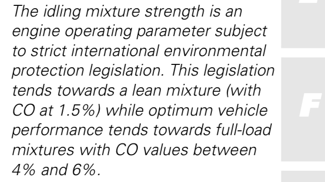

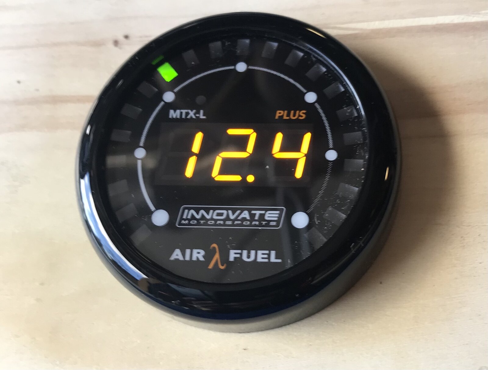

    With that done, I hooked the bike to JPDIAG and to my AFR gauge and I set the CO to a good 5.5% (12.4 AFR), which is richer than the factory setting but better for engine performance. Here’s how it is explained in the workshop manual:
    I really had a blast doing all this!

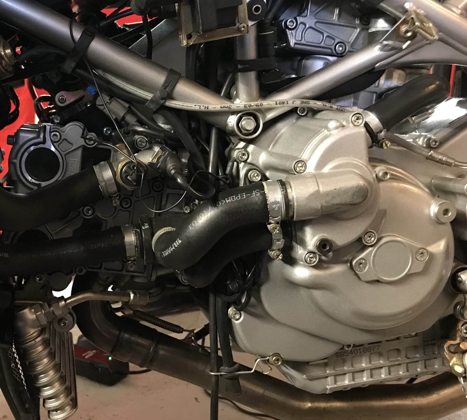

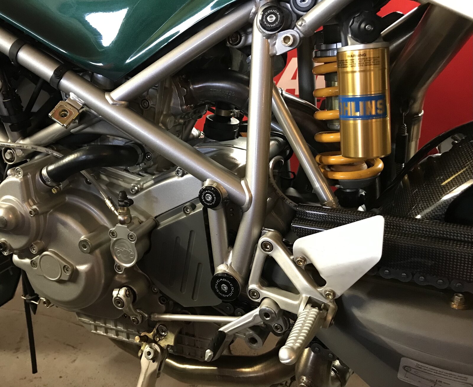

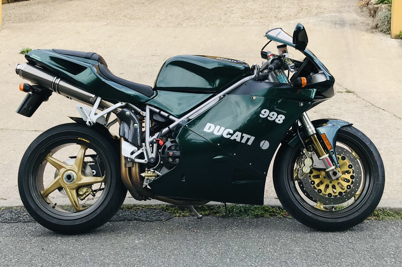

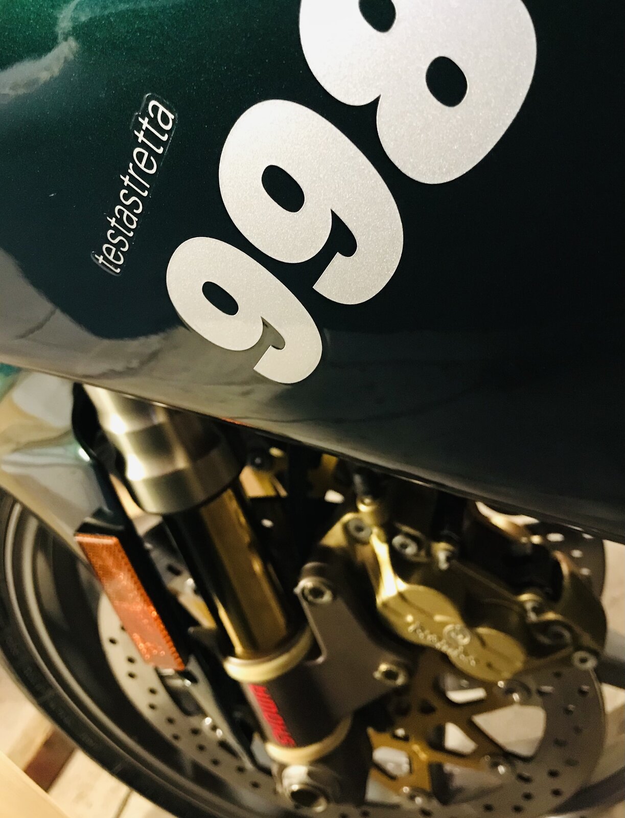

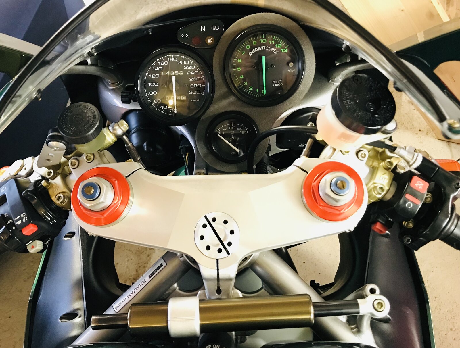

  13. Went for a ride yesterday afternoon. Super happy with the injection settings. Now just as her great sister (916), this bike will be exposed on a dedicated Tamburini stand next weekend at the Salon moto in Lyon. I gave it a good clean before it goes and couldn’t resist taking a few detailed pics.
    AA9A7109-1D87-4DCD-998A-BD5857B50DDE.jpeg 15B062E6-541E-4C35-9E92-17B56EEF60BA.jpeg 038EFD50-4566-4226-98E2-1C8F12C75915.jpeg CBB85ECC-BCE9-491A-8A0F-3A10034F8331.jpeg 7057C280-CE83-40C1-9B2C-06A327BB4704.jpeg A0493562-AED1-4EF4-B31B-4CDC7BE76C6E.jpeg B45ED9B9-9D06-4022-BA75-2B0650F1301D.jpeg B3E6F3A0-E6C4-447E-80AC-578C23124D40.jpeg 681FDBBA-277B-488D-BD6C-B8A60AE01E50.jpeg 8AA59CC6-177A-437C-BD65-2C3531B5B551.jpeg 115DAAEE-3152-4C7A-89CE-C7E3E1BA58D2.jpeg
