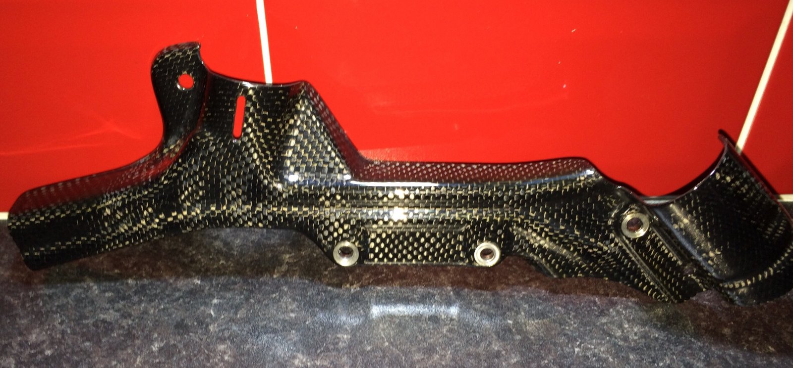

  7. Got the cable cover back off my neighbour who gloss clear coated it, the weave shows up much more now.
    Now to fit it !!!

    I got the original cover off ok apart from the front section that had the two plugs and what appears to be a sensor behind it. After a little fiddling about I did get it off but the carbon one will be much easier to fit if I remove the mid section fairing but even though I have removed the top 4 bolts, the bottom 3 bolts and the bolt holding it onto the black plastic bit that appears to be part of the air tubes, or maybe the electrical cover the mid section will still not come off and the only thing I can see holding it is that flat plug on the inside of the inner side fairing.

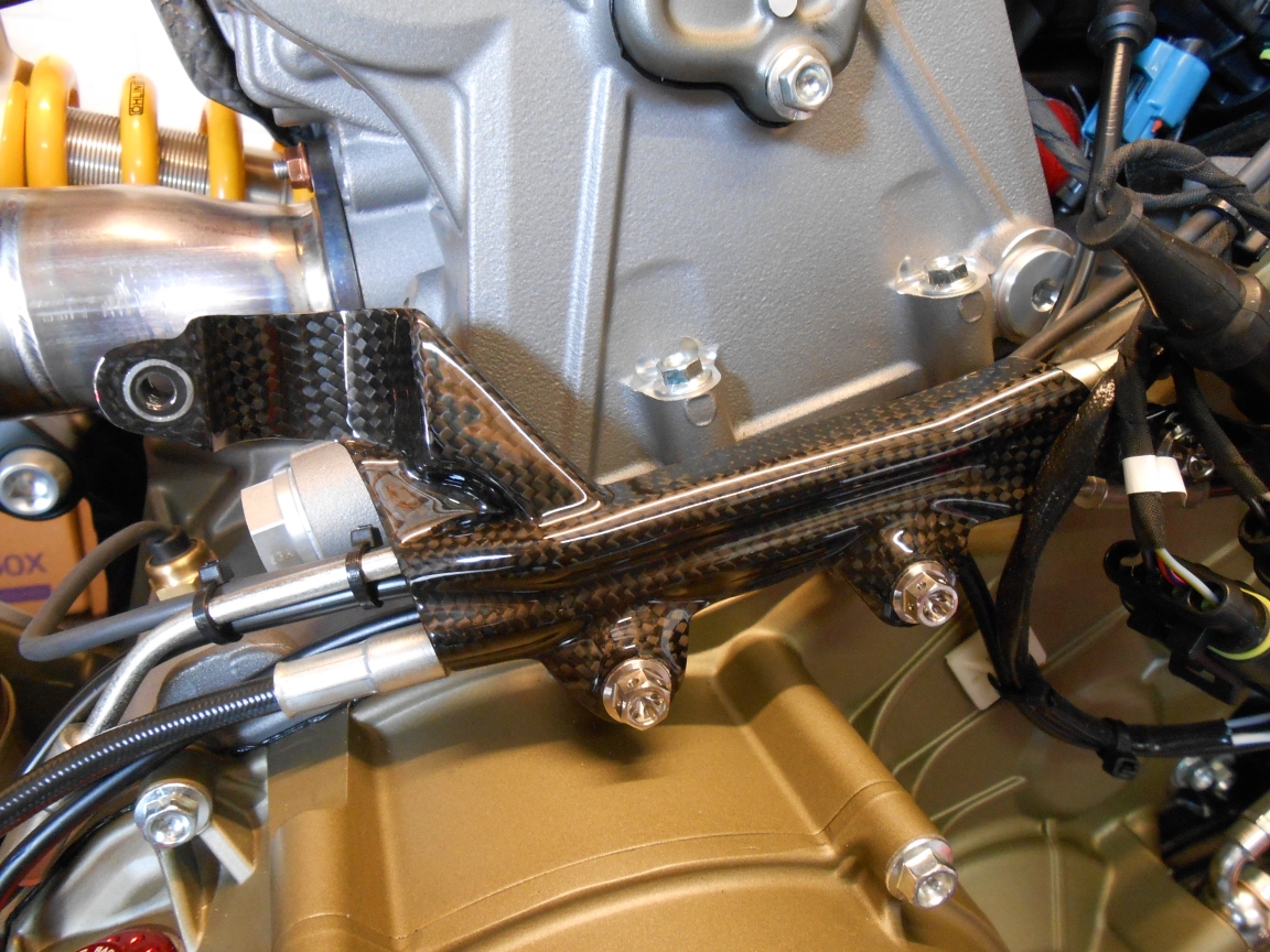

  16. I got the cable cover fitted by just easing the mid panel off a little. Couldn't be arsed to remove the key guard and air tube covers just to get a side panel off, bloody stupid idea if you ask me. In this day and age they should make it even easier than the old 748 etc to remove panels instead of having hooks, bolts, plugs and god knows what else keeping it together.

  18. Mine is from Carbonworld in Germany. They are quite pricey for what they are.
    I picked mine up from someone who bought it and sold his bike before he fitted it so got it cheapish compared to new.
    Will add a picture tomorrow.
  19. Not great picture quality but you get the idea,
  20. Here's a question for you.....
    2 carbon parts purchased from the same company. Both supposed to be satin finish. One is lacquered and one is not. This gives them a different appearance ... would you be happy?
