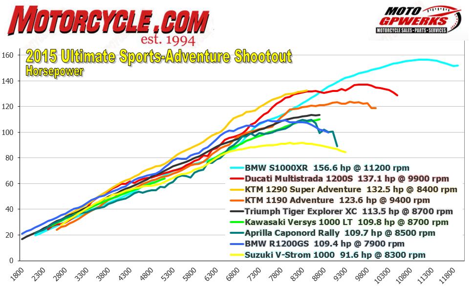

  14. the 'arse power' feeling is as the chart below. Numbers are not the point, only the difference between the bikes' power feeling when you nail the throttle.
  15. So we all should have bought the Vstrom... Really? [emoji15]
  16. Was there not a new map since that test that changed a standard DVT quite a bit?
