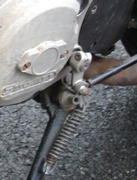

  2. Thread Hijack sorry in advance...Ah...but you don't need to live with the flip-up sidestand, I never have as I hate it, not because I would not get used to it, but just did not
    like the idea at all...easy solution, cut away the lug stopping the spring moving all the way forward.... see pictures.
