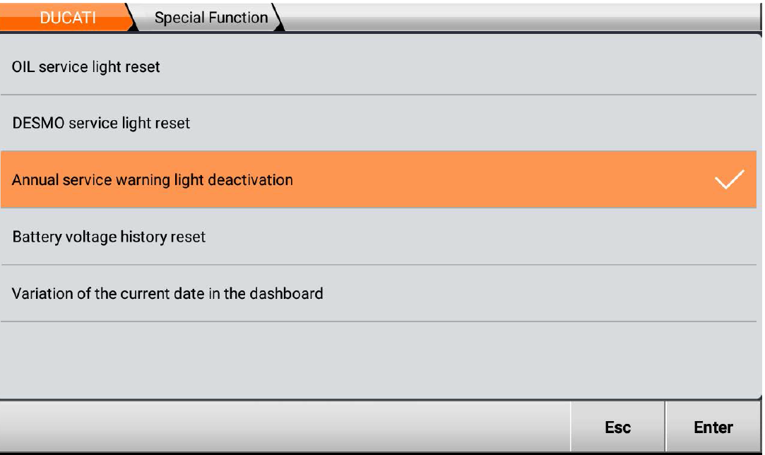

  3. The 1200 just has these:

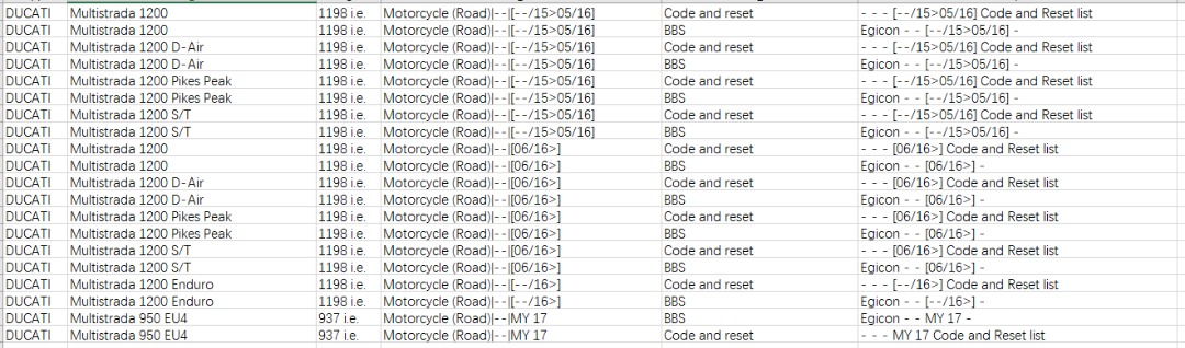

  16. I can't, but if you look at the files or screenshot I added on post 22, it shows what IS available for the 1260 models.
    Given I can drill down on my 1200 as per the other screenshot, its logical to assume that the 1260 special functions will be as per the menu shown ;)

    however...and I'm aware it could be the way I've done this, but having altered the date on the bike to next year to bring on the annual service indicator on the dash, I cant reset it, I just get "security verification failure" or something similar
    so it could be the unit is confused as to why the dates dont match (it knows its 2022) or am I doing something wrong ?
    have you guys managed to reset any of the lights ?
  19. I reset my annual service light with no bother, but it was showing on the dash as being overdue. If you tried resetting without it being due - there is your issue.
    You can still set todays date in your Ducati settings but that is separate to the service date.
    Mine automatically selected an additional year to reset to. I didn't need to pick one, although the option to do that, was there
  20. The bike “thinks” it’s due as I’ve told it it’s next year already :grinning: and the reminder was showing in the dash… however it’s sounds like it’s as I suspected and the unit knows it still 2022 so fails the reset
    Pleased that yours reset the lights no bother and that it’s my playing around that’s the issue
