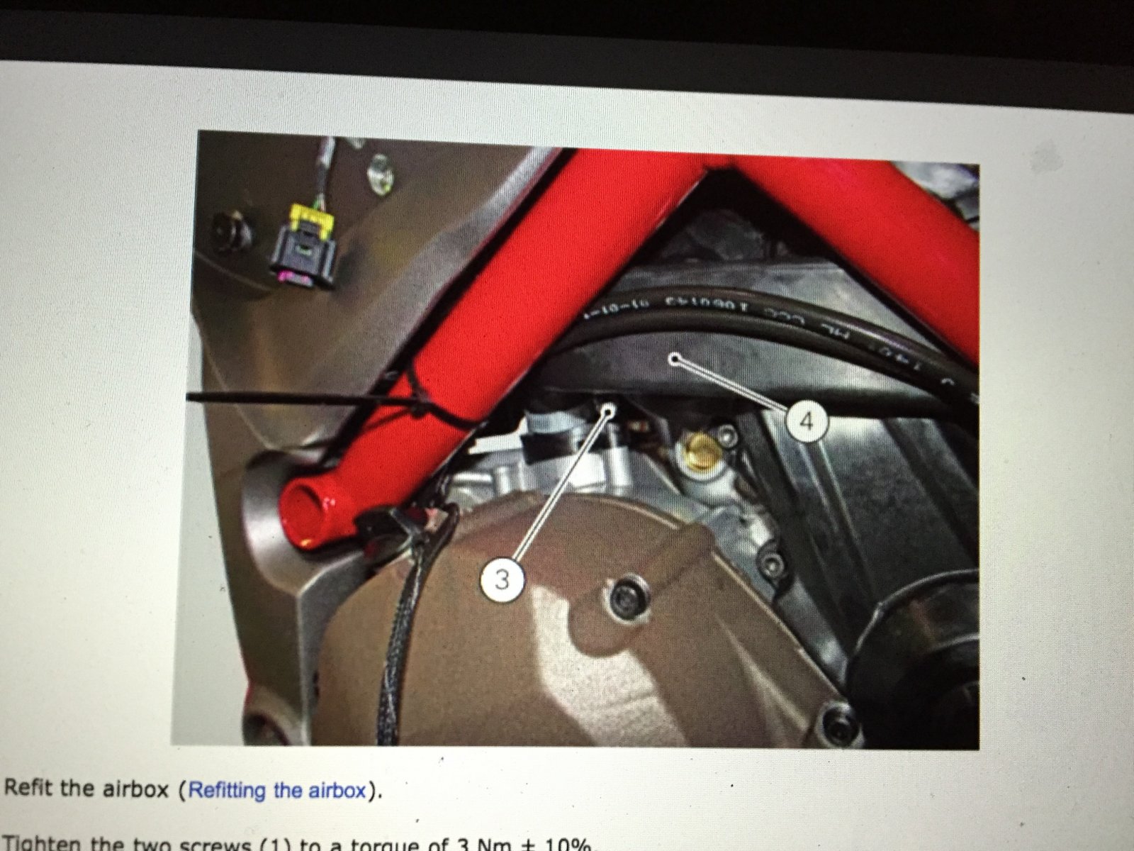

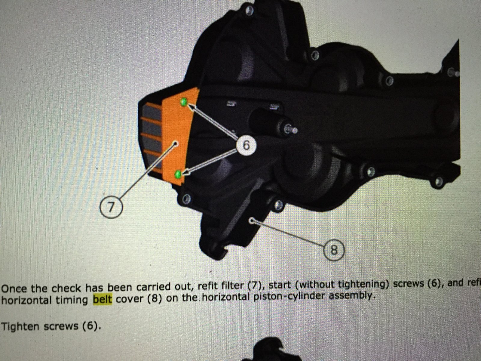

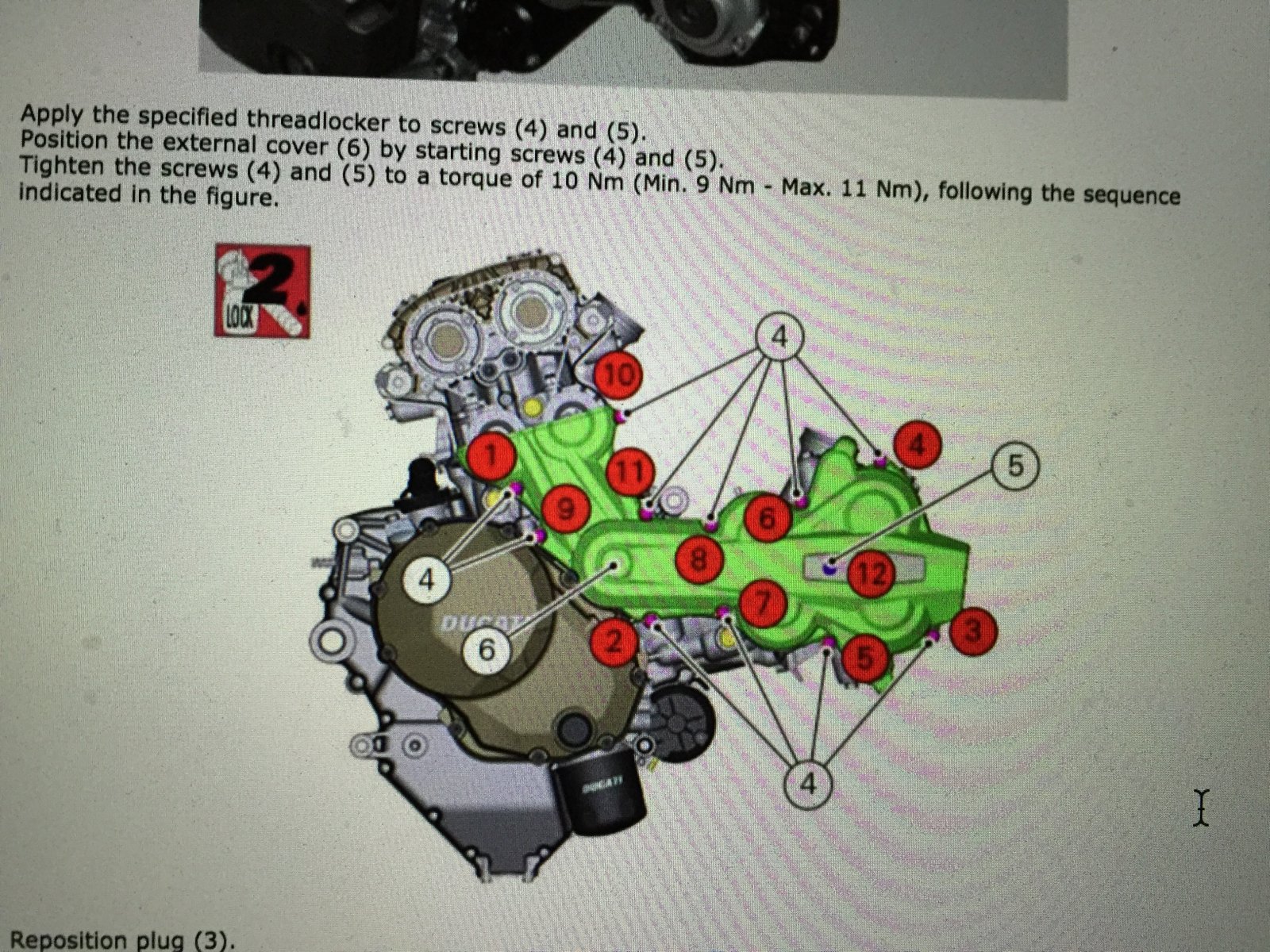

  4. Hi
    1. Unscrew all screws.
    2.(3rd picture) Take off rubber breather hose,(located far up from the left cylinder) just loose the connector from left and slide the rubber hose over right, it its tight.there are some cables with zipties, take ziptie off you need all the space.
    3.(1st picture)Take off cambelt cover filter from old part and install it to the carbonfibre cover.
    4. (2nd picture)Just install the new part, remember the tighten sequence. (min 9nm- max 11nm)
    It is quite easy to do with 2 people. 1 person is pulling these cables and other one will install the part. IMG_3391.JPG IMG_3392.JPG IMG_3393.JPG

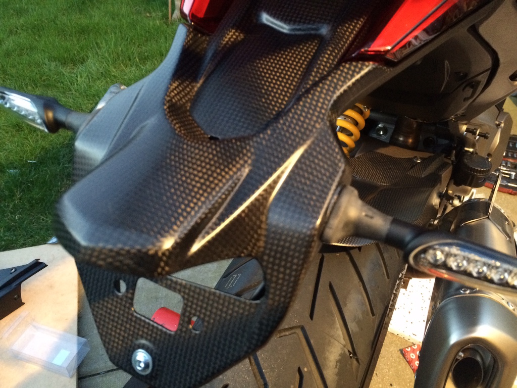

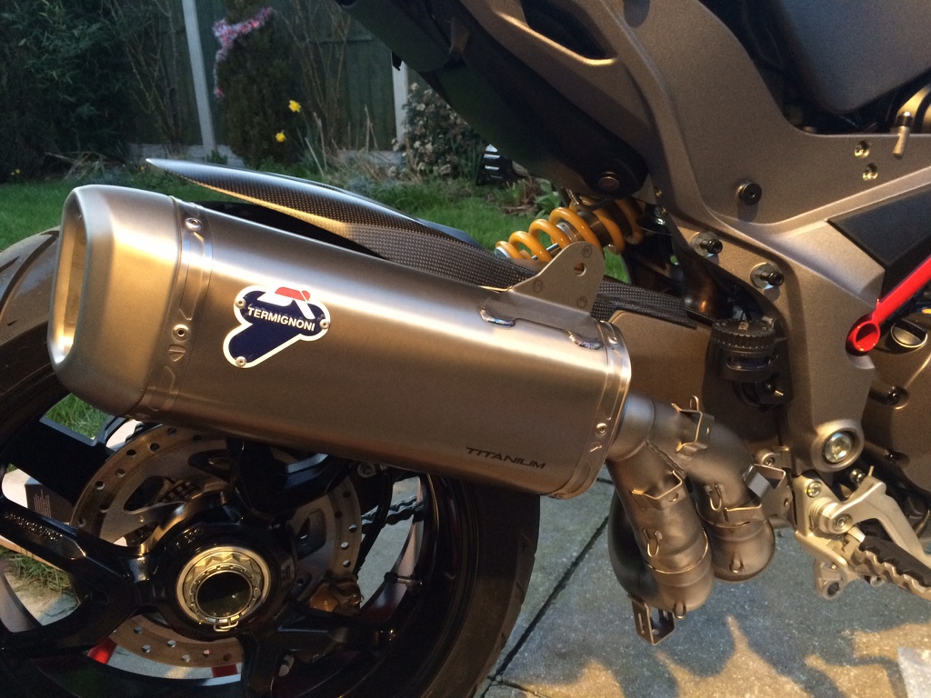

  8. No good with a tank bag tho apparently
