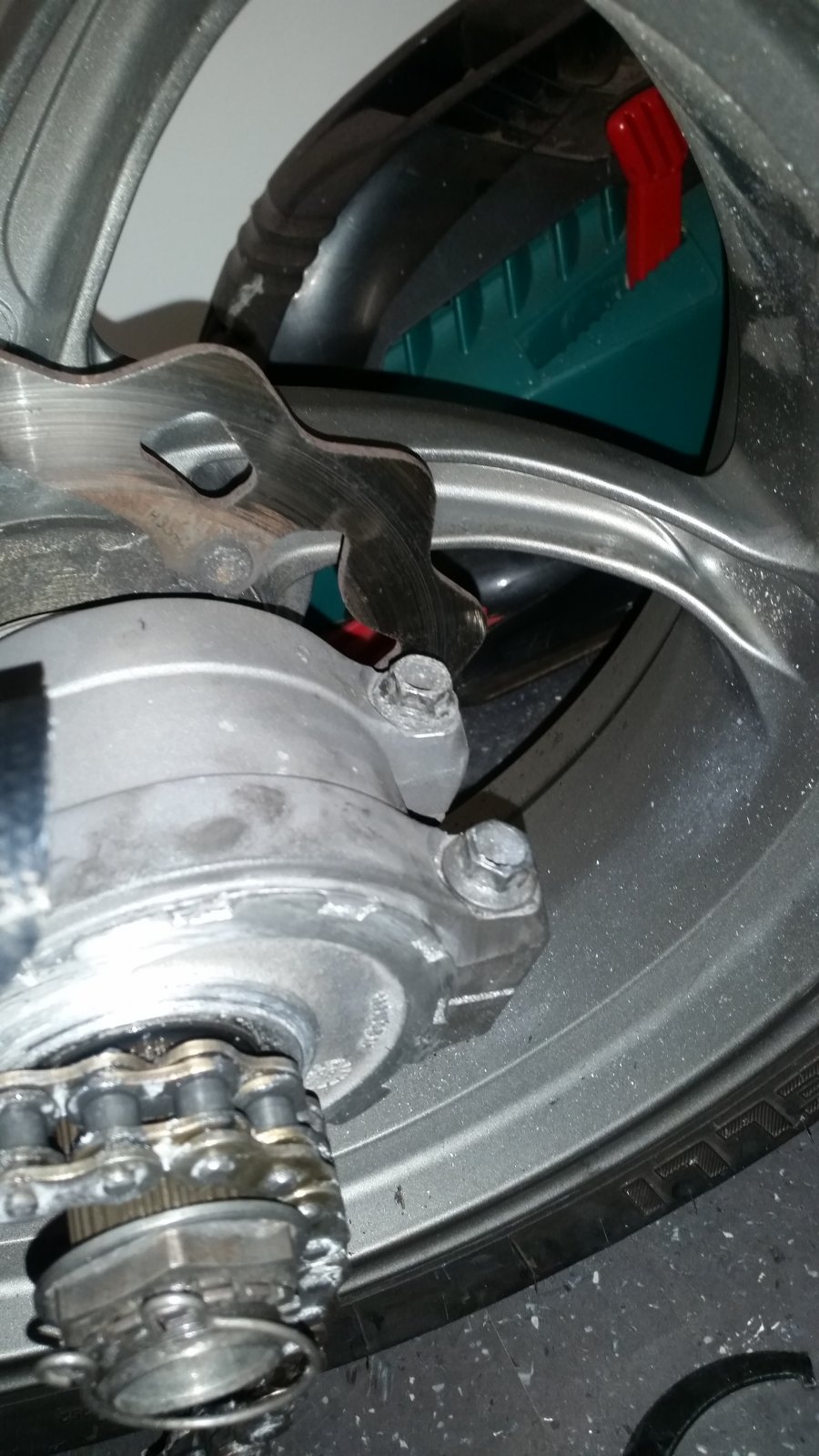

  1. Why is the excentric in the wrong position? Tensioning the chain in time is causing the change in position depending from the lenght of the chain, isn't it?
    Or am I missing someting?
  2. What's the standar chain wheel on a 998 2002 biposto? At the moment there is a 36 on it.
  3. The chain should be adjusted anti clockwise as you look at it.

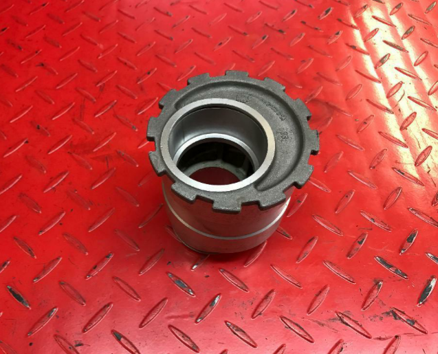

  13. Just come back from a 150 mile blast to find metal shavings on rear wheel. Took it apart to find the same issue. Fairly worn but I can still get adjuster spanner on.
  14. Should be a recall on this imh, Safety issue? Or does Ducati say the cush drives should be changed regularly?
  15. I think you'll find these bikes are probably 12 to 15 years old.
    Steve
  16. Ahh ok makes sense, Take it recalls only come in for a certain amount of years?, Just had a recall done on my 10 plate Kuga, Thats why I brung it up.
    Cheers
  17. And the rest, however there never was a recall even back when they were new and popping cush drives...
