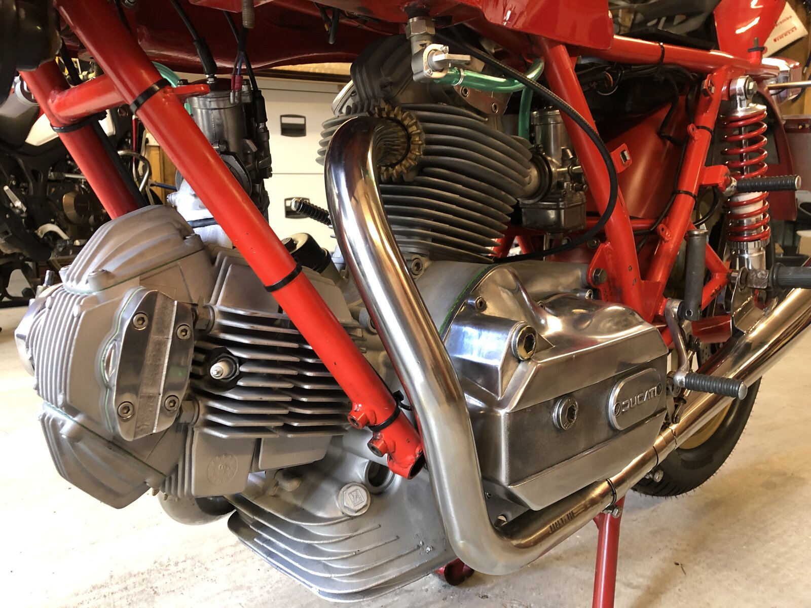

  1. Off to MdM to re-unite chassis with engine and sort out new electronic ignition set up, fluid in the brakes, then back home for seat and fairings.

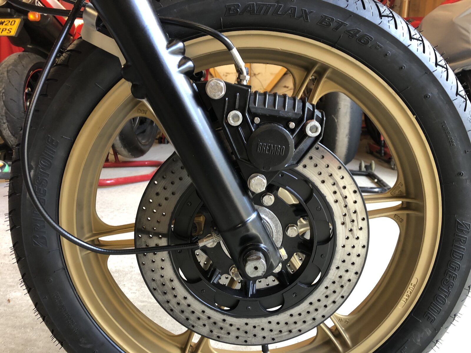

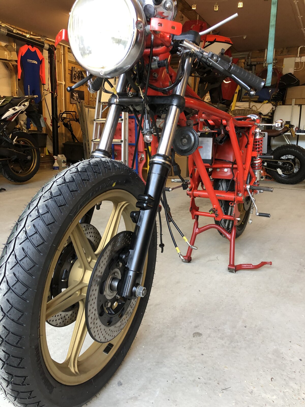

  2. It's all looking really good... but I'd love to know what it up with that front wheel. It's been keeping me up at night thinking about it :)

    Talking of dimensions, I am amazed at the wheelbase of this era bikes. Must be 20 cms longer that my 748 and I guess all from the steering head angle.
  6. And I've just looked in Ian Fallon's bevel twin book and evidently the 16 tooth allowed the chain to wear away the engine case instead of the swingarm... ho hum.
    The steering head angle was primarily driven by the position of the front pot... any steeper and the wheel/mudguard could well have hit the cylinder head!! It does make for a stable ride mind and it's still going to be reasonably nimble with thin(ner) tyres - the rear on the Darmah is the same width (120) as the front on the V Raptor.

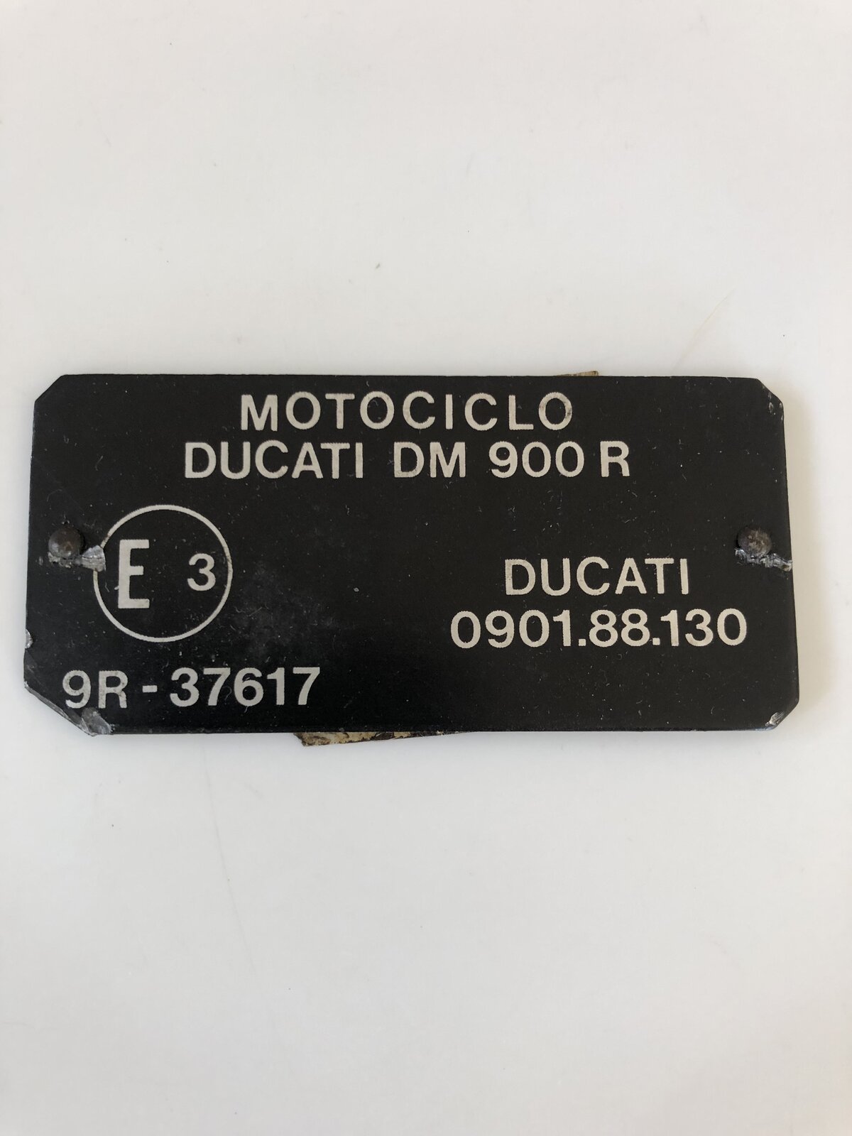

  11. Anyone know where this goes and how it is attached?
  12. Is it the "Homologation Plate" referred to in Falloons Book? If so, there is a similar plaque below the battery cover panel on the RHS of the bike showed in the first image of my post: #57 . They are rivetted in position. But mine was an 84 model, and Falloon acknowledges it was changed for that year.

  13. Thanks Tom, Here is a comparative shot of my frame below battery box and I don't see much evidence of riveting, but I will take a closer look when I collect her with the engine installed.
  14. Just found this on Car & Classic, 1982, which is very similar to mine.
    Thanks for the info.
  15. The image from car and classic seems to show a plate in a similar position to mine.
    If you save the image and then magnify it, the black plate looks very like a homologation plate, although with poor resolution .
    Also, if you are hesitant about drilling and riveting, you could consider using strong double sided tape which I have some success with.
    Tom.

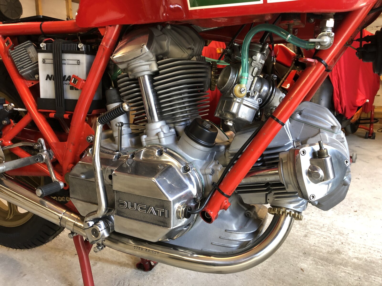

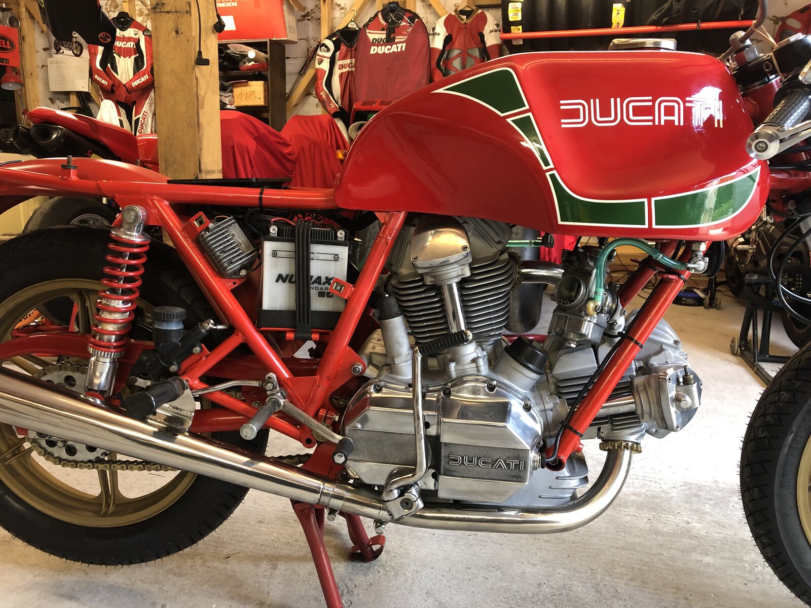

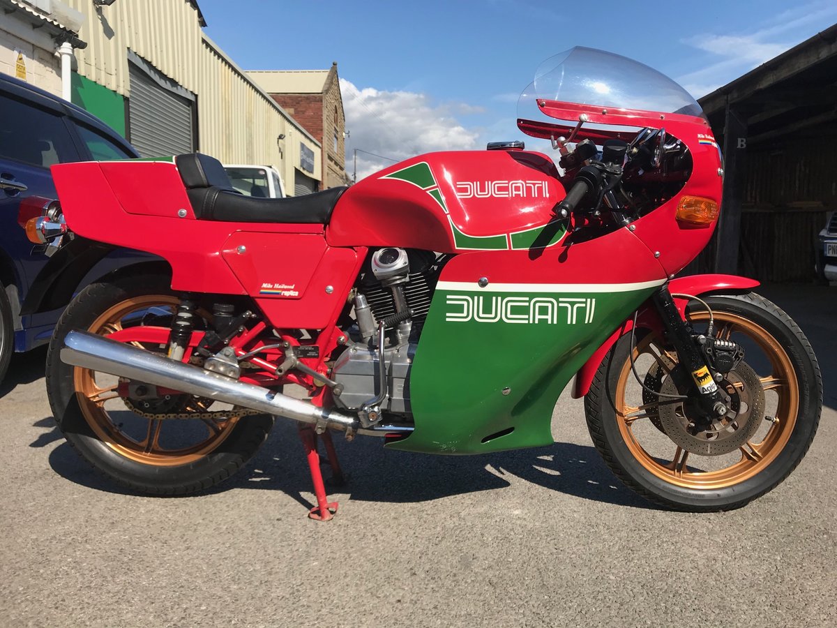

  16. She is back from Moto di Marino with a clean engine, new electronics, fluids, fuel taps and lines, tyres, brake lines and refurbed carbs.
    Need to find the right, bellmouths, coils & HT leads and put the fibre glass back on.

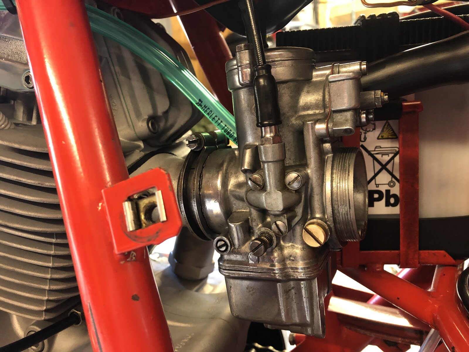

  17. Love this build. Just one question though. What are the black marks on the swing arm and frame?
  18. 40 years of dirt that was all over the engine and carbs.
  19. That’s absolutely stunning ! :cool::cool:
