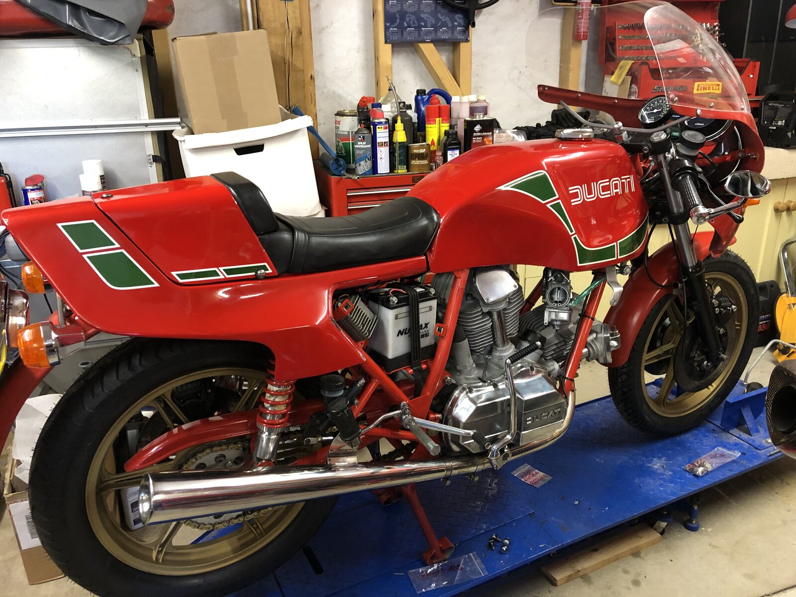

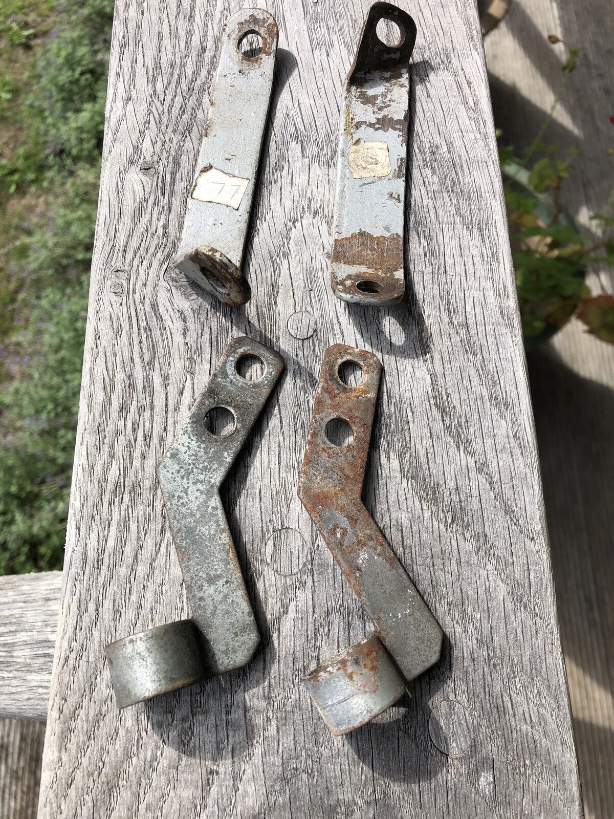

  1. Got some of the fibre glass back on, front fender bolts and fairing stays. Remembered I sent those brackets away for re-galvanising weeks ago, so better chase them up.

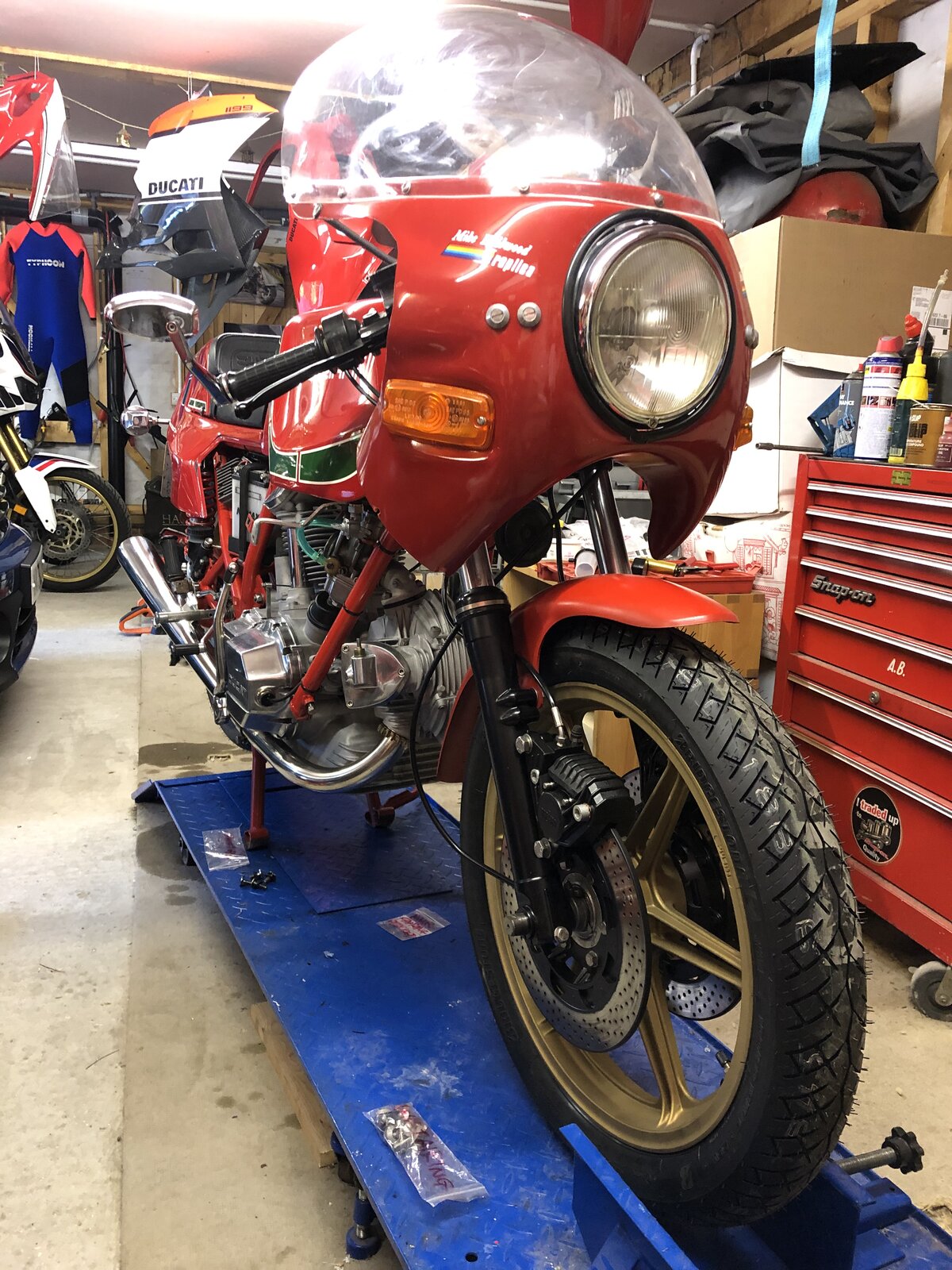

  3. So did you figure out what the issue with the front wheel not fitting was then?
    Are you going to be running it air filter less then?
  4. Not a conclusive explanation, probably my lack of talent with spanners, but the spindle is now tight and the discs spin cleanly. The speedo drive is broken, so new drive and spacers.

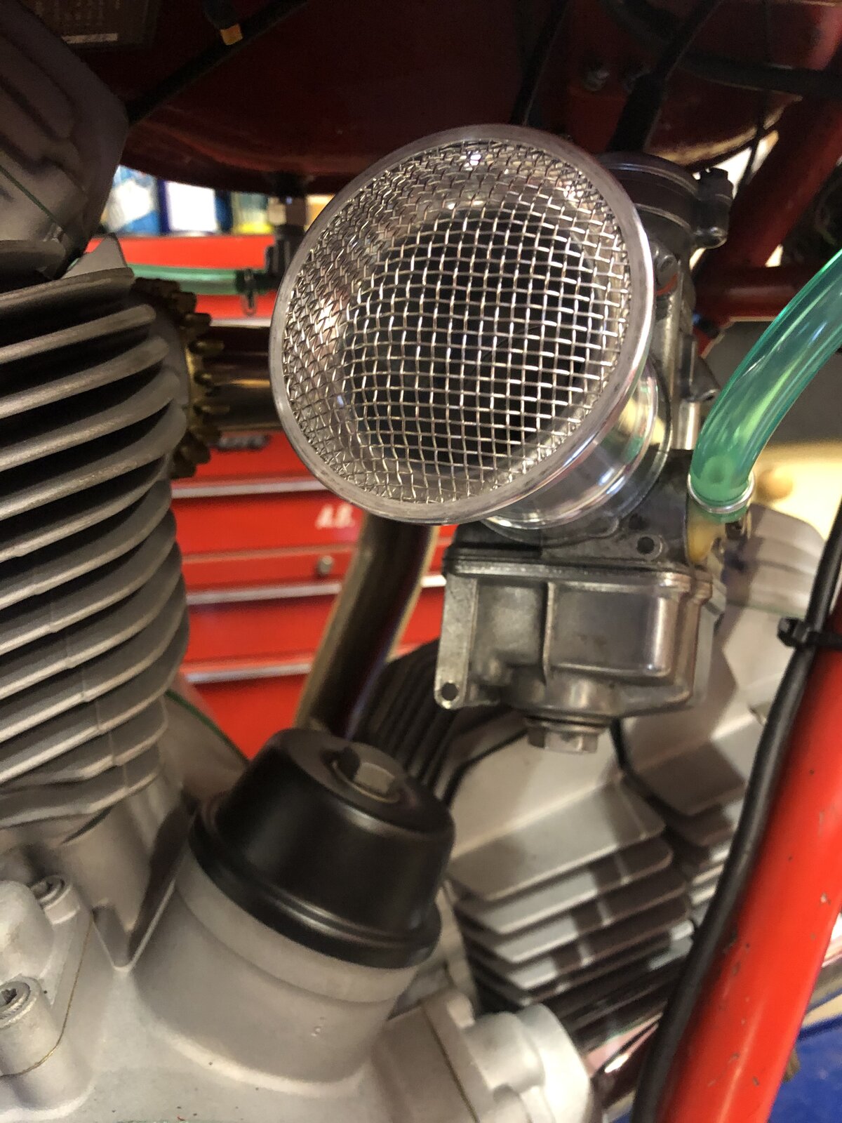

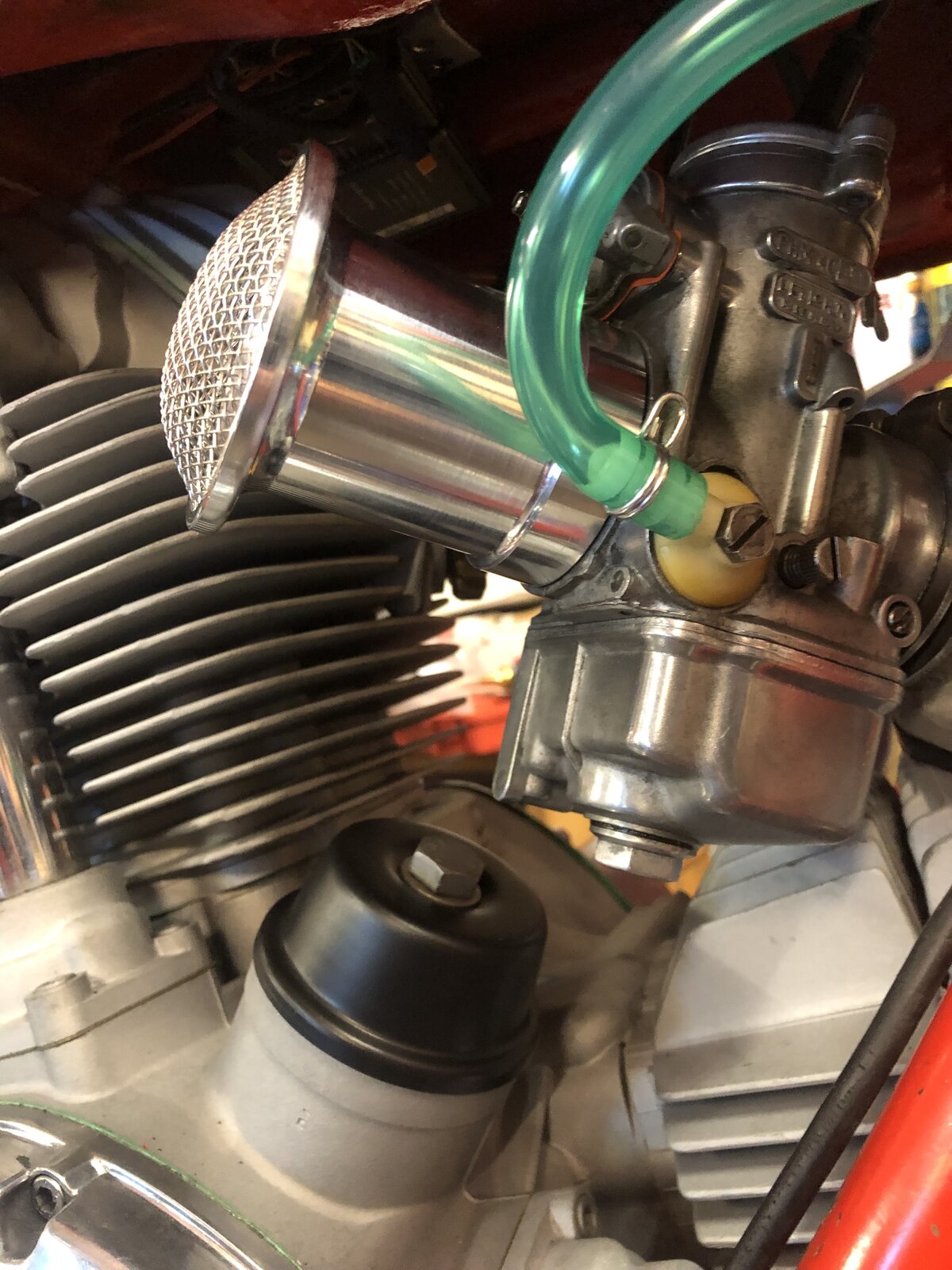

    I like that open carb look, but have the ugly air filters in reserve.
  5. I have heard some people who do run them without a filter spray/clean/wipe out the carb after every ride i.e. the slide, needle & inlet :astonished:
  6. Ran mine as my only form of transport for 4 years, and never cleaned them out. Used to have to drain the front bowl of water during winter when snow got in the carb and melted
  7. I've owned my (now seriously tuned) '79 900SS from new, covering well over 135,000 miles and I've never used air filters.
    We don't live in a dusty enough climate to actually need them IMO.
    I've rode over the Alps, under the Alps, down to the Med', Holland, Belgium, Luxembourg, Germany, Italy, France and Spain many, many times on the old nail...
    ...and still don't feel the need to strangle the performance by saddling the old girl with air filers, or spray them or clean them out after every time I use the bike.
    For the last 25 years I've run her with smooth bore 41mm rubber mounter Dellorto race carbs.
    Steve R

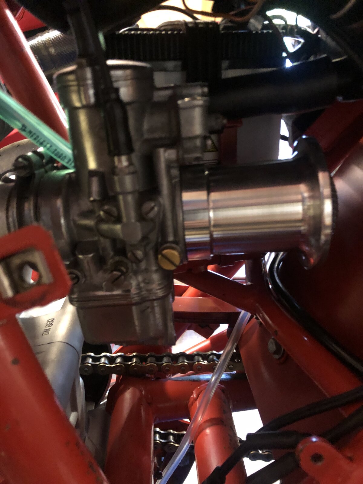

  11. Just ordered new bellmouths, rev counter cable and sump filter, but really struggling to find the speedo drive unit and cable. Any thoughts?

  14. Bell mouths are on and rev counter cable will be later.
