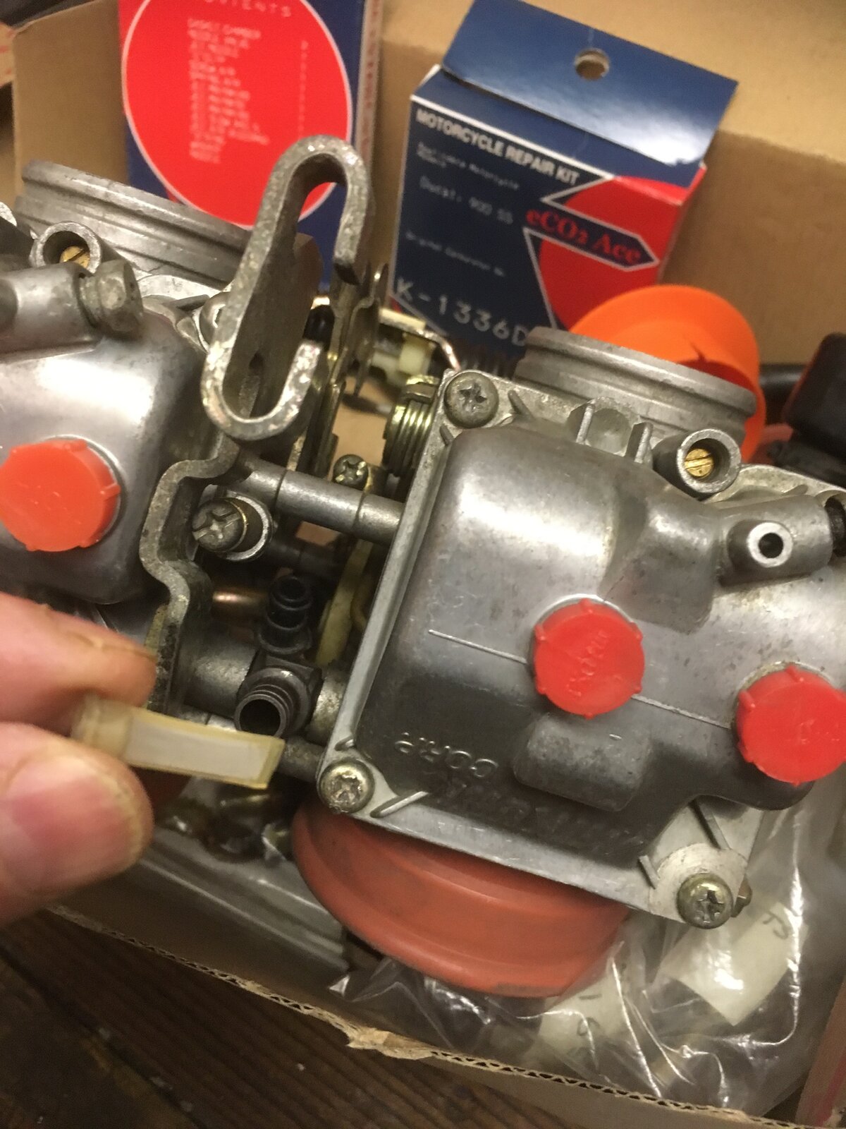

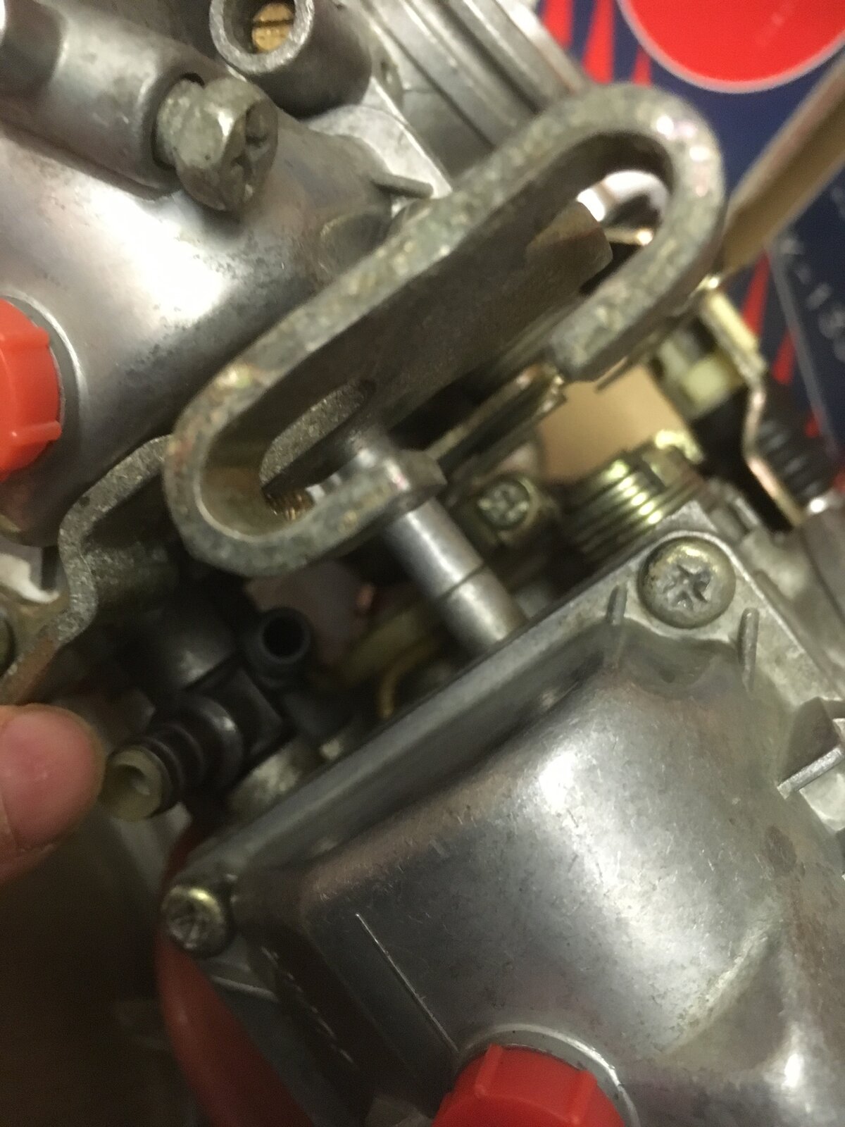

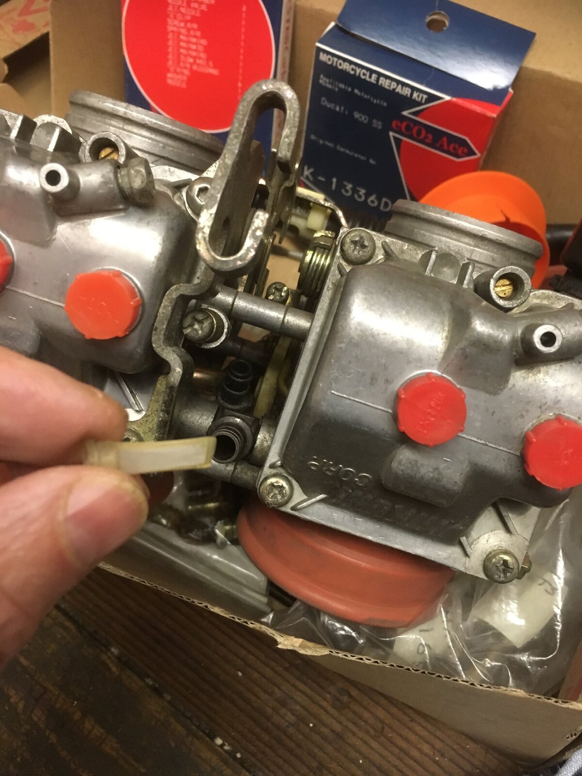

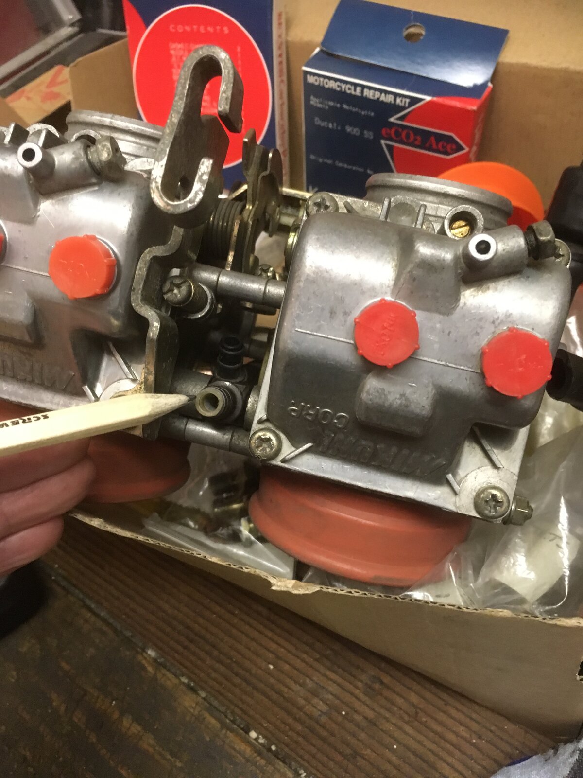

    There’s a couple of really small filters fitted on the fuel lines, one in the original Y piece joint and one at the carb fuel inlet
    Probably a good idea to check if their clogged up or better still remove them and try again
