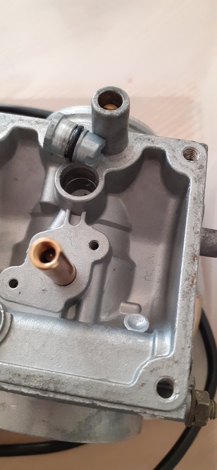

    Just been watching a "Brad the bike boy" video (in my tea break) and found an o-ring I did not know existed.
    He said it was a 8 i.d. x 1.5 sec (I think it's 7.5 i.d. - but who am I, plenty on ebay)
    EDIT: And there is a 10 i.d x 1.5 sec under slide guide - which he said was not available from Ducati
    If you get some plier and grab it side on (i.e. pliers 90 degree to hole axis) get a good grip and rotate and wiggle & lift it comes out ok. I did pliers nose first on od and it slipped off and burred the plug. No great drama but does not look good.
    Cheers Gaz
