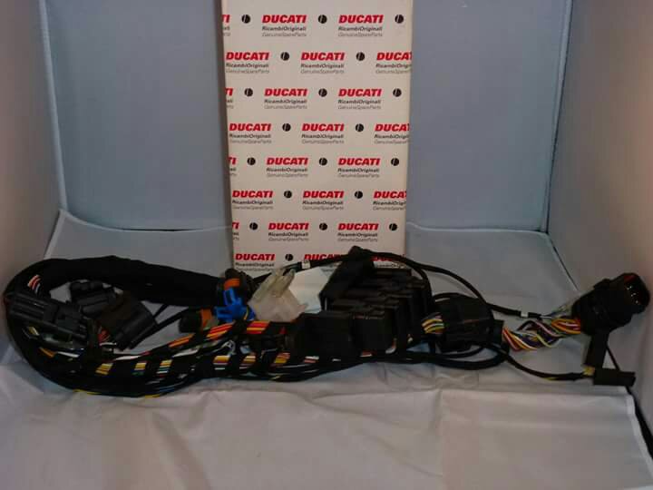

  7. I'd get a second hand loom and fit that. You'll probably save money and have a more reliable bike in the long run rather than have your mechanic repair any more wires. As ChrisKing1 rightly points out water wicking along the wires could lead to more corrosion in the harness. Given where the ECU is and the environment the wiring lives in, even if your mech did a good job in insulating the wires properly, the damage could already be done. I've attached a short article which shows how easily water can travel along stranded wire via capillary attraction alone.
    Loom on flea bay LOOK GENUINE DUCATI 749 DARK 2006 WIRING HARNESS LOOM *FREE UK POST* | eBay

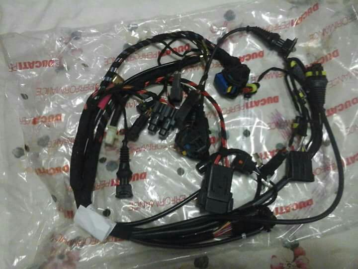

  8. I dropped off a brand new loom to the mech today so fingers crossed that sorts it.

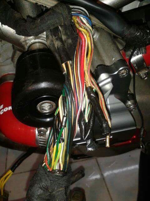

  10. Hopefully this will resolve the problem for good and future proof the electrics. Some pictures of the carnage would be interesting to see
  11. Aside from a few repairs the old loom 'looks' ok for a ten year old piece. There are a few pieces of factory tape that have started to show age and that's pretty much it. I can only assume at this stage that something is going on inside that we cannot see.

  14. One of the reasons I went with a new OEM main harness
  15. My harness had been modified for something at one stage in its life. When I saw the photos, I told the mechanic to forget it and wait for the new one.
  16. I would say butchered, if a "professional" did that they need to be struck off.
  17. Yeah, I couldn't believe it when my mechanic showed it to me. No way was I going to make him try and sort this crap out. He was very happy to see these show up at his workshop
