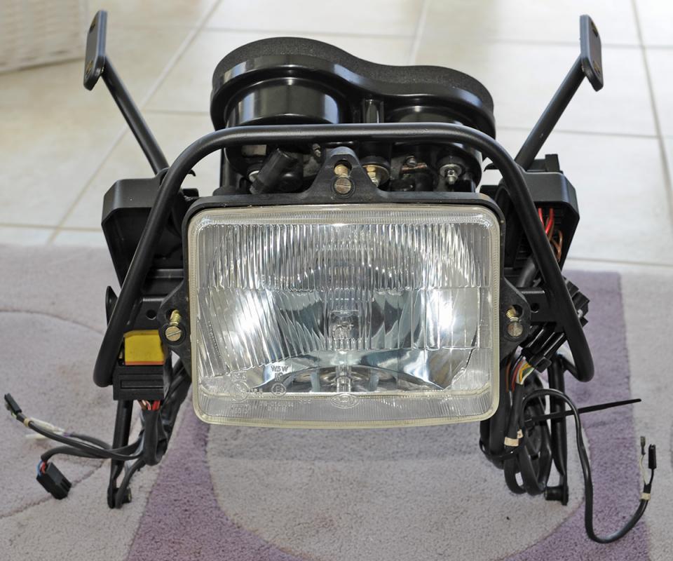

  1. Finished the Speedo and Headlight unit today , another bit ticked off :) Speedo.jpg
  3. Mine could do with the same attention after the 40,000 miles on the clock, wish I had time and money to do it. Keep up the good work :)

    The bracket was shotbalsted, then grey primer and then Simoniz Tough Black which gives a satin finish, I used the same paint for the clock surrounds.
    I wont be bothering with the wiring fix as I've binned my Duke Regulator / Rectifier and will be using a RR51 which uses a differnt wiring configuration, I have checked all terminal throughout the look and all look ok .
  7. Yes its a nice satin finish.
