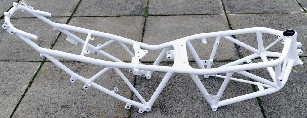

  1. Frame picked up from Redditch Shotblasting Co Ltd Today , Dave there has done a super job , right colour white as well ! If anyone needs shotblasting / powder coating then I can recommend this company, they are all bikers which helps.

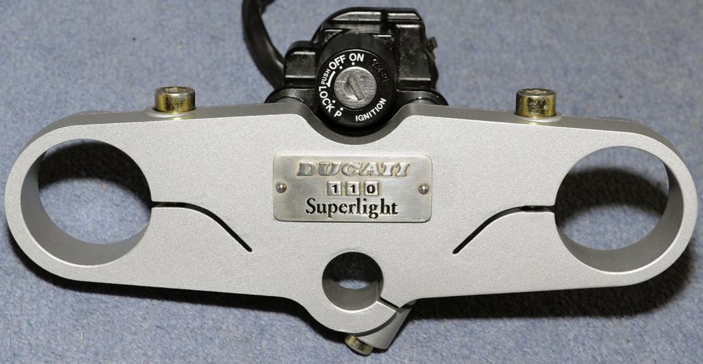

  2. Top yokes are now restored , lightly vapour blasted , laquered and , Black numerals and letters painted . I am pleased with the way it looks Top Yoke.jpg

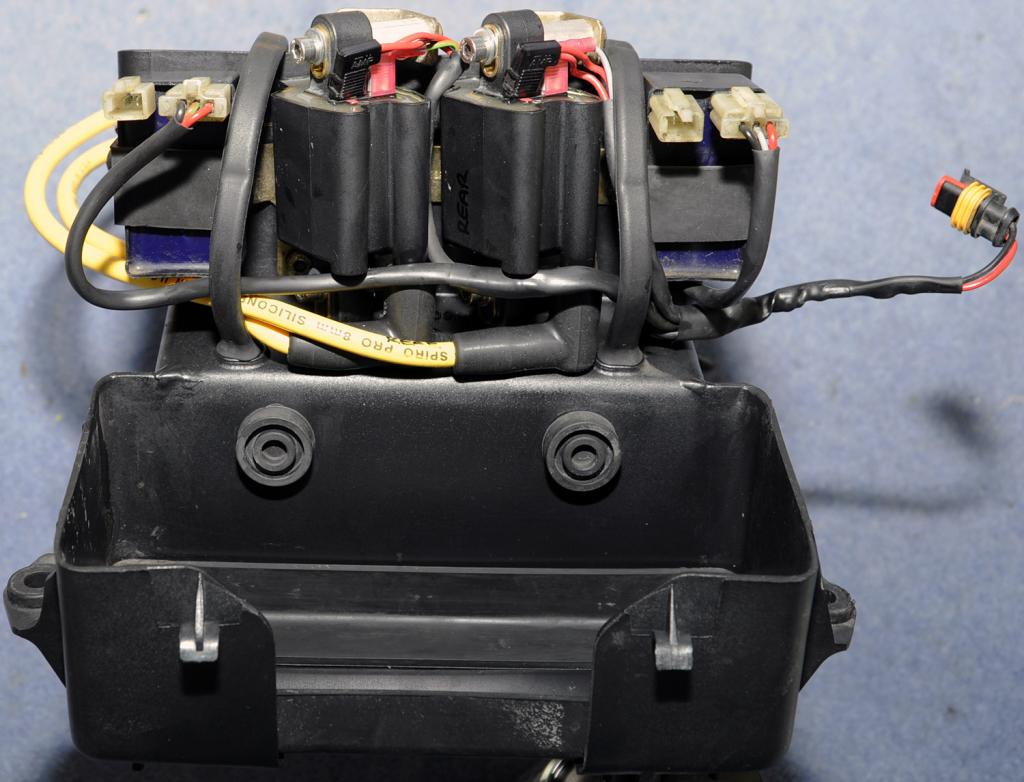

  3. Simons Mk1 #110 Restoration. Dyna Mini coils now added with Taylor Ht Leads, these fit using the std mounting brackets, just need slightly longer bolts. Tidy job me thinks. Dyna Coils 72dpi.jpg

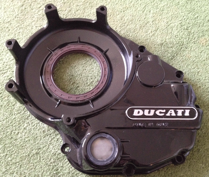

  4. your restoration inspired me to do a job I have wanted to do for a while.. corse style clutch housing... really pleased with it all, Thanks to Mr. R for the excellent machining job, I have made it gloss as I am one
    for the bling :smile:
  5. Thats a nice job, well done to the machinist .
  6. Hi,
    I'm thinking of making my 95 900ss look like the 91/92 models, white frame and wheels, that years 900 colour scheme just looks really good to me. Anyway, what is the right white colour please? Is is more of satin white, not full on gloss or matt white.
    Thanks
    Rich
  7. Mines a White with a bluish tinge , powder coated so shiny .
  8. Thanks!
