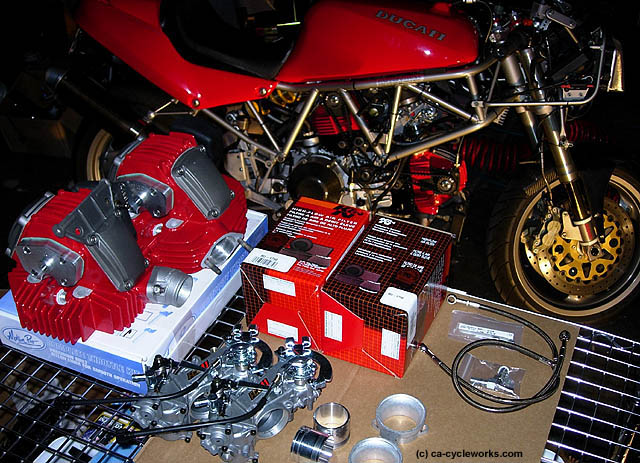

  12. Genius! I already have a 848 oil cooler!
    Any pics of this done to a bike?
  13. [​IMG]
    Best i can find but you can see the banjo bolts fitted to the cam caps
  14. So - I would need a longer union for the oil cooler feed allowing an extra 14mm banjo fitting into the oil feeds?
    The oil feeds into the cam ends and exits as normal?
  15. You will need a 916 996 st4 748 888 oil cooler,, it has a extra banjo for the oil feeds.
    Yes drains from heads back into sump.
    I did the grub screw mod on my ST2 bottom end to fit the 916 top end on my 851
  16. Warning if you run them directly to cam covers you will send more oil to head then it can later remove back to engine. Guess what will happen then? To have extra oil lines going to heads you need to open the spare oil gallery in head, cylinder and bottom end.
